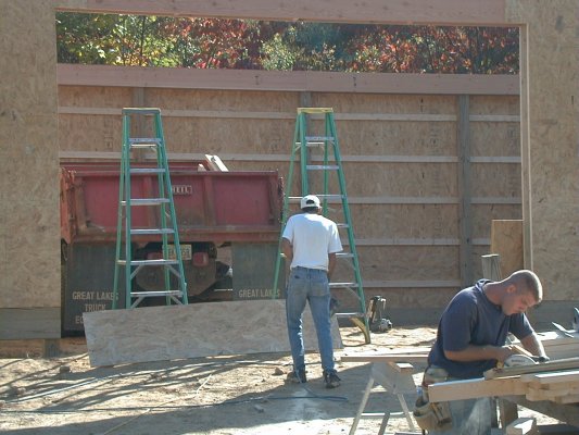

Are your OSB sheets nailed directly to the posts?
If so, did the wall end up relatively flat on the outside?
If so, where did the header board (which the trusses rest on) on the outside end up. Seems like without perlins, the header board would stick out beyond the OSB. Did it, and if so, did you just box it in such that is was above the soffits? Other pictures of some of this detail would be helpful, if you have any.

When they built our pole barn they used horizontal wall girts and OSB on the exterior before they attached the siding. We then stacked 2X4s on end to the original girts on the inside to get the depth of the insulation that we wanted for our work area (5-1/2"). The OSB on the outside is fastened with nails, the OSB on the inside is fastened with deck screws. The inside skin can be removed and reinstalled very easily and takes a lot of abuse without actually showing it.

One more picture

Ah ha, now I see - typical pole barn construction. In your previous pic, the inside 2x4s were so well lined up with the perlins/girts, that I didn't notice them. Now it's all clear, but I still wonder about my idea of directly nailing the OSB to the poles, and then studding out the inside, like a normal wall.
