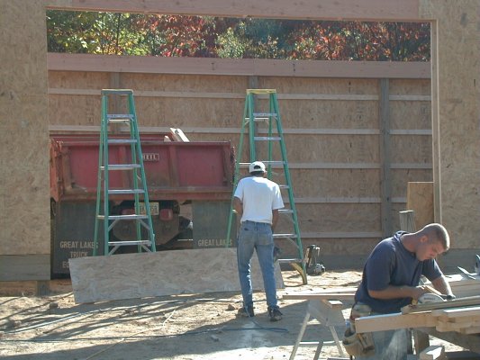

- OSB ran horizontally, with the only support initially being the posts.
- Before vinyl installation, place 2x6 framing inside, except rather than how you did, run it like a stick-built wall, vertically.
- accomodate windows in the 2x6 framing and then cut OSB to coincide.
- vinyl side last
)</font>
I think that would be an extermely flexable, weak side-wall. What will you be anchoring the vertical studs too? Will you be putting something across the top & bottom at least?
Wind load would rip it to shreds around 'here' without any horizontal beams.
As to the last question above mine - same thing, pole buildings are designed with strong vertical columns, and you need to cross-brace with some sort of stiffeners horizontally. It is just a fact of building, if you choose pole building, you need to stiffen horizontally.

</font><font color="blue" class="small">( Beautiful job Mike. Now some more questions. Would you see any problems with:
- 4 x 6 poles placed 8' on center
- no perlins
- vinyl side last
I realize the siding installation over the OSB installed in this manner may leave a less than flat wall since the posts become the joining points and nothing really spans them except for the siding. However, there is some siding nowadays that has a fiberglass rod directly adjacent to the nailing flange so something like that, coupled with loose nailing, might result in a fairly flat wall. What do you think? )</font>
1* 4 x 6 poles placed 8' on center
2*- no perlins
3*- OSB ran horizontally, with the only support initially being the posts.
4*- Before vinyl installation, place 2x6 framing inside, except rather than how you did, run it like a stick-built wall, vertically.
djradz
1*That' how I did mine.
2*Wouldn't recommend that cause an 8 foot span of the OSB is 2 flexible and it would weaken the strength of the buildings framing..
3*I ran the osb horizontally on my building so as to match it up with the purloins.
8 feet is two long a span for the OSB That's why the purloins are a must to strengthen the buildings frame and to stiffen up the osb.
4*This wouldn't do anything except proved a place for the 2x6 to hang on to so it can swing back and forth on the OSB as the sheathing moves in and out.
Why use a 2*6 when all you are trying to do is hide or cover the nails piercing through the osb.
A 2 3 or 4 inch I inch thick board or a 2*2 or 2x4 is more than adequate to hide and cover the nails.
My land the nails for the Vinyl Siding aren't any where near 6 inches long.

srs; No, not completely. It's possible to do as you say. But, the OSB nailed to the girts and and skirt board on the exterior are used for what is called wind bracing. In place of OSB when using metal siding you should run "diagonal" bracing at each corner. This will keep the building from racking. You should also run "diagonal" bracing on the top of the bottom chord on your trusses also. You can't believe how this strengthens a building. /forums/images/graemlins/grin.gif

I think I figured out a way to nail the vinyl siding to a pole building without any nails sticking out.
1*Run the osb horizontally and nail it to the Purloins using nails that aren't long enough go clear thought the OSB and the purloins
2*From the inside place either a 2x2 or a 2x4 vertically between each of the purloins from the top to the bottom of the wall. Do this every 24' on center from one end of the wall to the other.
3**Next mark the 24'' centers on the outside of the OSB.
4*Now nail the siding on at the marked 24 inch centers again bring sure the nails are shorter than the combined thickness of the osb and the 2 bys.
The nails used to attach the osb to the purloins should work for this as well.
Some side notes
You could go 16 inch centers rather than 24' centers.
The vertical 2 bys don't have to be permanently attached to the purloins as the siding nails will permanently attach them to the OSB.
Just toe nail them into the purloins on each end leaving the nail heads out far enough so that you can easily pull them after the siding is installed.
Another take on this would be to use a 2x4 notched out from top to bottom for the purloins then nail it through the notches into the purloins.
Again place these 24 or 16 inches on center your option.
The purpose of the 2 bys is to serve as covers or caps over the nail points not as part of the structural framing of the building. That has been taken care of by the post and the purloins.
Wish I would have done something like this on my building.
It's already built with all those hundreds of nails sticking out. Now I have to deal with the problem of how to fix the mess.
I can see it's a lot easier and better to prevent the problem that it is to fix it.

srs; Mike's [pineridge] barn photo appears to be before he finished the interior. I thought he said he was going to or did line the interior with OSB.
With vinyl you need something to attache it to on the exterior, studs on opposite side of OSB is the preferred way, the roofing nails won't pull out as easily from solid wood.
The way you guys build pole barns in Maryland is the way we build them here too. With a little fore thought like Mike did, you can finish the inside easier. But the method you describe would work also. Whatever one you wish to do would be fine, one is just a little more $ than the other. I think my question would be, why would you want to put metal on the inside? /forums/images/graemlins/confused.gif
