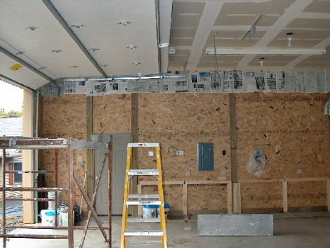

Hey PineRidge, on your 12-5-04 post you attached a photo showing the interior of your building. Do you by any chance have a finished photo of the interior? I'm curious as to what covering you used on the inside. Did you also insulate the interior? Thank you in advance. Stanley
   / vinyl siding for a pole building #40
Re: vinyl siding for a pole building
We were getting ready to blow the ceiling in this picture.
