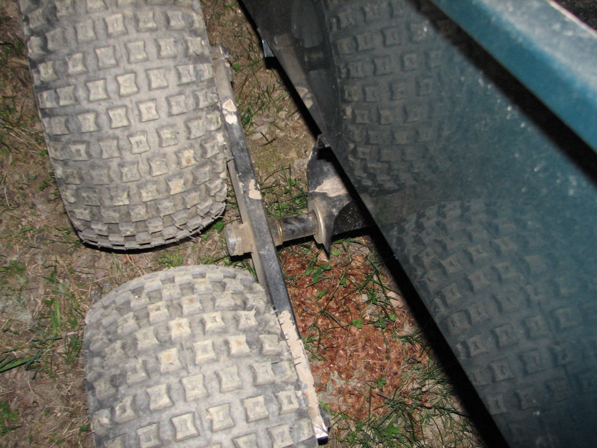

Are you sure you want a walking beam ? Single axle would support a ton also, with similar sized tires, and because you dont need swing travel you can maintain loading height with slightly bigger tires. It will drag less in tight corners.

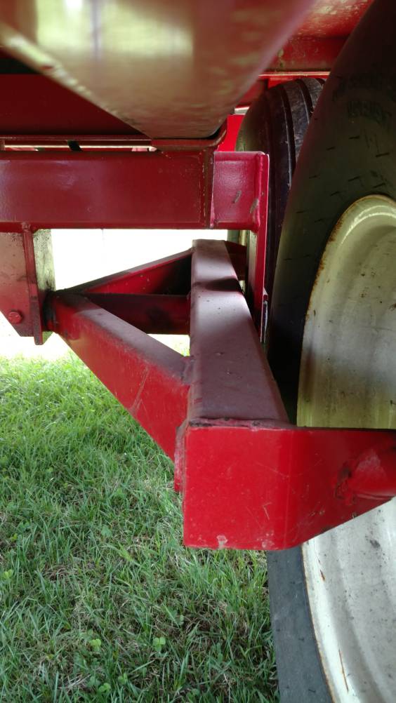

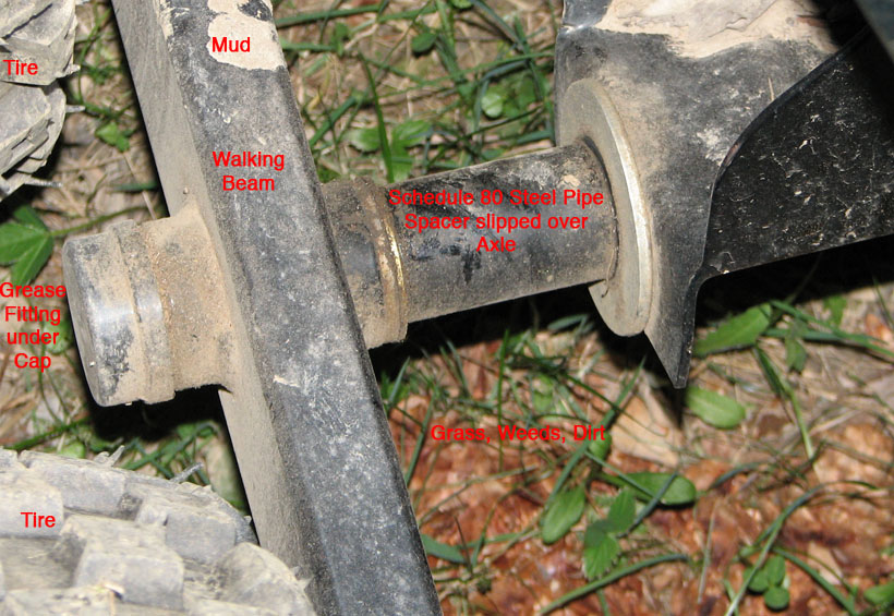

Heres an idea for the walking beam. Mount a regular trailer axle to your frame and use that as the main axle for the walking beam. Gives you good bearings and easy to get parts. Then just figure out how to bolt the walking beam to the trailer tire studs
/ Walking Beam Trailer #38
Use the axle and bearings but instead of a hub, have a piece of tubing machined out on the insides to accept the bearing races and seals.
/ Walking Beam Trailer #39
Or make a plate with the hub and stud spacing. Or cut up and reinforce an old wheel.
