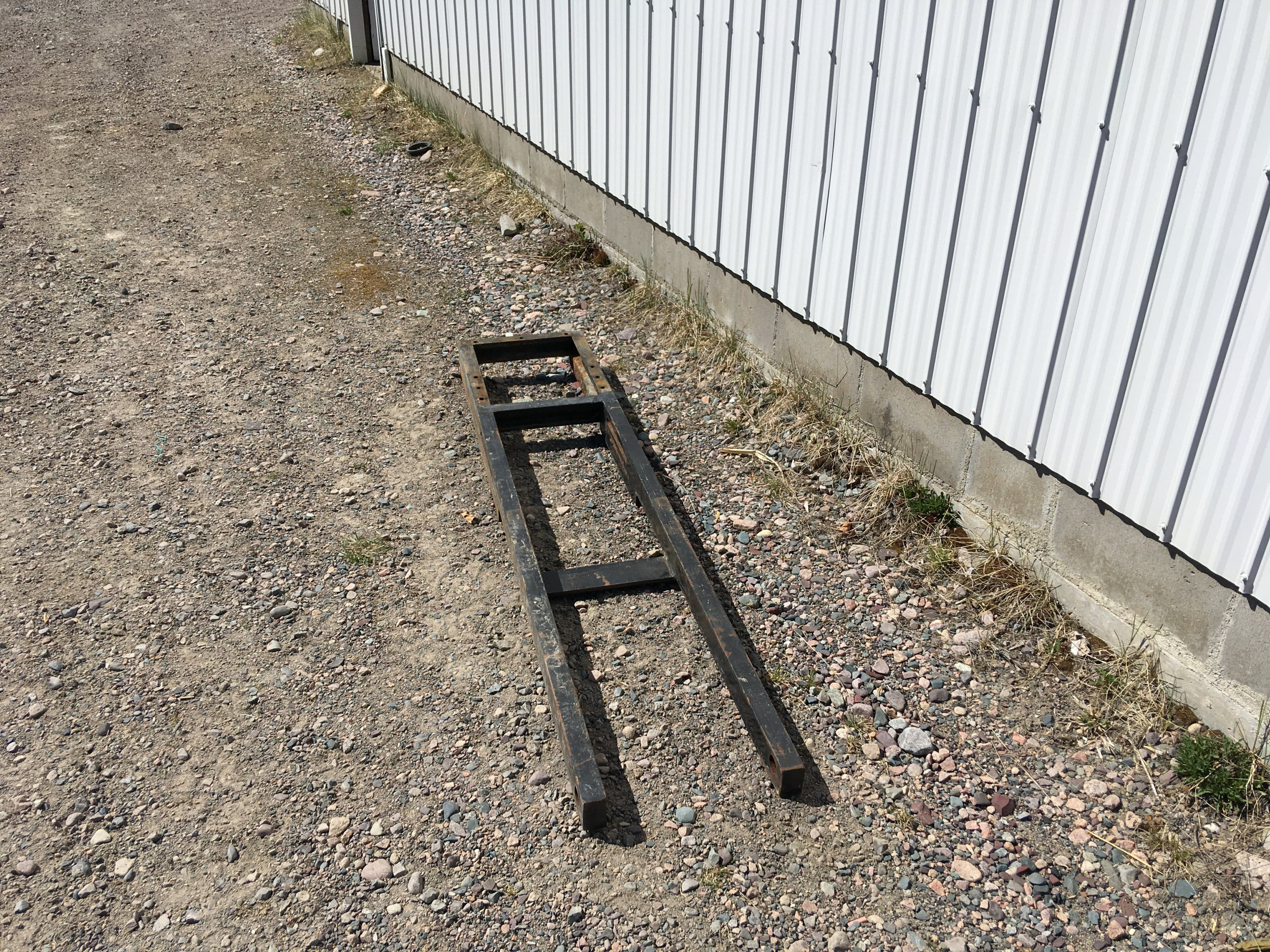

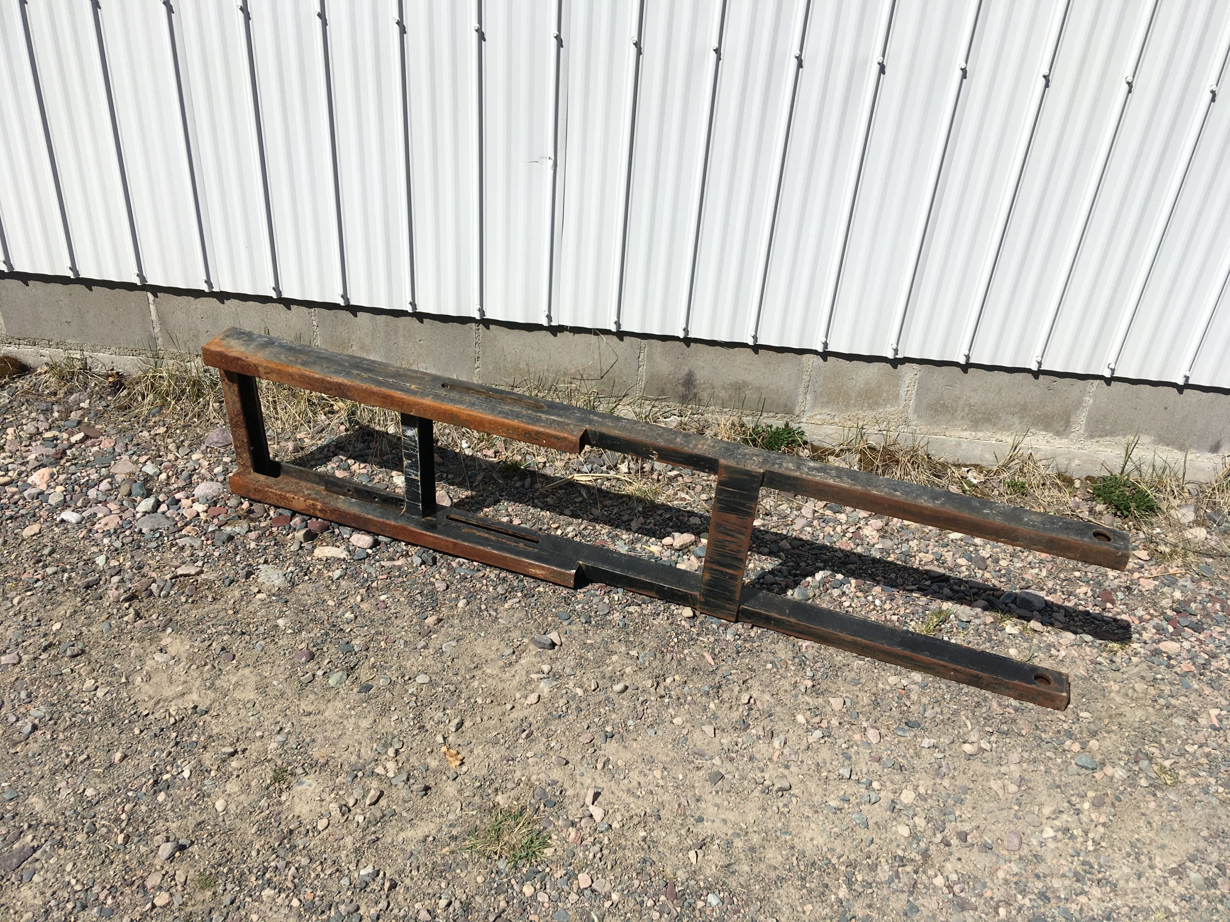

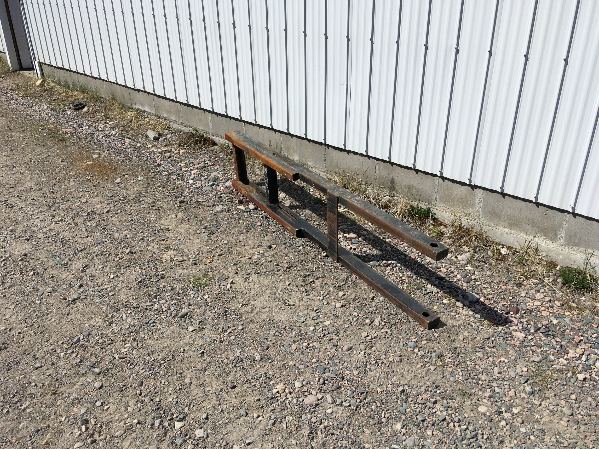

I have a subframe for sale if your still looking for one? Backhoe subframe for mid size tractor. Heavy Duty. Needs a little paint but otherwise in good shape. Originally built for a Jinma backhoe. I'm located in North Eastern Ontario, in a small town called Elk Lake. Asking $125.00 for it.
