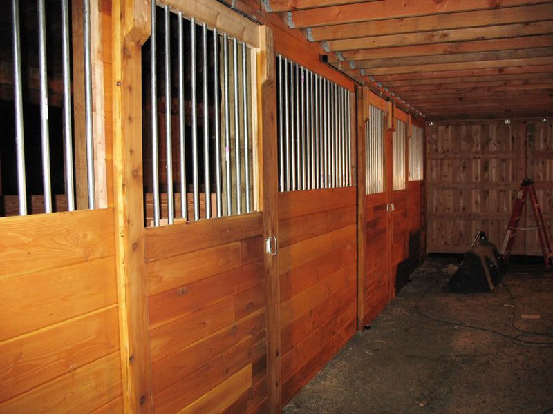

Just a quick update. Finally finished the stall fronts and put a coat of sealer on the "presentation" side. The cedar faced material on the doors looks great, still need to trim out the very top of the door. I'm going to seal all the stall wood before the animals are let in. Also have to get flashing up on all the surfaces they could crib on.
I just used 3/4" conduit installed into the precut groove of the material, with spacers in between to fill the rest of the groove. Yes, they might someday bend a section of conduit, but it's easily replaced and dirt cheap. Prefabbed stall fronts are ridiculous in price and I couldn't find them locally, meaning I'd have a huge shipping bill on top of that.
