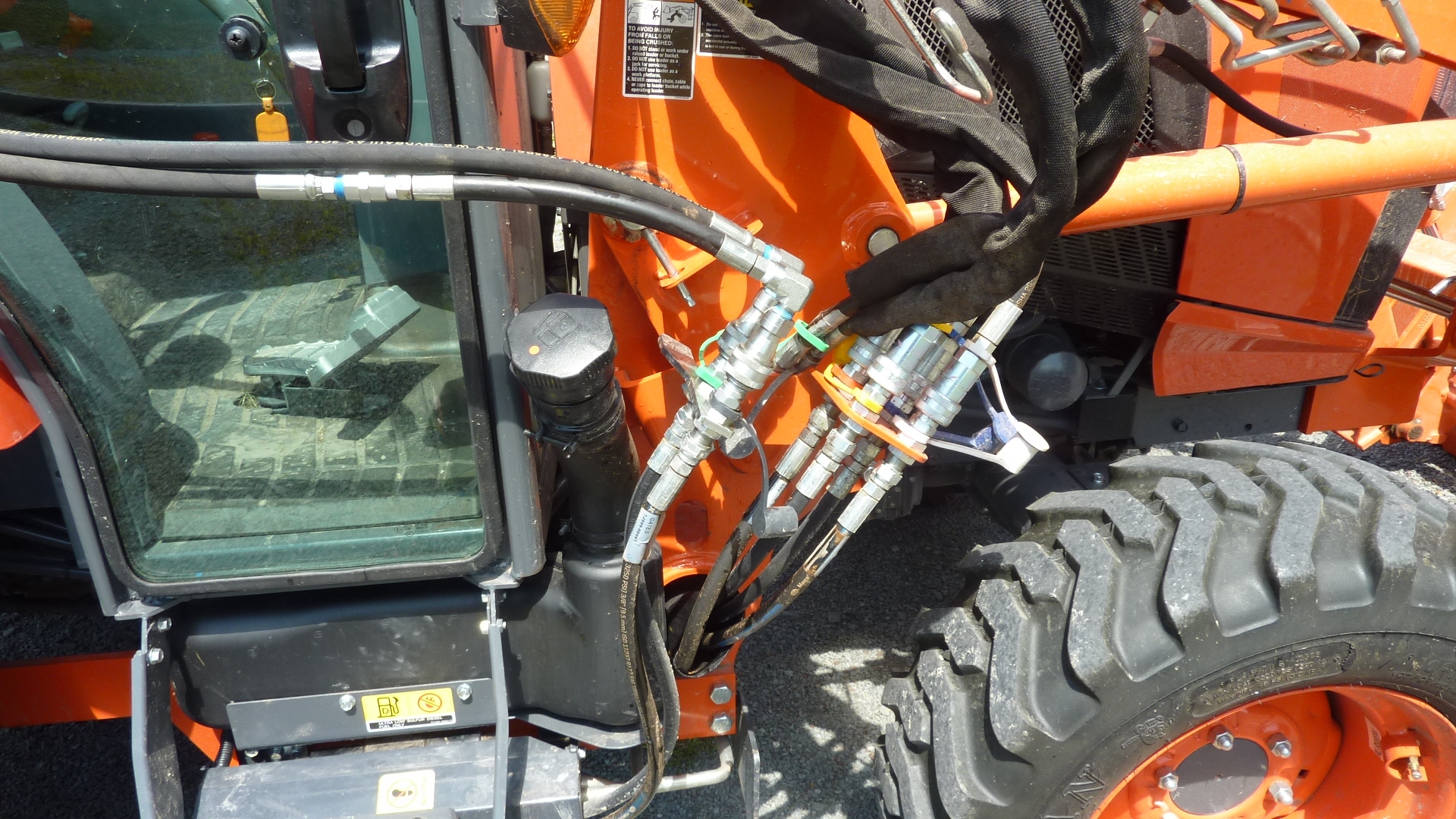

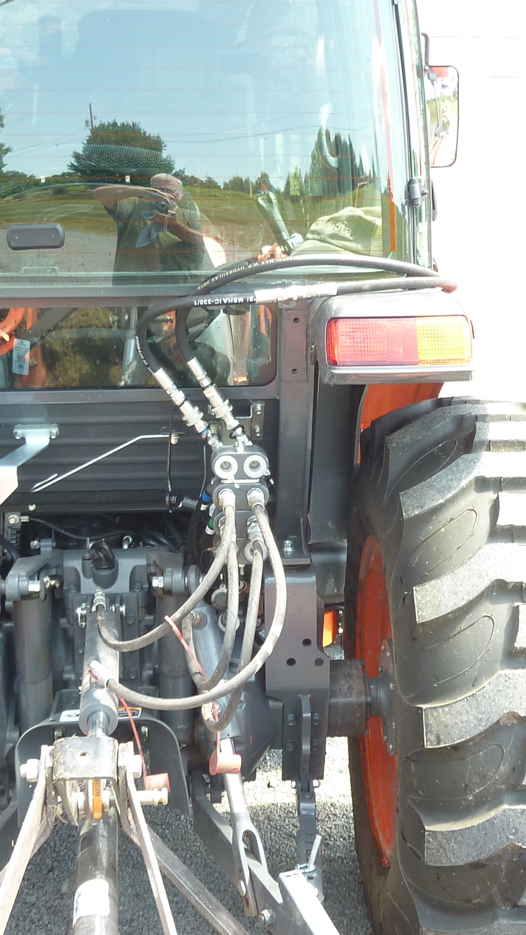

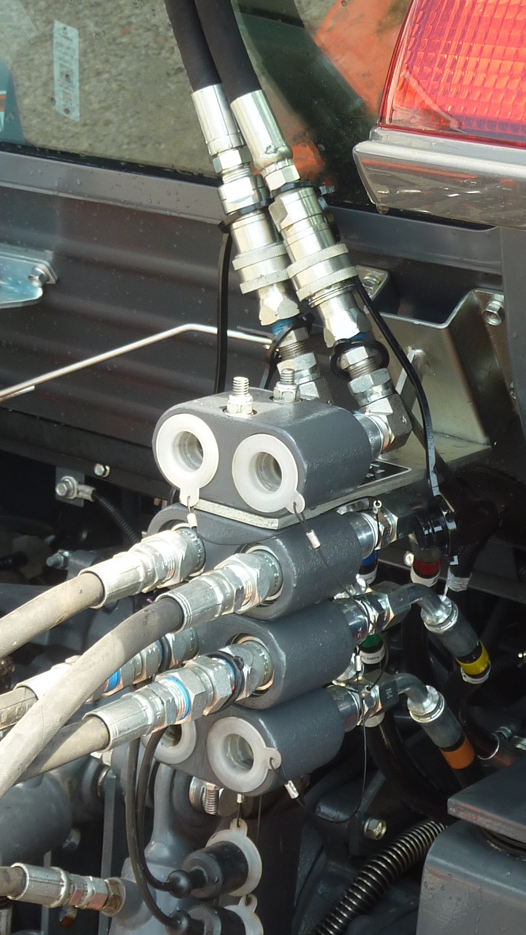

   / Wanting to run grapple hydraulics off rear valve #14

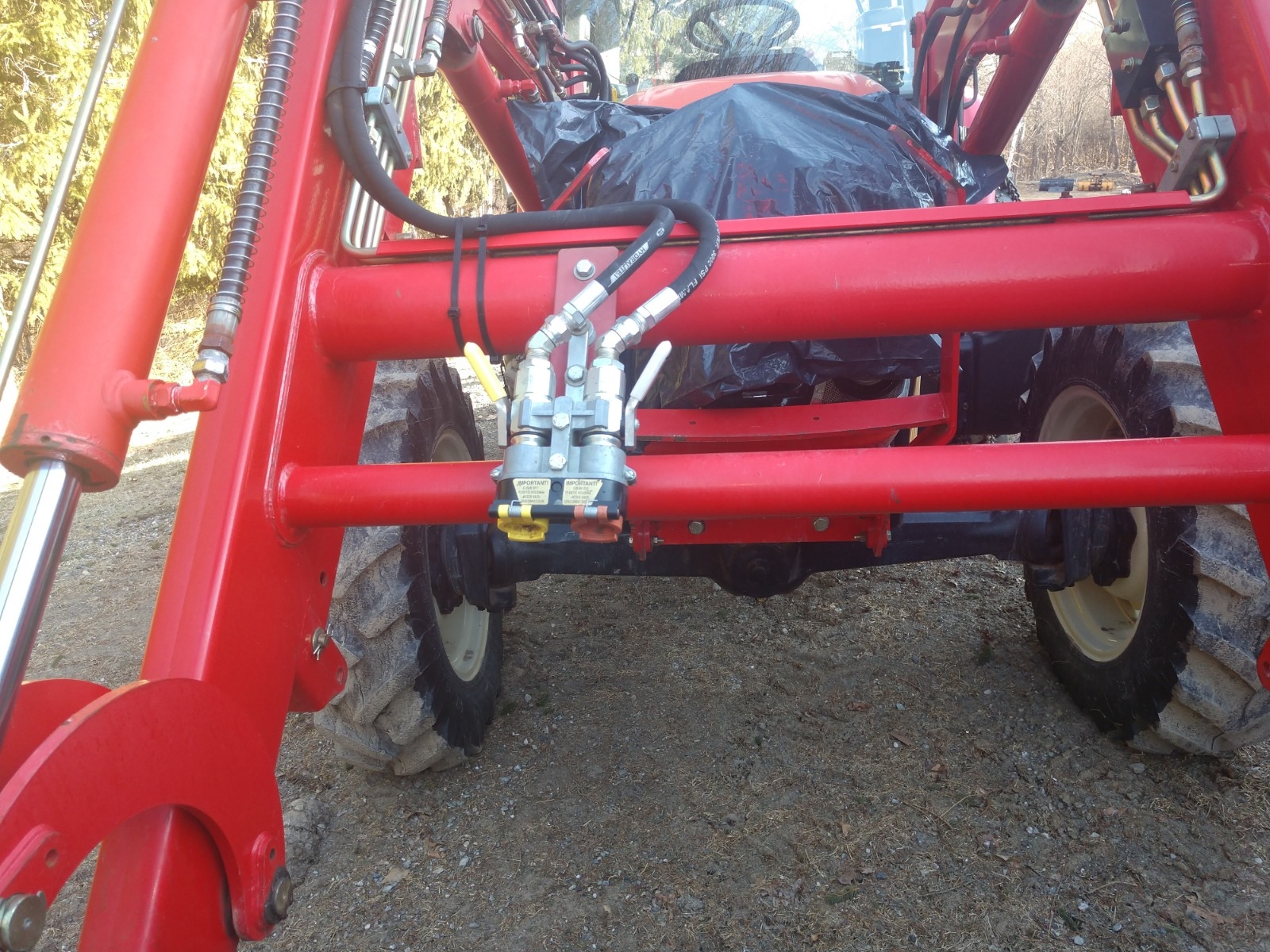

I ran hoses from one of my rear remotes to the front of my loader. I looked at the possible routing and ran a rope the way I wanted the hoses to go. Then measured the rope and ordered the hoses from Surplus Center.
I used elbow fittings at the remotes to keep the hoses in snug to the cab, then under the cab forward to were the loader lines ran from the valve up then followed the loader lines.
then along the loader lines to the front to were I mounted the front quick attaches.
Dollar wise, I spent almost as much as I would have using a diverter valve and tieing into the curl circuit up by the front of the loader +- $100.
View attachment 858215View attachment 858216
View attachment 858218View attachment 858219
Did the same thing so I could angle my snowplow but I added a set of disconnects so I can still dismount the loader if necessary and I leave the hoses on the tractor all the time. Have Pioneer males on the back end to engage my Pioneer females on the back end.
