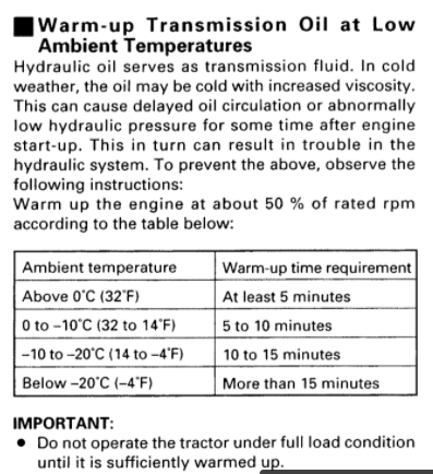

Like most things in most manual, this is as clear as mud. Does this mean let it idle, do not to hard work, what exactly defines warm up?
I think it's pretty clear. Warm for this minimum time and 50% rated rpm and then go to work.
What I don't like is the inconsistency, the times in my book for a different brand are double those.

There are many reasons why it could be double the amount of time. There could be inline coolers, twice the amount of fluid, etc.

Just work it gently, without lugging it. That will warm it up better than sitting idling.

I'm curious how long ago that section of the owners manual was written? Modern oils leave a film that lubricates well even on a "dry" start after the engine's been sitting for months. I suspect that this overly generalized recommendation is mostly to cover the worst case scenario, i.e., engine sitting unused for a year in an unheated barn in Alaska with summer weight oil in the sump (no such thing anymore of course). 5 minutes of idling won't hurt anything, but it's seriously excessive under most conditions. The weight of the oil in the sump and ambient temperature are big factors. The lighter the oil you run and the warmer it is outside, the less warm-up time you need before the engine is fully lubricated. Unless you live somewhere where the temperature doesn't change, one set time won't cover every start.
