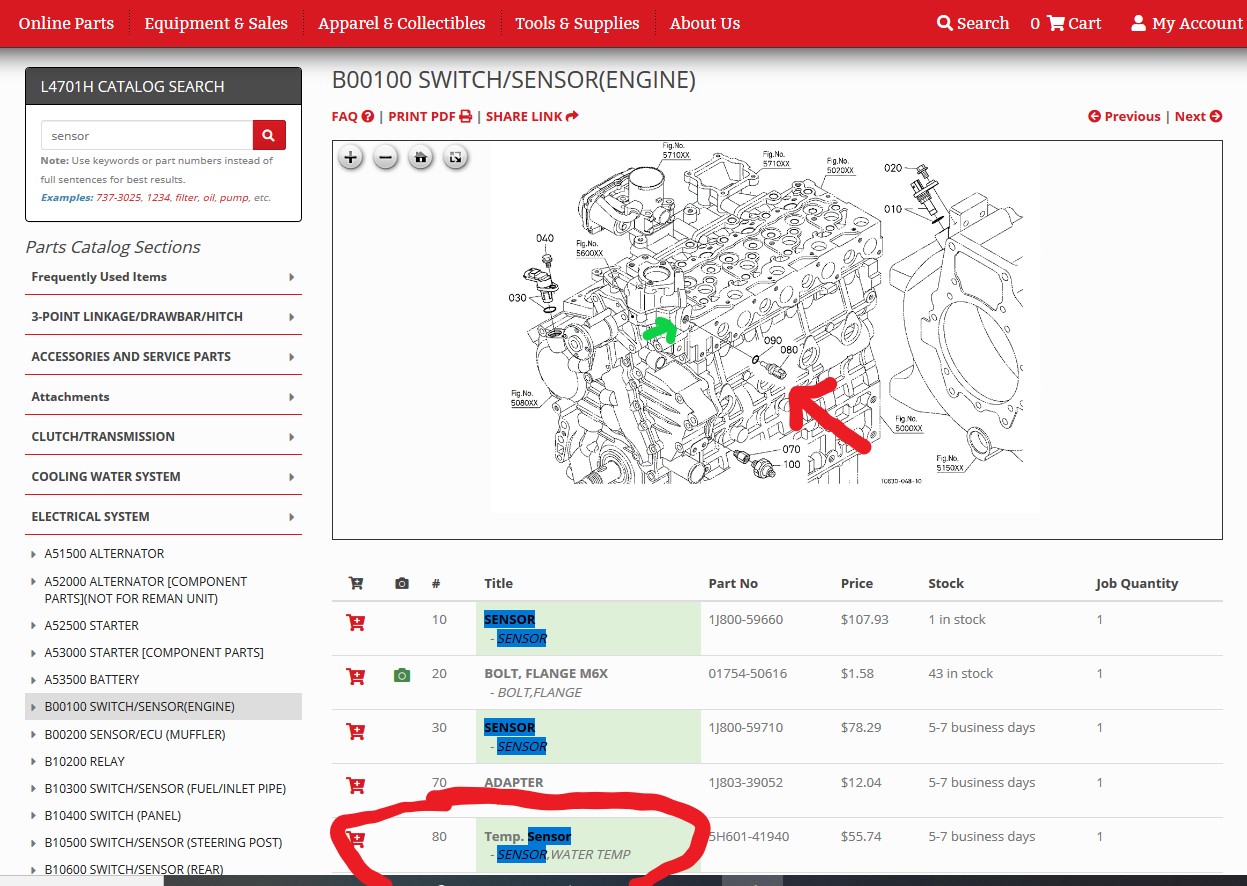

And most coolant temp sending units will not react to hot air.
Not disputing that, but it doesnt make much sense to me. Temp senders are just resistors that vary their resistance based on tempature. It shouldn't matter if it's in liquid or air. Liquid transfers heat way more efficiently so I could see it reading if the temp sender was being cooled by the outside of the engine or something & the hot air couldnt heat it up fast enough. I'd assume there wouldnt be enough cooling to drop the sender that much though.
My inner nerd wants to understsnd why it doesn't behave like I think it should.
   / Warranty issue dispute with Kubota - Advice anyone #113
One factor is where exactly the sensor is located on the engine.
With the head @ the top of the cylinder, I'd expect it to heat up quickly, as coolant level drops.... that's why heads warp. If the gauge sensor is at the head (as opposed to low on block) I'd expect it to heat up too. Possibly slower than if in contact with overheated coolant, but still ending up being heat-soaked by the head.
If the gauge sensor gets booted down low on the block (with ECU getting the top sensor placement in the head), then I could see it's reading staying close to the same, until the coolant drops seriously low.
Long way of saying..... I too am puzzled/intrigued by the low gauge readings @ low coolant.....
Rgds, D.
Here's the ;location of the sensor.
