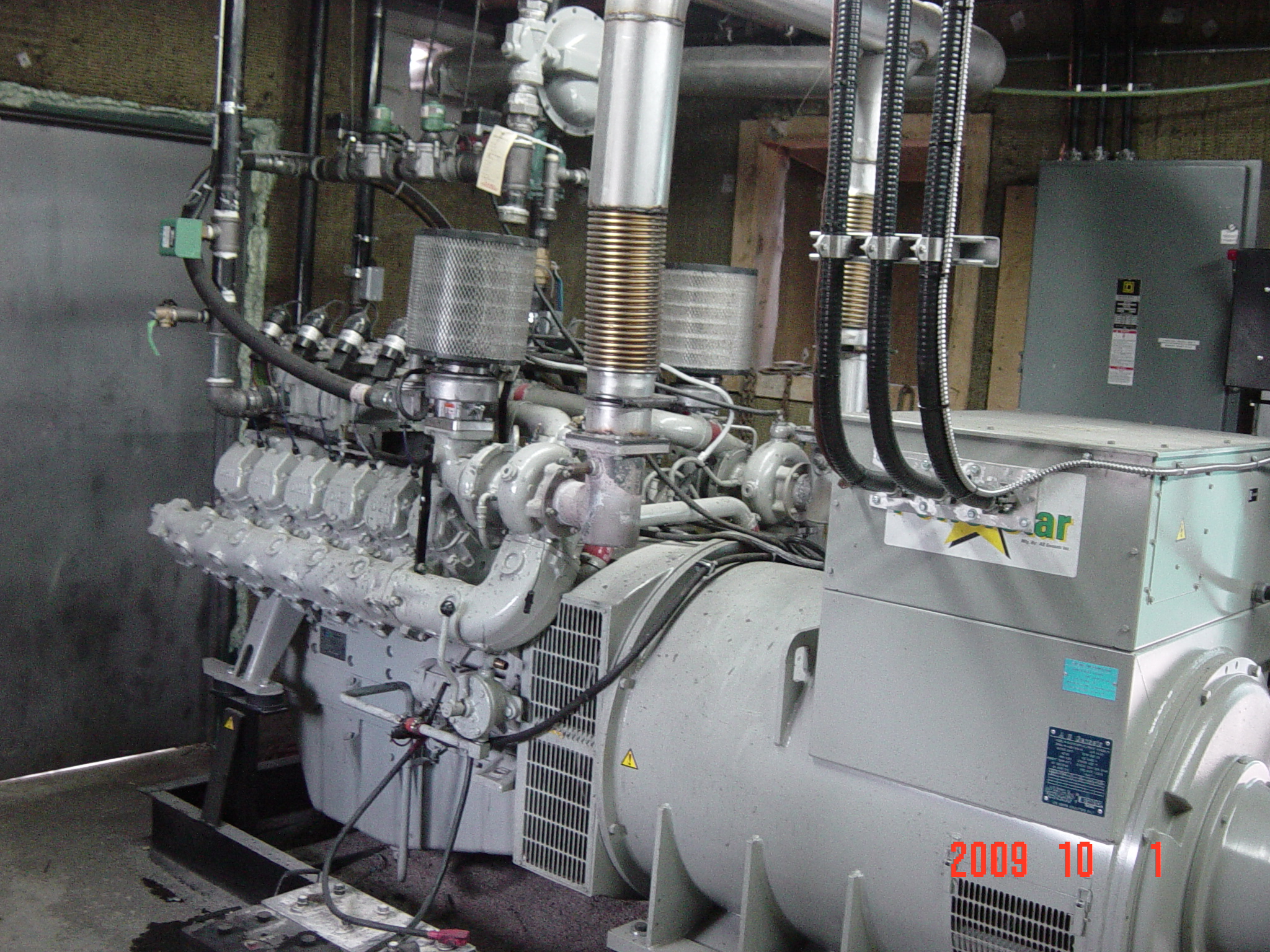

/ Wasted heat #8
Well, I have seen a hundred because I always like to see them. I guess, having the doors open in the summer gets rid of the heat. Just like I found out with the Rad inside the cab of my Kubota Loader, the heat in summer is not oppressive, and I'm one that can't take heat! I'm guessing, like they say, it's a "dry" heat. lol
One of the larger NG sets in use.
