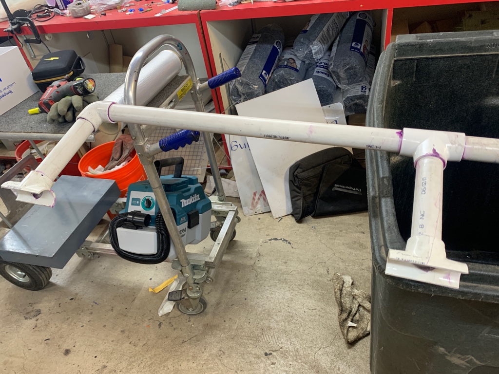

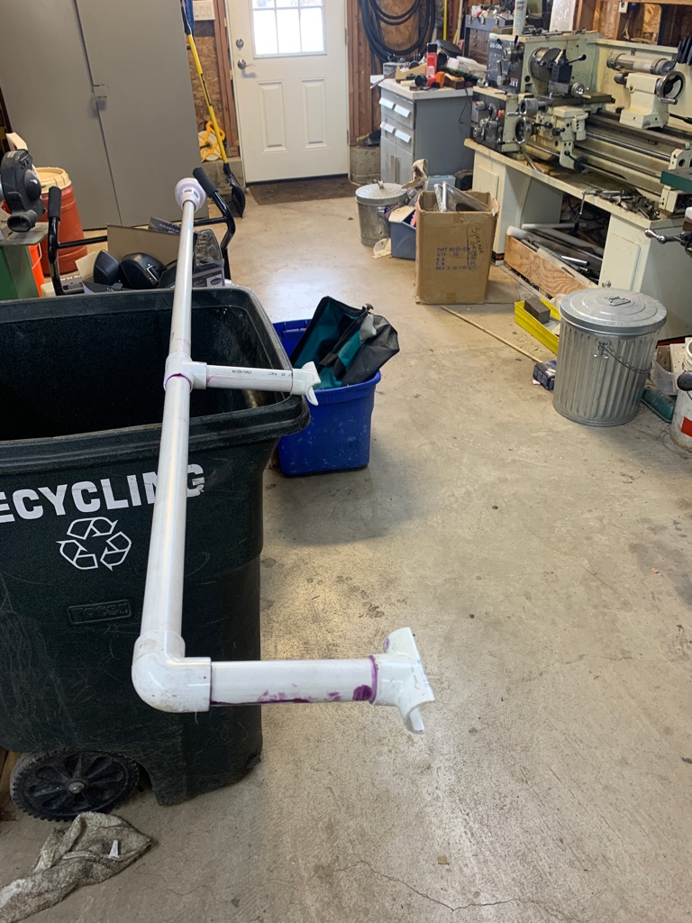

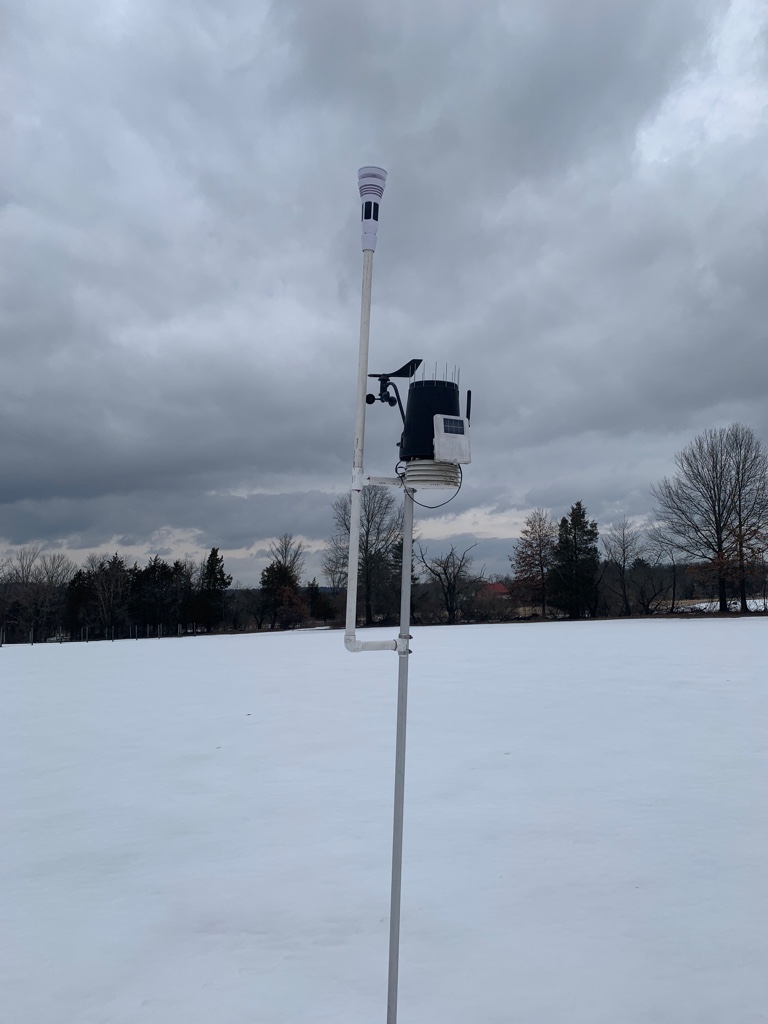

Put the tempest up, and it’s online now.
Seemed to correlate to the Davis pretty well. I used 1” PVC to make the stand off mount because that’s what I had. Sees like it will be OK.
The tees that were sliced in half are secured to the existing pole with 4 hose clamps. The pole is about 200 feet from the house where the hub is. It seems to communicate just fine. Here’s a link to its data-

Paul,
has this setup affected wind to the Davis with the pole in the wind path?
Not as far as I can tell. I did place the pole to the southwest of the Davis wind sensors, as our wind very rarely comes from that direction as a consideration though. With the present NW winds its correlating perfectly to the Davis
Is a 1" pvc strong enough to hold it up in strong winds? How heavy is it?
How heavy is the Davis? How long is the pole you have the Davis on? What is the pole you have the Davis on? Is it pvc also?
The Davis is on a stainless pipe approx 1-1/4” OD and about 10 feet off the ground. My choice of PVC was based primarily on the fact that I had the pipe and fittings. It was reinforced by seeing that the optional mounting kit uses PVC.
