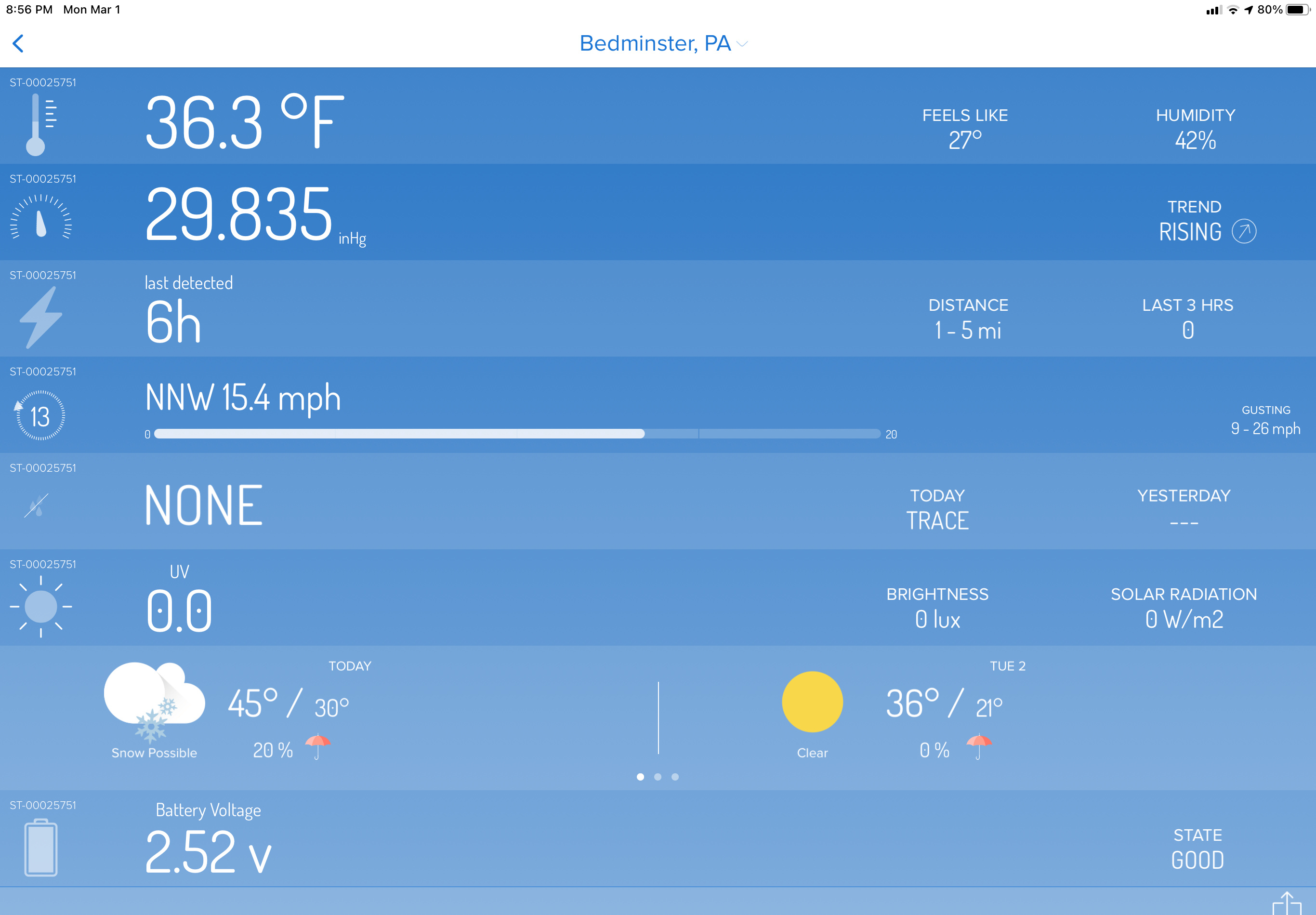

Mounted the Tempest station this afternoon. Took less than 15 minutes from start to finish. I will have to say, this was the easiest and simplest install for a weather station. Will post a pic when I can.
Here is a link: Weather in Gladys, VA

Hi tibadoe. I followed your link a saw your live weather at 17:05 ET, 3/8. It indicated a lightning strike within three hours. Yet when I went to Windy Weather Radar, I saw no signs of storms for the entire east coast. Does the lightning detector give false alarms often?
/ Weather Stations #77
It registered 3 false lightning strikes since I activated it today. Not a cloud within 50 miles of me. I looked up on the Tempest Q&A page and it listed a few possibilities that can cause it. Looks to be possible interference of some sort. Will investigate a bit more.
/ Weather Stations #78
What value for RSSI are you getting?
Mine is -25.
The RSSI is located in the settings on the tempest app (bottom right) then stations, click on your station, click on status.
Motion detectors will cause a false lighting notification. My lightning alert has been quite accurate.
/ Weather Stations #79
Mine is -25.
At 7:30 the top RSSI is -53 and the bottom RSSI is -56. What is this telling me?
/ Weather Stations #80
The strength of the signal between the hub and your station. 0 is the best and the hub and station would probably be sitting next to each other. -100 is the outer limit.
