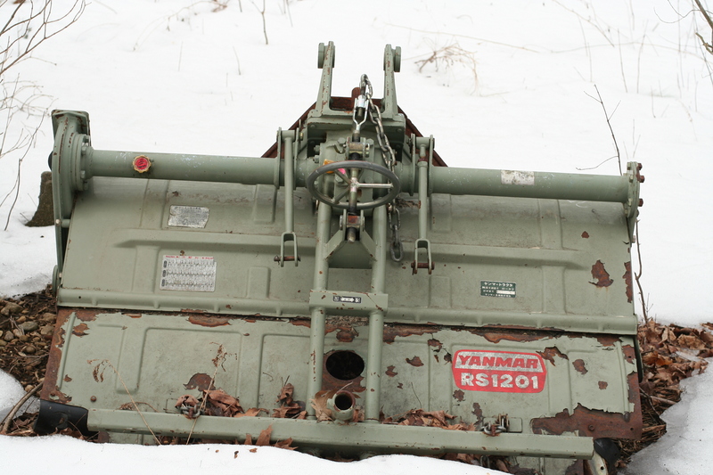

I'd be surprised if the RS1201 (48" wide) that came with my 1510 was much more than 300lbs. It would be a bit awkward to get in the back of an SUV though.

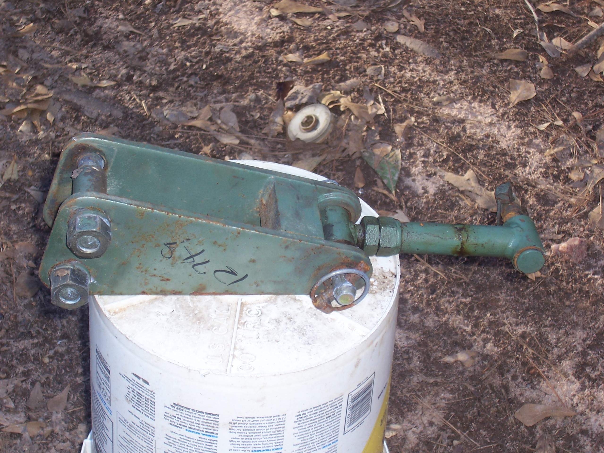

New tines and everything working Properly from the site I posted. And the top link is almost a must. :cool:

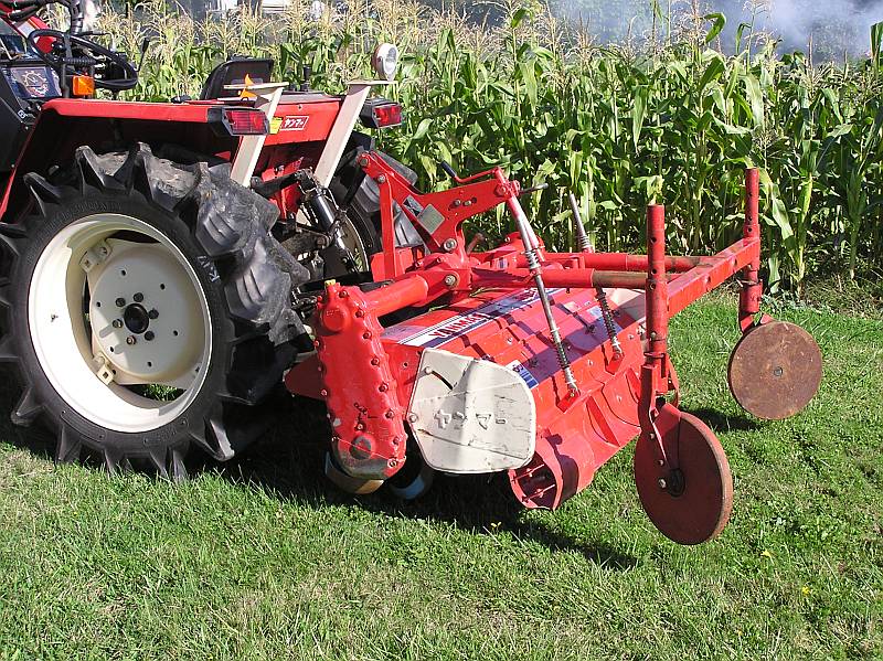

The mount & link Cary has posted give general shape but these mounts and upper links have changed somewhat over the yrs and can vary with tractor and tiller. My mount has a tag on it saying which tractor it worked with PTO shafts are quite short if using this mount. Yanmar had their tillers mounted VERY close to rear tires when tiller was in the down position thus requiring the special mount and upper link that caused the tiller to pivot as it was raised so it would miss the rear tires.
Here's a pic of mine. If you look closely you can see the mount and upper link. I no longer use these as I went with a quick mount hitch.
Hitch setup can vary with tiller model. Some early ones had 2pt hitch and later 3pt hitches. And Yanmar had for a while a quick mount hitch and the one I saw was unique to the tiller. Best I can say is, make sure tractor, mount and tiller are all compatible with each other. Don't want to get back home and find something not working.

I bought the cheapest tiller among 20 or so and got a better price because it needed a new $5 input shaft seal, but the leak there is only a stain, not a drip, so I haven't replaced it. Here's a picture the first time I attached it. I found the driveshaft too short, apparently shortened to allow a slip-clutch or ratcheting over-run clutch. I went back and the dealer gave me a shaft extender (not shown here). My point in posting this is to show the special top link in use. This is the same device as shown in Carey's photo a couple of posts above this one. Note how close the tiller is to the tires; the special top link is essential. And here is a photo I copied from someone's post here (Carey??) again showing the two-part top link you need. I wish my equipment were as clean as that!
In summary - be sure to get the correct special top link for your tractor, and the special short driveshaft. Either is very expensive to obtain separately and you can't use the tiller without them.

The top-link I had to get separately was $35. So its not necessarily a deal breaker IMO. You might call Fredricks or Spalding ahead of time to make sure they have one if you need one. I just got mine yesterday and I can't wait to check the fit this weekend. It looks just like Careys pic of it. If you need a driveshaft...I'm not sure what that would cost.
