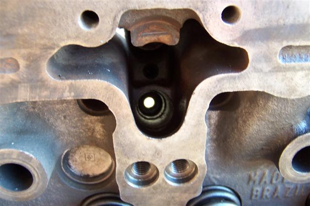

Today started out with the simple plan of putting the head on the block and assemble enging parts. It sounded simple enough while having my cup of coffee and watching the birds in my yard.
Of course, I'd forgotten about the injector nozzle breaking off when I took the head to the machine shop. They fixed the exhuast bolts, but never new about the nozzle, so it was still in there this morning.
I tried to tap it out without any success. Then I tried to break it free with a punch, screwdriver and chisel with minimal results. After 5 hours, I had all sorts of little pieces out, but then I hit a point that I couldn't go any further.
This is when I got the idea to drill it out. I've never claimed to be very quick in thinking up solutions, but in time, they usually come to me.
I needed an 11/16 drill bit, which I didn't have. Luckily Tractor Supply had a few.
An hour later I had it out. Lots of oil, lots of compressed air and I added a handle onto my drill to control the drill. It was a little scary, but in the end, it worked.
This gives you an idea of what I was working in. The hole is 7 inches deep.

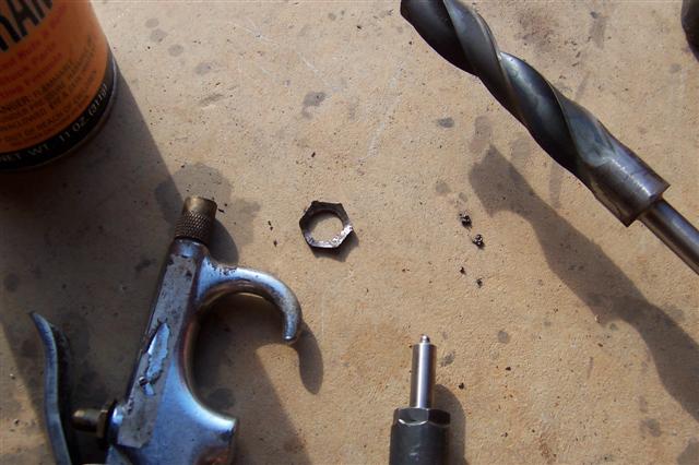

That little nut looking thing is what finally came out. The rest was in shavings!!!
The brand new nozzle is at the bottom of the pictures and gives you an idea of what the old one looked like.
