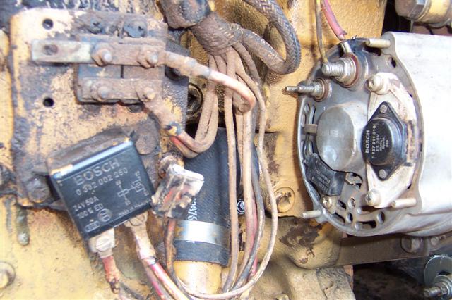

#327
Derek,
Thanks, I checked the batteries and had 25 volts. I went to the key and had 25 volts there as well. I then went to the starter and didn't have anything. I put the ohm guage on it and found the wire from the key went to this 50A fuse.
I had power in, but nothing coming out!!!
I also realized what happened.
The hot wire to the alternator lost it's plastic cover and was close enough to the case to make contact when I drove the dozer off the ramps. The contact shorted out the fuse.
This is a picture of what it all looks like. I had no idea it was a fuse, in fact, I just thought it was some unknown assesory that I didn't have to know about. /forums/images/graemlins/grin.gif
Eddie

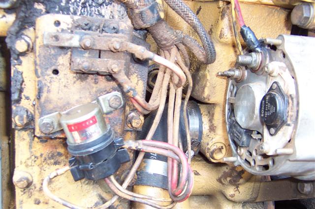

For $84 you too can have a new 50A fuse!!! /forums/images/graemlins/frown.gif
To top it off, not only is it rediculous expensive, but it's totally different. The mechanics at Case had to look up the electrical schematics to figure out what is what.
Turns out it doesn't matter. The two big wires gor to either side. It don't matter. The small wires go to the small terminals on either side. Again, it don't matter wich side.
Once the hard part was figured out, it went togeteher real easy. /forums/images/graemlins/smile.gif
Eddie
