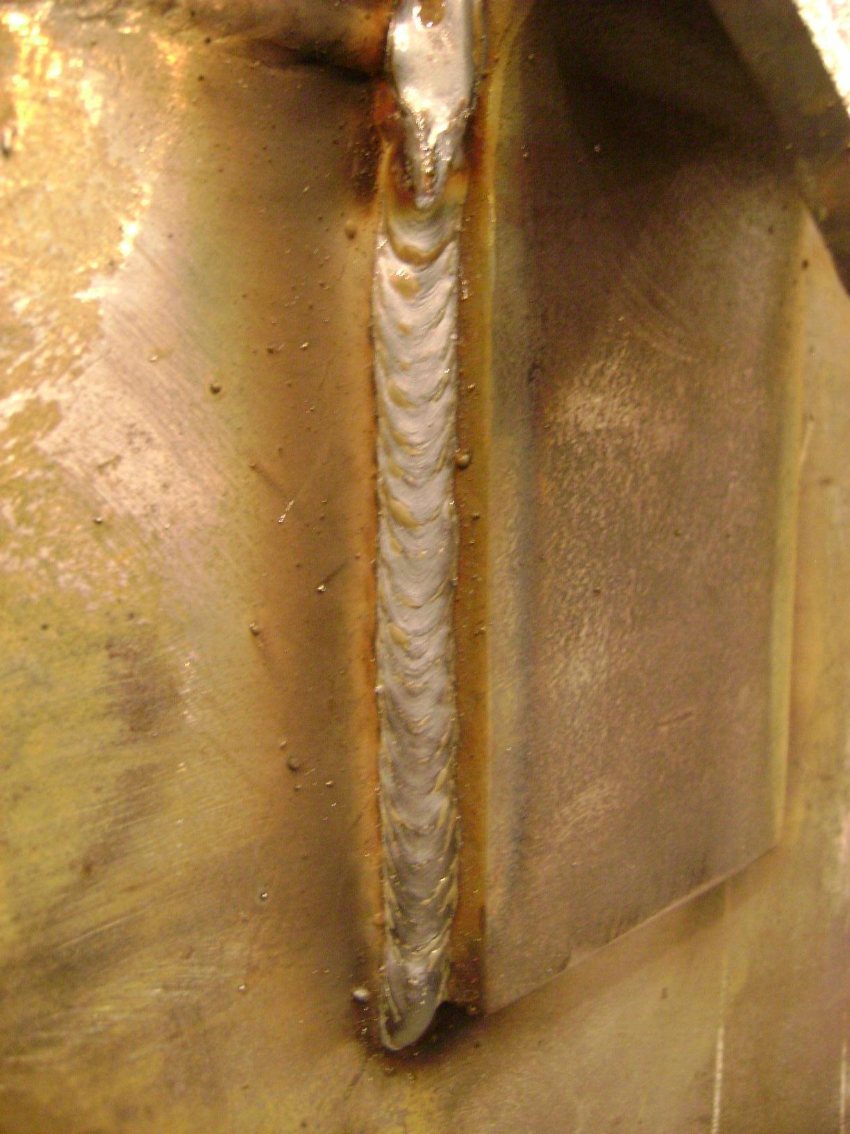

When Mig welding I have a personal policy of running as hot as I can handle it. Out of the hundreds of welding tests I've taken,
Now, I don't know what a "hobbyist" weldor like yourself would be doing taking welding tests! :laughing:
/ Welded grab hooks #23
Umm, umm, umm, well if you don't ever challenge yourself you'll never learn. Yeah, that's it!:D
What is it that makes the bead so smooth like that? You can't see any ripples at all!
I don't really know, maybe the hotter gas, or the amount of volts required to hit spray transfer. :confused3:

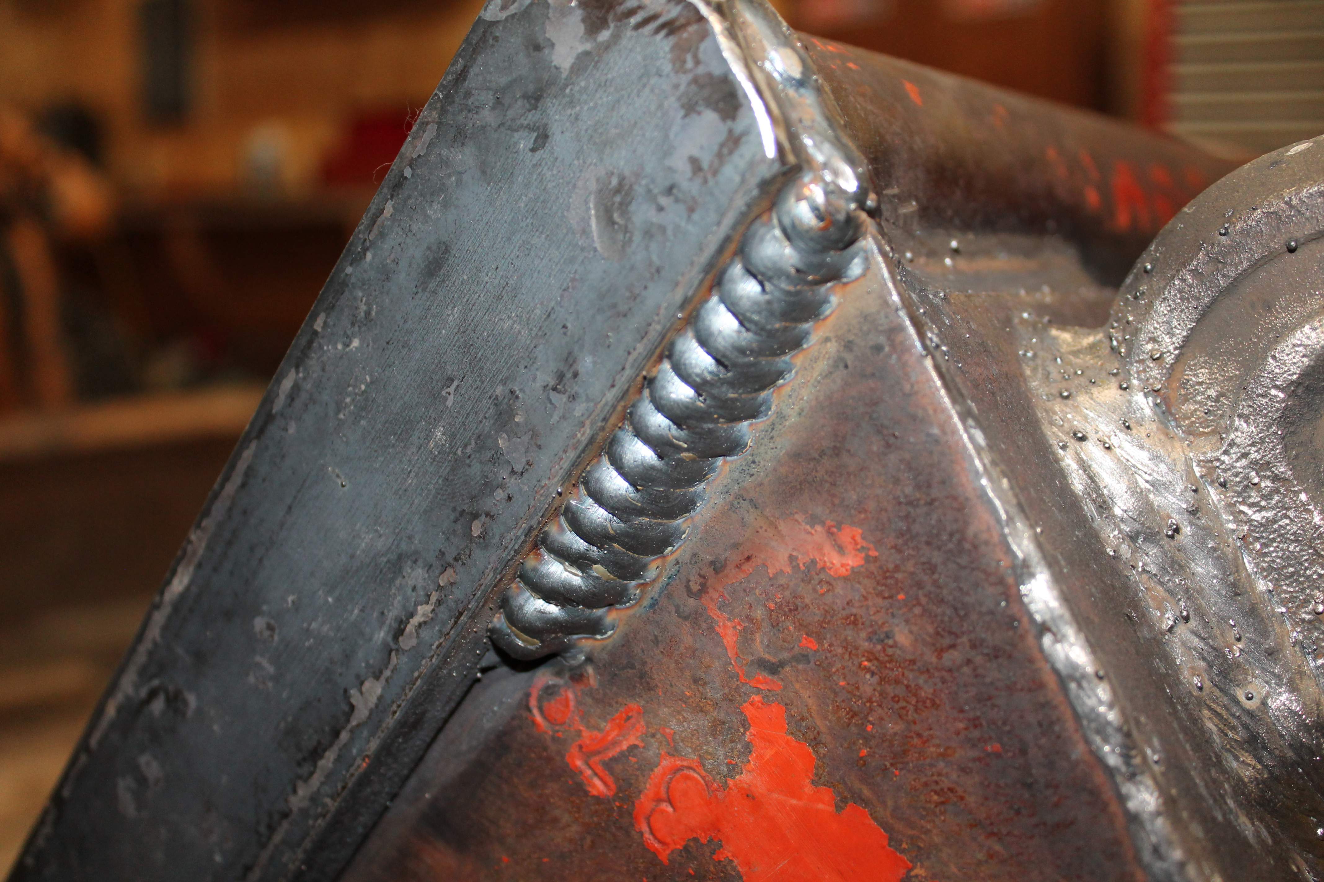

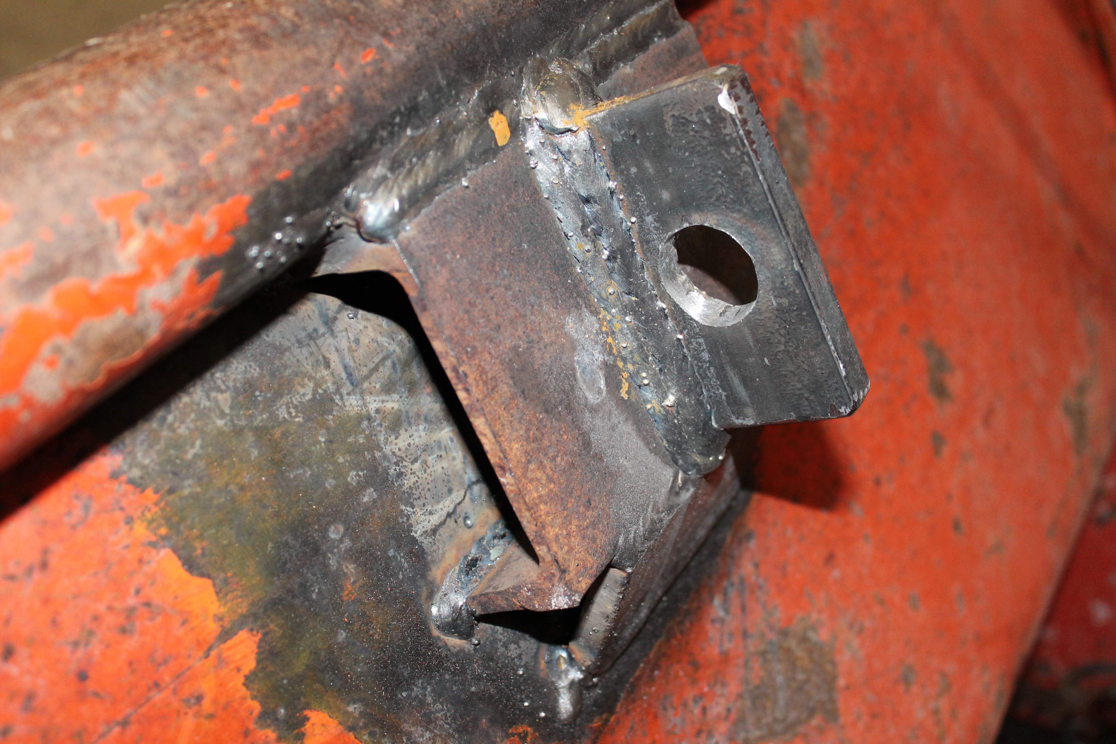

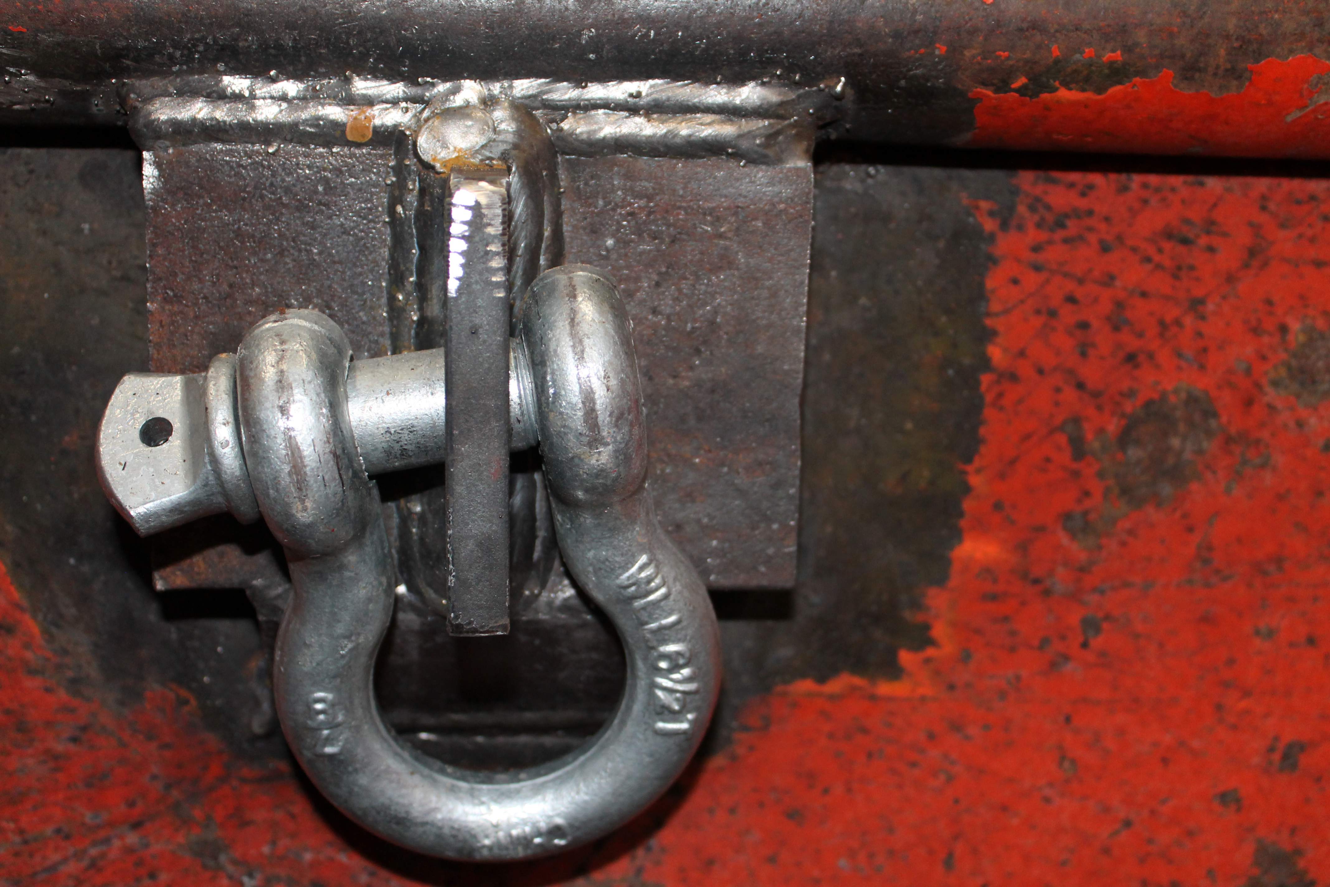

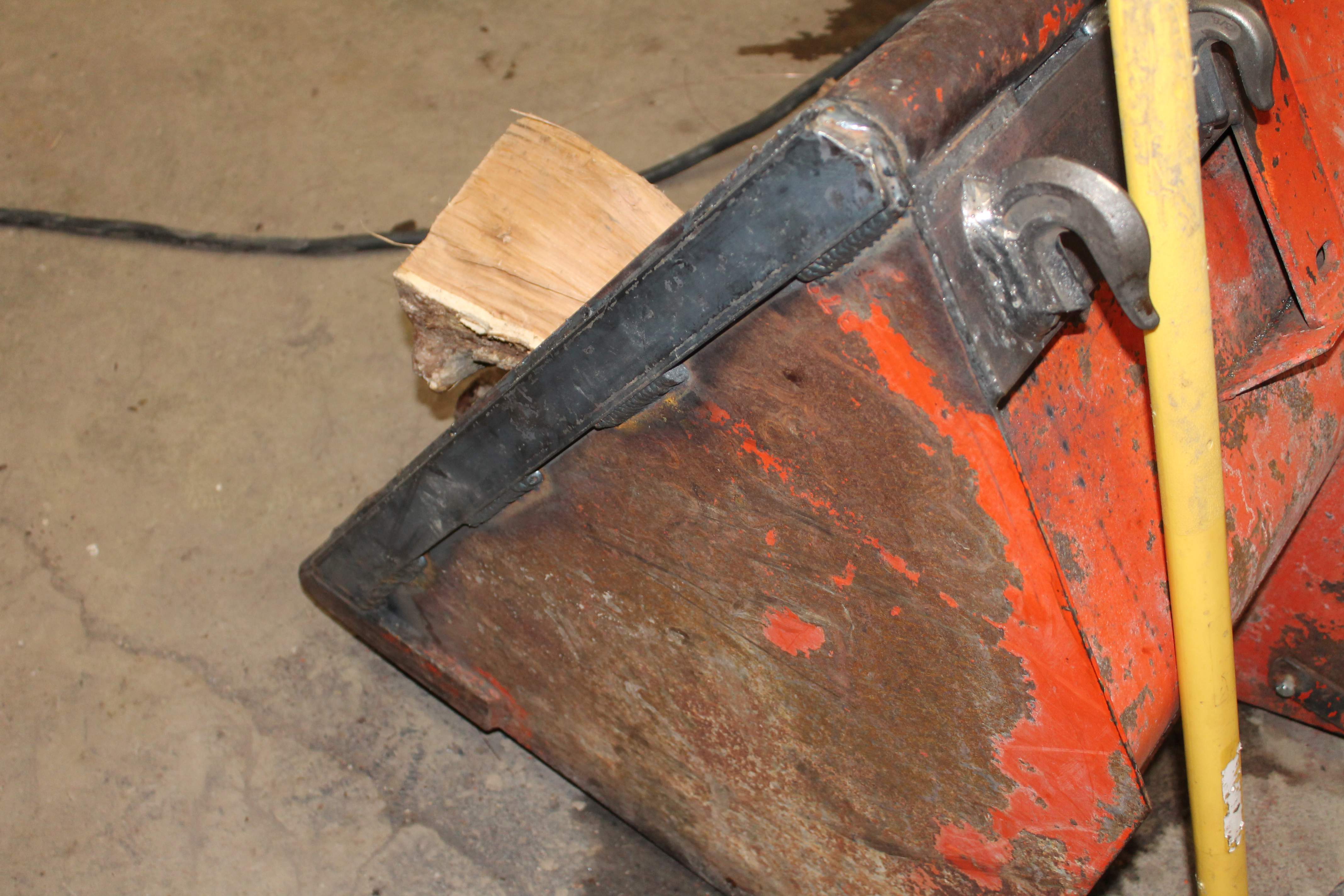

Here is what I did fo the middle. I also added some 2x1/2 to outside edge of bucket. Hopefully it will help keep it straight.

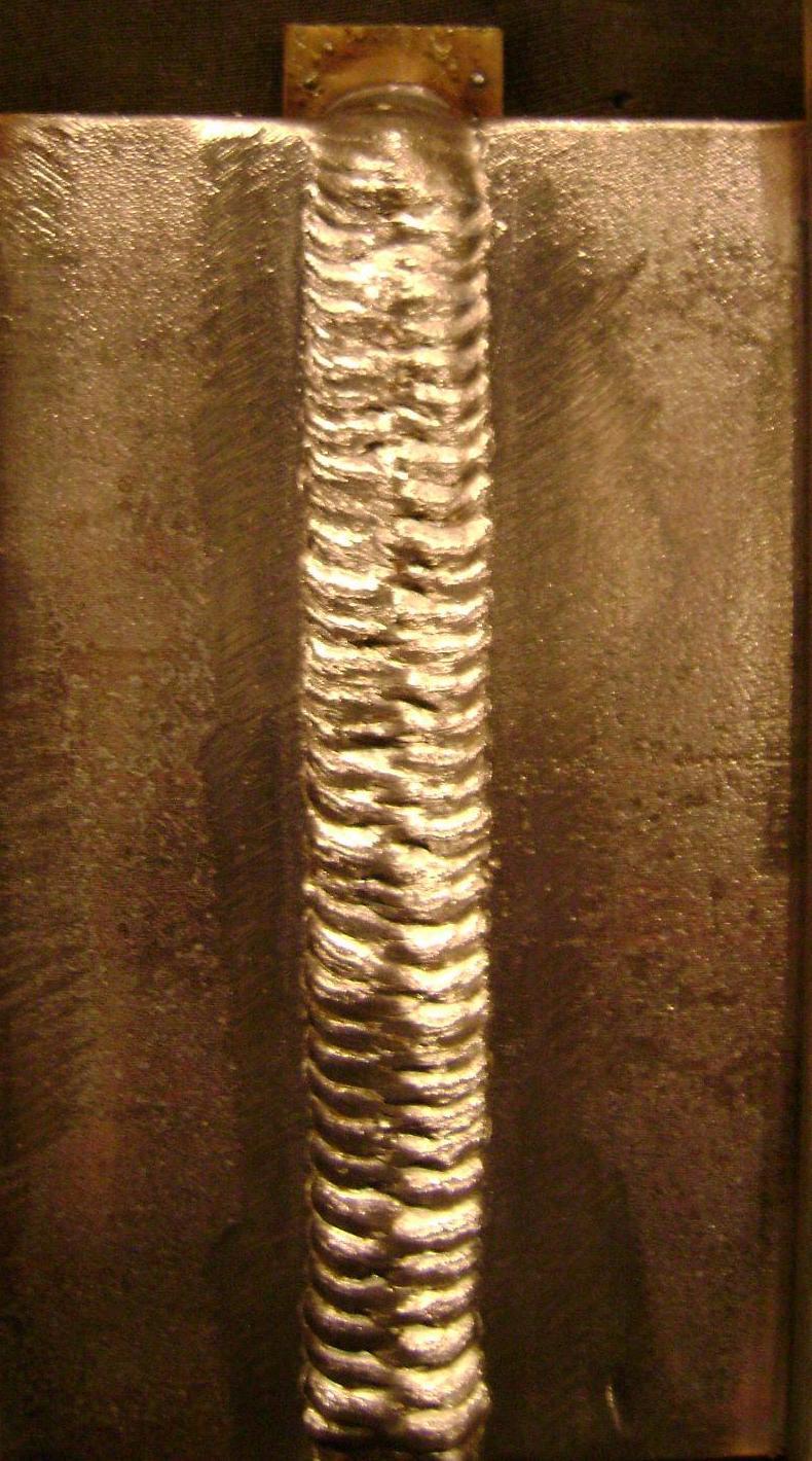

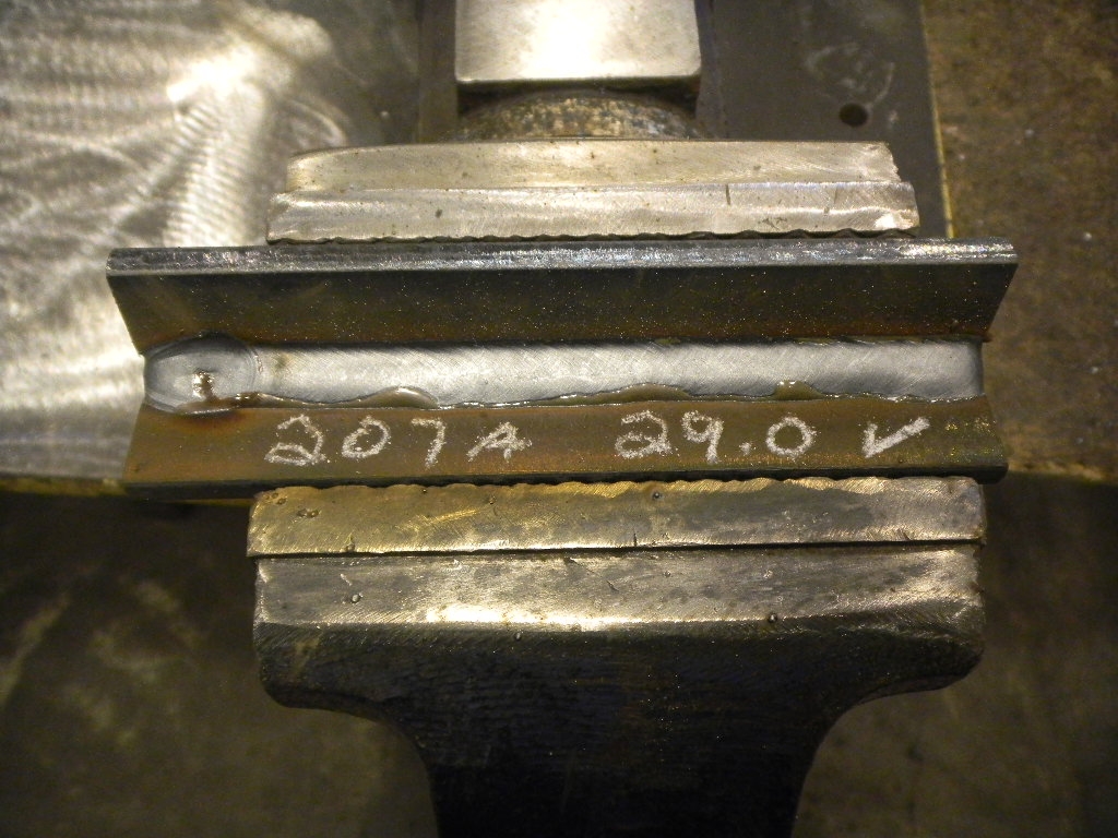

Hey shield arc, I added a vertical up for you to critique! I use to be a lot better when I burned wire for a living!
Well I'm no expert, but it looks a little cold to me.;)
Campbell-Hausfeld WF200000 30A-85A @18V (Max, not duty-cycle)
I think you're pretty much stuck with .030 wire.
Looks similar to the beginning of your first example. The weave could be tighter, but the heat seemed good. Looked liked it wetted into the edges good. That's a tap machine, it's either too cold or too hot. No middle ground! I've got to buy a miller252 or a Lincoln 265 would work! Just can't convince the wife.:laughing:

I wonder if anybody makes a Mig machine with hot start? It does take a little bit to get the plate hot. Then by the time you get to the top it is way too hot!

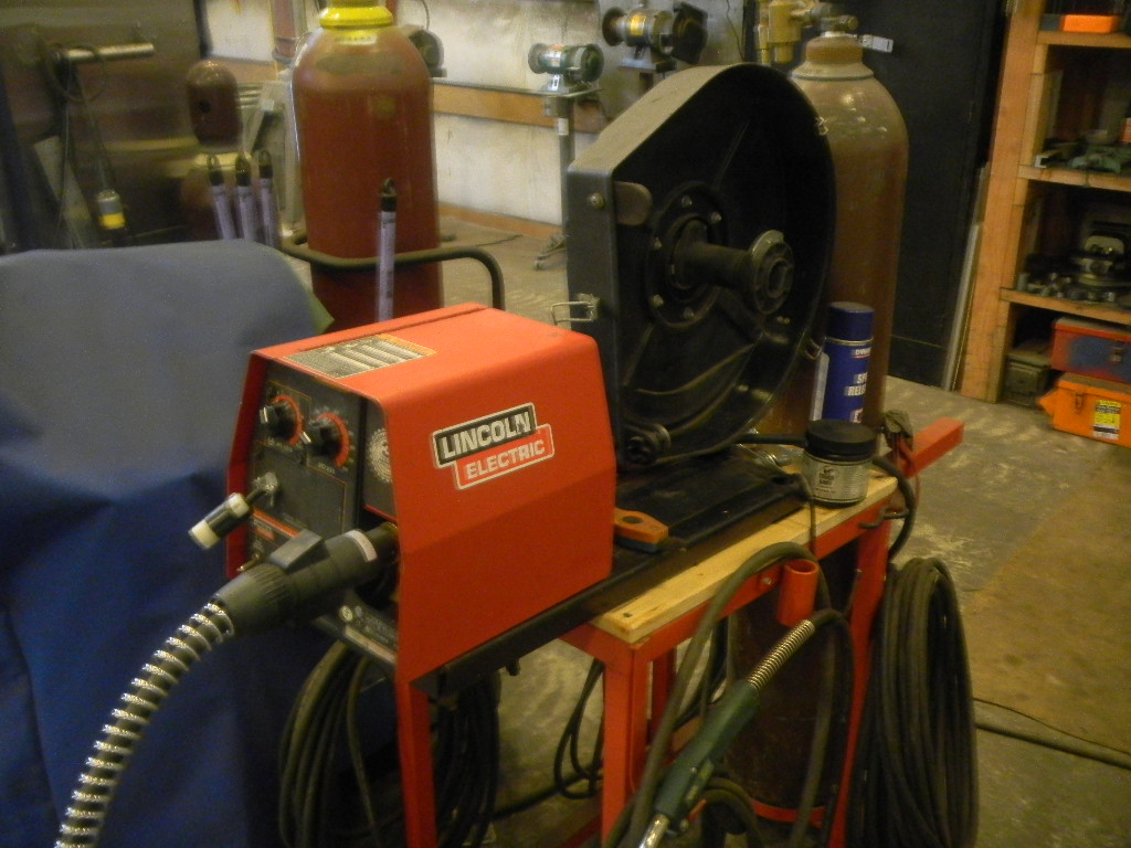

If you're going to buy a machine, buy one of these, hands down the best machine I've ever run.:cool2:
Yep tap machines suck, but they are good for what they do. Sticking pieces of metal together. I've done some decent welds with them, but just can't do what I could with the big machines. Is that a single phase or three phase machine?

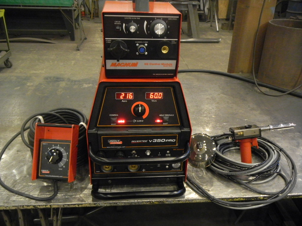

I've always been happy with my Lincoln welders. I had a small issue with the V350-Pro when I first got it. In my area there are only two welding repair shops. I've been going to one of them for years, they take very good care of me. They handle Lincoln and Miller for me!
I would really like to get my hands on a Miller XMT-350 to compare it to my V-350-Pro.
My Miller Dynasty 300 made a Tig weldor out of me! Miller vs Lincoln same thing as Ford vs Chevy vs Dodge. I think it boils down to the model that fills your needs.

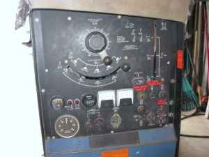

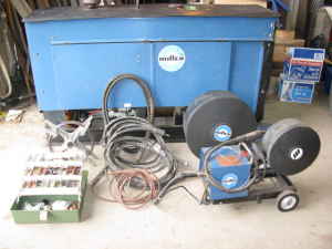

If anything I lean towards Lincoln for engine drives, and I should know. In 1983 I paid $9,378.00 for this one.
Nice! Do you weld for a living? Where you located?

Nope, just a hobbyist. Few miles out of Tacoma Washington.
