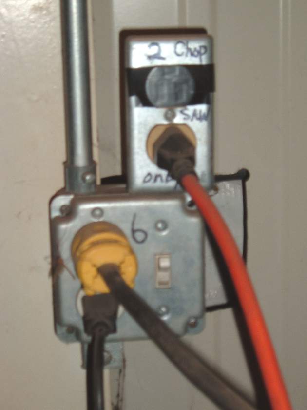

Going to throw some irony in here, I don't disputing any previous remarks, but I have Hobart Handler 140, manual states 20 amp circuit ..... Ironically welder on 4 (highest out put setting) it trips 20 amp breaker..... Thought maybe faulty breaker so I swapped with another 20 amp breaker.... Same problem..... So after some investigation I looked at KVA specs in manual and it calculated out to actually be a 24.5 amp draw , not the 20 amp manual states at mid range settings..... SO... Here come's the issue some will have heart burn over..... Trucked off to local hardware store, got new 30 amp breaker and about 6 feet of 10/2 W ground, and best quality (single) 20 amp receptacle I could get..... Wires up new 30 amp breaker with 10/2 wire to 20 amp receptacle, labeled circuit dedicated to welder only.... Now the results, run bead for what ever time required for project, check the receptacle/plug combination for heat factor, and nothing to be concerned about and I also use a 12 gauge 25 foot extension cord with MIG machine again no heat issues, and the 14 gauge line cord supplied with welder does not show any signs of over heating.....
I also have one circuit similar for chop saw. Its problematic and there is no good other solution really. Only real legal way might be to change to a 30 end and use a 30 outlet but its rather awkward and as long as the circuit isnt used for other 120 loads its safe. The up side to this is the saw and your Hobart will handle or work safely on a 30. Most 120V wont, some air comps will. When this is done a needs a 14 cord. You went beyond, nothing wrong with it but could have used the 12.
