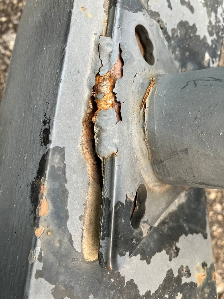

Squirt gun strikes again......
Neighbor returned from a trip yesterday and said the trailer jack scraped the ground when pulling out of a gas station. At least that bead would have looked suspect before the paint went on. The scary ones are those that look good but only have fusion at the outermost edges so they look ok on visual inspection.

I don't understand how anyone could 'weld' like that, just laying bead on top of one side. Amateur here, but the minimum spec while welding is that the pool has to cut into both sides of a joint and have some obvious depth.

I think to some minor degree you miss an important point. That Jack held for a while, maybe years. Not every repair needs to be permanent. Bridges, gas lines, ecr yep; a non structural weld like that, with no danger and no real cost if it breaks... no so much. Yes, a good weld is always better than a bad weld; but Sometimes a bad weld is better than a broken part (not always).

I thought he was referring to a smallish welder filling a large gap. Takes multiple passes. :unsure:

My point, is not expressed well; if you never did some kinda iffy welds, you would never do any welds; cause you got to start somewhere. Not every weld needs X-rayed, (or posted on Instagram).

Yes, but the welding community is bad about "gate keeping" and attacking everyone. Truth is, sometimes slag inclusion doesn't kill, or undercut, ect. Sometimes you just need to stick this piece to that piece, and butt ugly, non text book stuff is fine.
Even on TBN, not as bad as it used to be; guy buys a welder, and posts a picture or 3, cause he's proud he did he's first weld. Boom, 12 guys attack him, his welds, his shield, his welder, and his dog.
Not often you see somebody say "good job, but next time give it 15 more amps, and try a slower weave"

Looking at it, it looks like there was no gap prior to hitting the jack. They just got no penetration on the tongue and all on the jack plate.
The nice part about metal work and welding; if you look at it, assuming the jack tube is fine; wire brush; smack it with a 4# sledge to get it sitting right, and run another bead. No harm, no foul.

Maybe I wasn't clear. During the welding process, hood down, if I don't see any penetration on one side of a weld then I stop immediately and figure out what the problem is. I thought everyone does this. No?

The key word is SEE. For me, actually seeing what I'm welding is pretty hard. I wear readers under the hood, but it's still hard to actually see the weld puddle.

Well, if we want to go full send; you can't see the quality of a weld; you need to A) X-ray it; B) cut and acid etch it; C) stress load it to the ultimate yielding point (IE break it). Even a perfect looking "stack of dimes" doesn't necessarily mean a strong weld, fully melted into the parent material.
This is easier to do/miss with a MIG/Flux, which is what he mentioned by the glue gun. Arc, easier to get penetration; but also easier to get slag inclusions, voids, and all.
So for this trailer jack; there was likely a very fine, dark line, that was visible after clean up; which would be more visible with a bright light in a dark room; but there would be a distinct lack of undercut on the picture forward side, on the trailer tongue. Some of it clearly did get a good enough "bite", and the axle side clearly was all on the jack.
So, the guy welding it; after clean up, "should" have seen that there might not have been good burn into both pieces. At which point, he could either run a 2nd beed, half on the frame and half on the 1st beed, not text book, but effective; or grind out the questionable part, and start over.
/ Welder Recommendations #75
We can also note; this jack took load in an un-intended way, and was side loaded, at the end of a 24" lever. It was designed for straight tension (the jack pulling vertically away from the tongue), but when they drug the jack; they introduced a bending moment. If it was Designed to resist that, it would be specifically welded at the corners, to prevent the start of the bending.
Still, more amps, slower travel speed, better pre-weld cleaning, and a post weld/post clean-up inspection would show the weld wasn't great.
So, if Mig, the pass should have looked down to the frame if swirling, or should have been at a 45, right in the V of the joint, with a slower speed, and "possibly" more amps, but not necessarily.
If Arc, your amps look fine, but the rod needs swept down to the frame more on each "C", looks like we just stuck the rod and got an arc and rolled with it.
