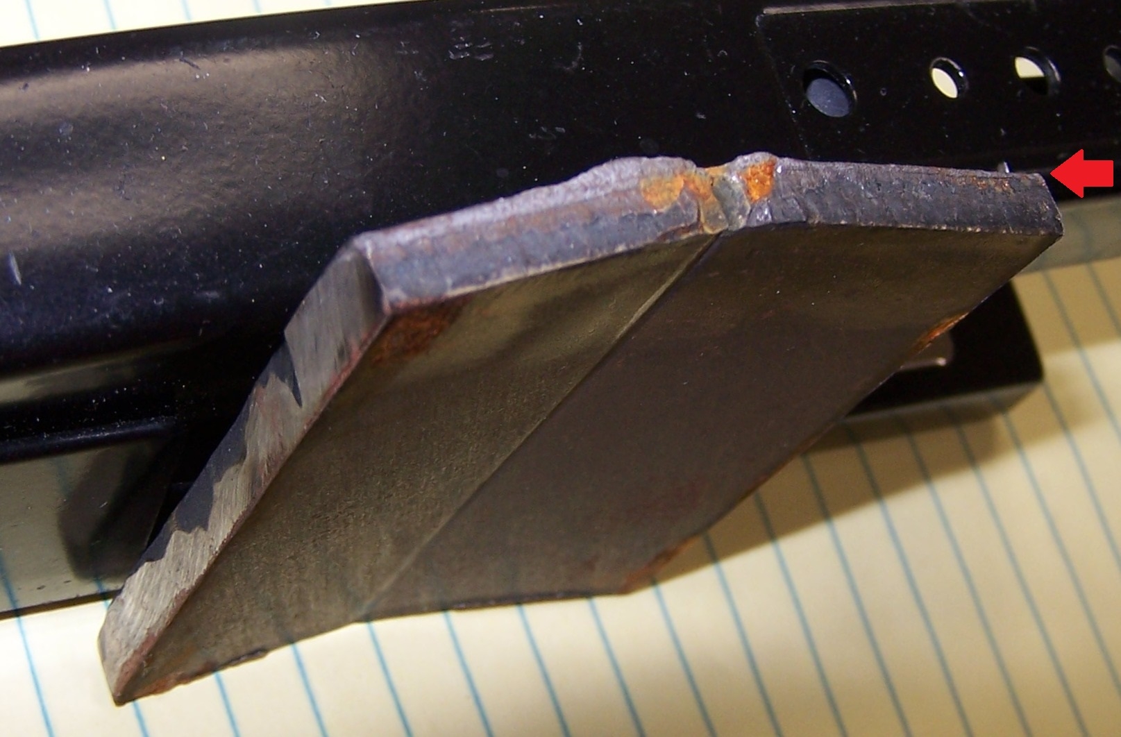

I don't understand how anyone could 'weld' like that, just laying bead on top of one side. Amateur here, but the minimum spec while welding is that the pool has to cut into both sides of a joint and have some obvious depth.
Maybe I wasn't clear. During the welding process, hood down, if I don't see any penetration on one side of a weld then I stop immediately and figure out what the problem is. I thought everyone does this. No?
Yep, once proficient the person welding should know by sight and sound if their weld is going well. If not, stop, grind it out and start again.
If you cannot see the weld your making, how can you tell if the weld is being properly done, or not? It's been over 48 yrs since I welded in Jr HS Metal Shop. Made a bench press out of angle iron and used it for over 25 - 30 yrs. Had 325lbs on it and it held up perfectly. All angle iron
Before we painted it blk, i remember taking a sm pointed like hammer and always knocking off the slag. We only had stick welders then, but i got an A on the project & the welds were pretty robust.
Being in my 60's eyesight is becoming an issue. Mig and Tig gas nozzles interfere with getting a good view of the weld puddle. Also the use it or lose it adage is very true. Trying to do the same welds compared to back when welding everyday is frustrating. Lack of muscle memory I guess. It takes me about a full day of welding to get comfortable again, though most tasks don't take that long.
We can also note; this jack took load in an un-intended way, and was side loaded, at the end of a 24" lever. It was designed for straight tension (the jack pulling vertically away from the tongue), but when they drug the jack; they introduced a bending moment. If it was Designed to resist that, it would be specifically welded at the corners, to prevent the start of the bending.
Still, more amps, slower travel speed, better pre-weld cleaning, and a post weld/post clean-up inspection would show the weld wasn't great.
So, if Mig, the pass should have looked down to the frame if swirling, or should have been at a 45, right in the V of the joint, with a slower speed, and "possibly" more amps, but not necessarily.
If Arc, your amps look fine, but the rod needs swept down to the frame more on each "C", looks like we just stuck the rod and got an arc and rolled with it.
A weld is a weld and that the jack got loaded the wrong way is irrelevant. Not sure why you keep excusing the poor workmanship. That Mig weld had a lack of fusion which is seen time and time again with Mig. Here is a picture of a section of a pressure vessel that failed. The entire v notch was filled with weld, but as you can see there is only a paper thin amount of fusion (red arrow) on the outside edge, which is what one would see inspecting the weld from the outside. The vessel passed the pressure check only to fail in the field from pressure spikes it would have easily handled if the weld was good.
Bottom line is Mig makes it easy to make a decent looking weld that isn't worth a $hit. Rookie welders need to get good at Mig before doing structural projects where life and limb are at risk. Welding is fun and rewarding. Like anything, know your limitations and use sound judgment when considering the failure modes of what you are working on.

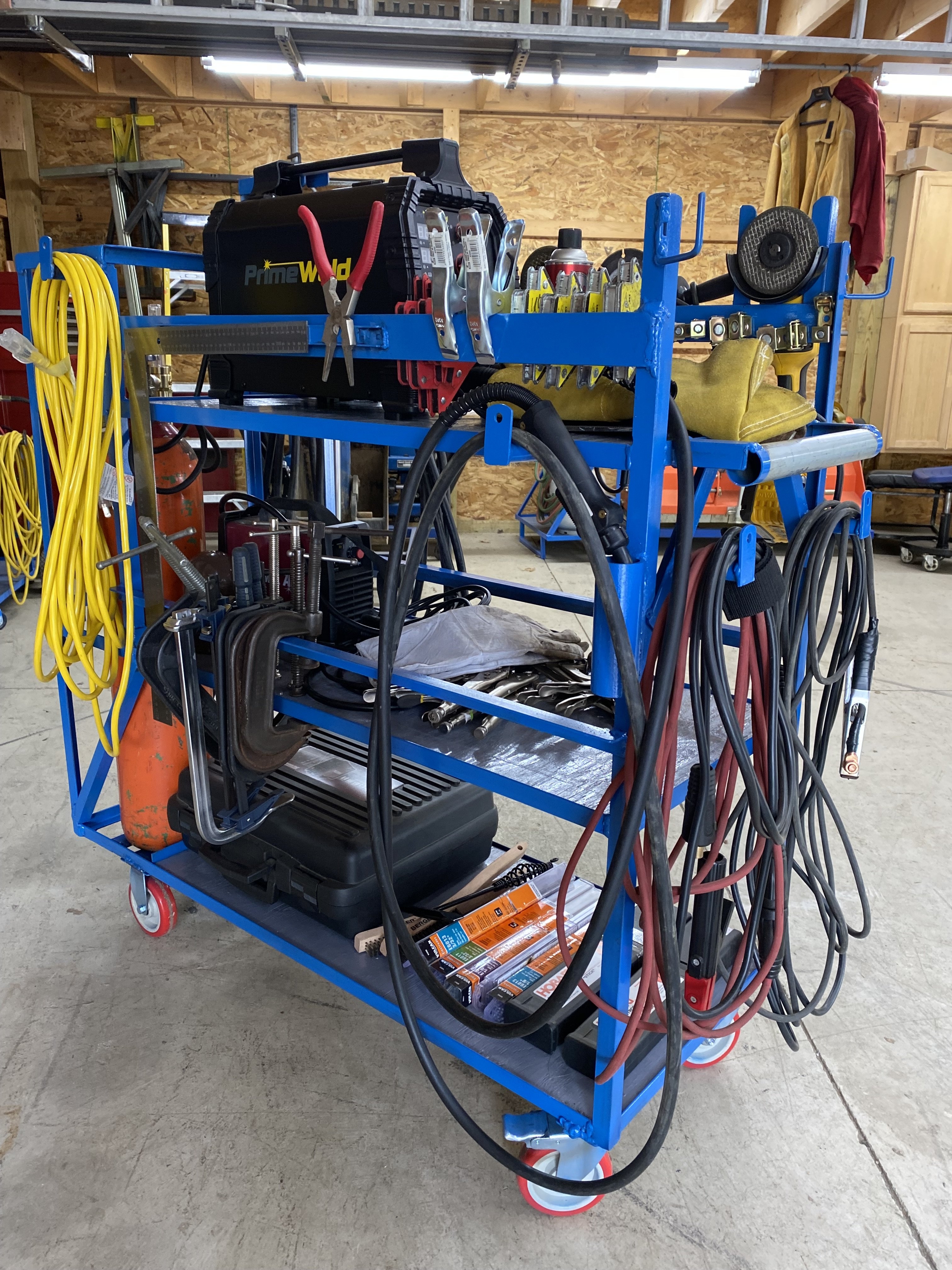

Some advice about carts: don't buy one. They're all pretty bad compared to what you can make for yourself. I took US General tool carts and made rolling frames for them. Most carts are cheap and flimsy, and they put all your stuff out there in the open, in the way, with the grinding dust. A tool cart will keep everything clean and handy. I put something like $325 into each of my carts, and they're way better than anything I can buy. These days, call it $425.
I used the existing bolt holes in the carts, so they aren't modified at all. The frames screw right on.
The Lincoln and Miller carts I've seen are especially pathetic, and the prices are silly.

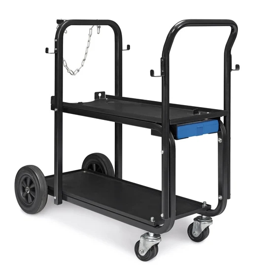

Here is a great example of a stupid, overpriced welding cart you should not buy. This is a Miller, and I found it online for $360+. I had something very similar from Vulcan, and it was very sturdy, but it was also stupid. I paid $100 and sold it for $50 just to make it go away.
Note how everything is out in the open. Note the tiny hooks for holding cables. Those hooks don't really work. Cables are stiff, and they don't like to coil nicely. If you use hooks like that, your cables will stick out and get in your way. Whatever you put on this cart will end up covered in abrasive grit and metal dust, and you will have no place at all for things like clamps, consumables, and pliers. And where do you put your tanks? Add in the obscene cost, and it's a recipe for regret.
Have to disagree about the Vulcan cart, I have one I use for my XMT 304 with a 24a feeder. My only complaint is the tank holder is too small for my 300cuft tank, but that's a pretty easy mod.
The hangers for the cables are decent, no problem wrapping the 15ft 400a gun up.

I like to cut a piece of pipe in half and weld to the top side of my cable hangers to make a little smoother surface for them to hang on.
Have seen people use all kinds of things for this purpose, such as small wheels cut in half, garden hose racks, etc.
