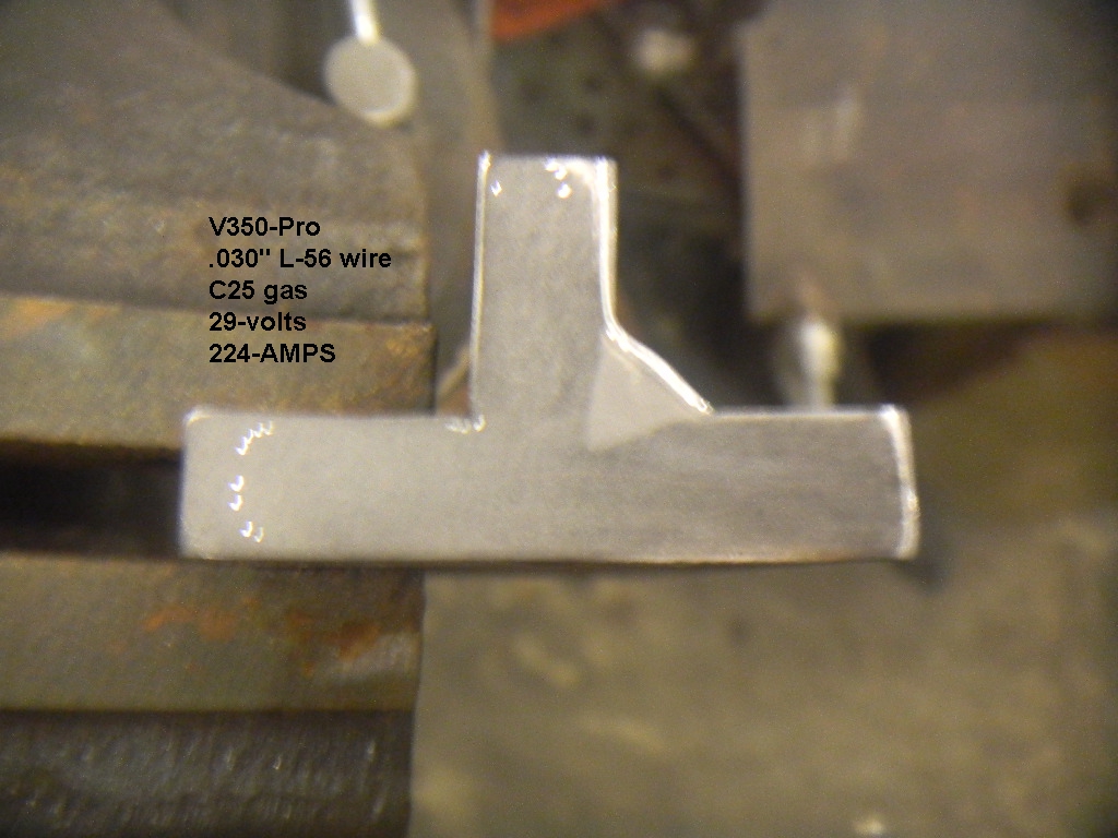

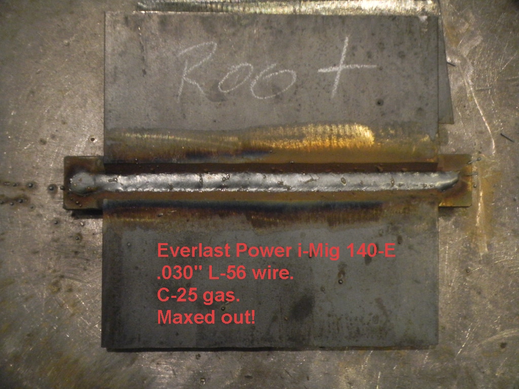

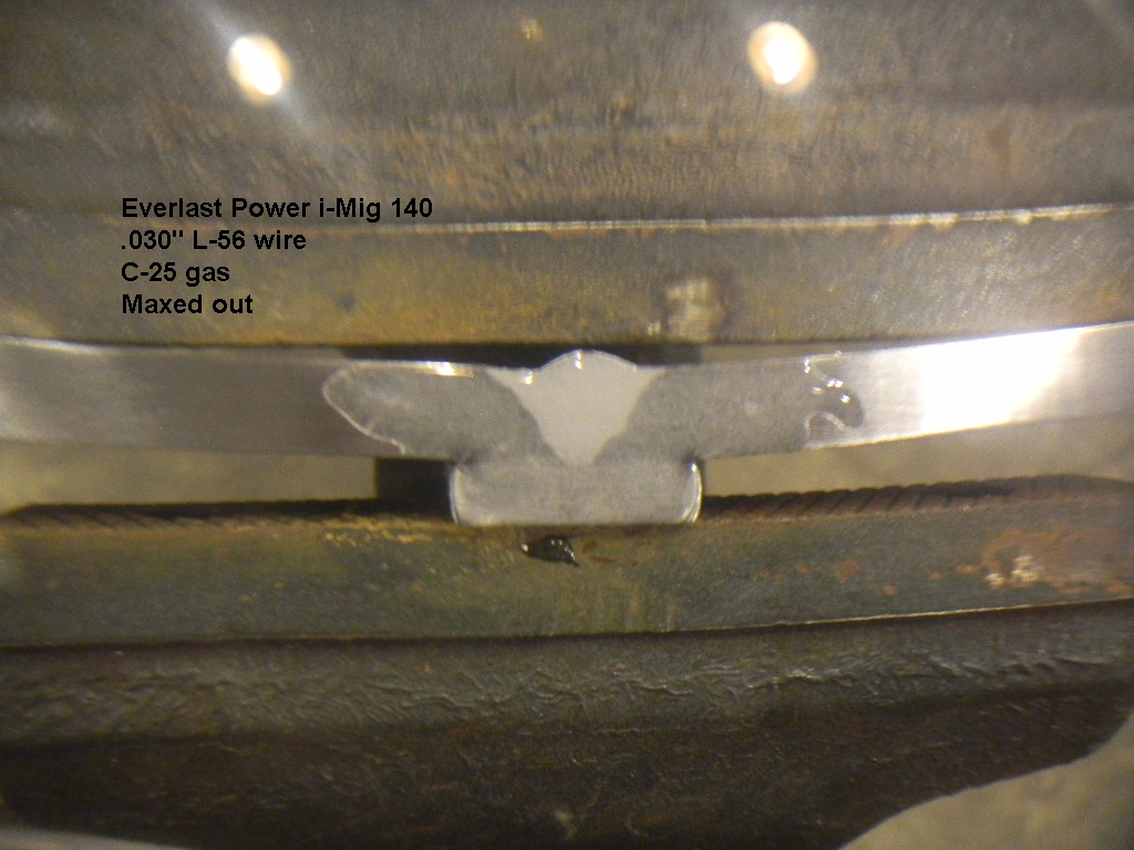

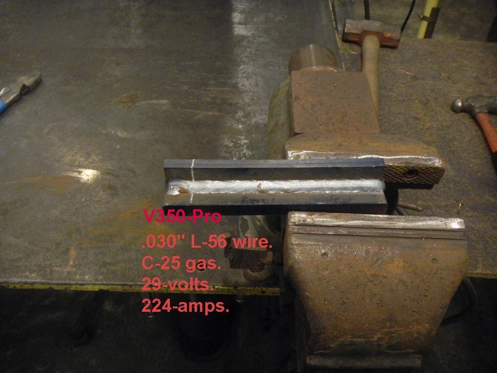

Do you know what 90A on a MIG will safely weld? It's the bottom limit for 16 gauge! 1/16".
So if you only do really light stuff and it's 1/8" wall, you still need 150A.
I've said it before, and I'll say it again! When it comes to Mig welding there is no substitute for power.
Here you guys be the judge.
