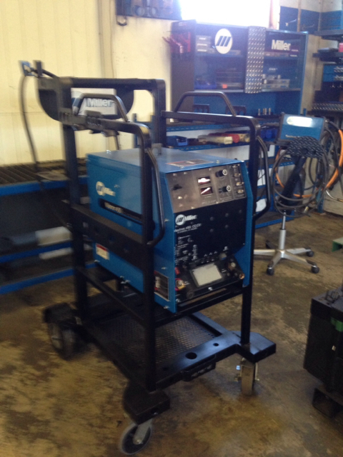

Many years ago I bought a used Millermatic 250, just looked in the book for the duty cycle and it is 40% @250 amps, 60% @200 amps, and the 100% line runs off the chart at about 150 amps. In my home projects, I've yet to run it hard enough for the fan to kick on, much less come close to the overtemp light. But I guess if I ever need to stitch a piece of railroad track to a truck frame, I won't be able to do it in a single go.
As for my Tigwave 250, I'm guessing that it has a higher duty cycle than the electric meter, which would probably spin itself out of the box if it ever ran wide open.

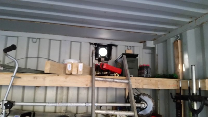

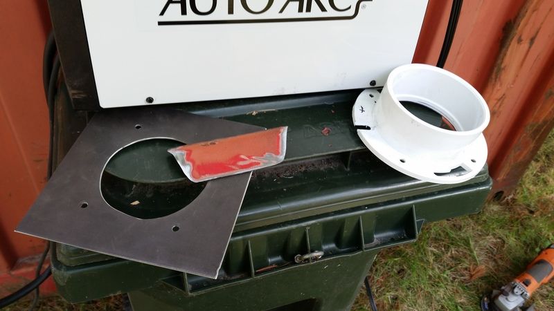

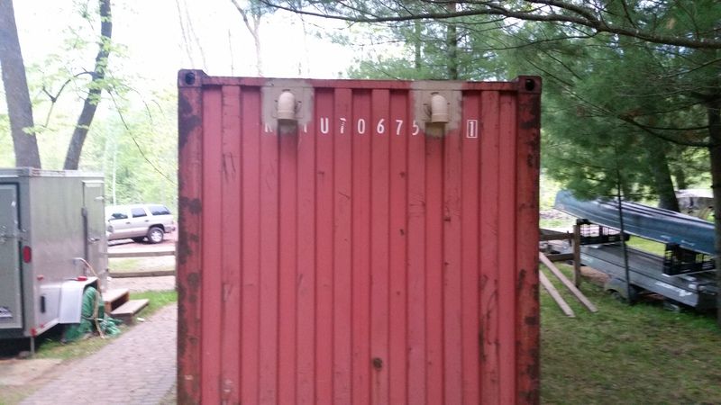

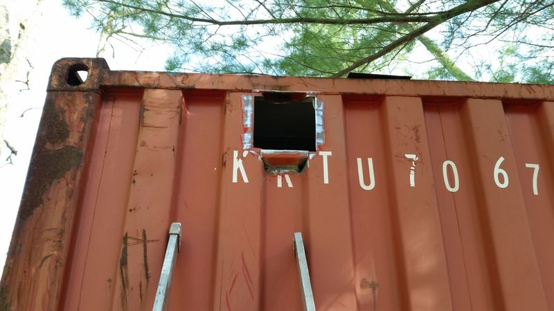

Jim how many inches is 2 minutes welding with your Hobart 125?
Maybe 4? Took forever and a whole lot of swearing and shut down time to get these done. 8x8" 1/16" plates.
So much so, that I did them on two different days. Would've been a half hour project otherwise.
Even on the container, the handler was colder than I wanted it. When you turn up wire speed on my big welder, it turns up the heat. When you turn up the wire speed on the handler it just makes the arc suck more. :lol:

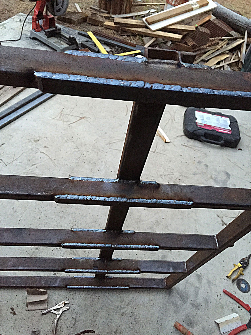

Jim 4 minutes would be bothersome. Maybe it was due to extension cord? Insufficient generator? If you don't supply it with sufficient power, the volts go down and the amperage goes up and I suppose that can cause problems.
These welds, all you can see in this pic, 167 inches were done continuously in 25 minutes on a 20% machine, (on generator) continuous welding not shutting down once. It's a LOT more, and higher heat than those 8x8" 1/16" thick plates. BTW 1/16" thick has a known amperage requirement that is significantly below the Hobart 125's capabilities. You might consider othee deficiencies, that 125 is a good machine. I had a Hobart 115 (or 120?) for a few years in the '90s (pre-internet).
456421d1454970266-welders-welders-welders-167-inches-welding-jpg
I was wiped out though.:shocked: It would take a foreman cracking a whip to get me to do that again.
....no foremans here i'm pretty much unemployable at this point :D
