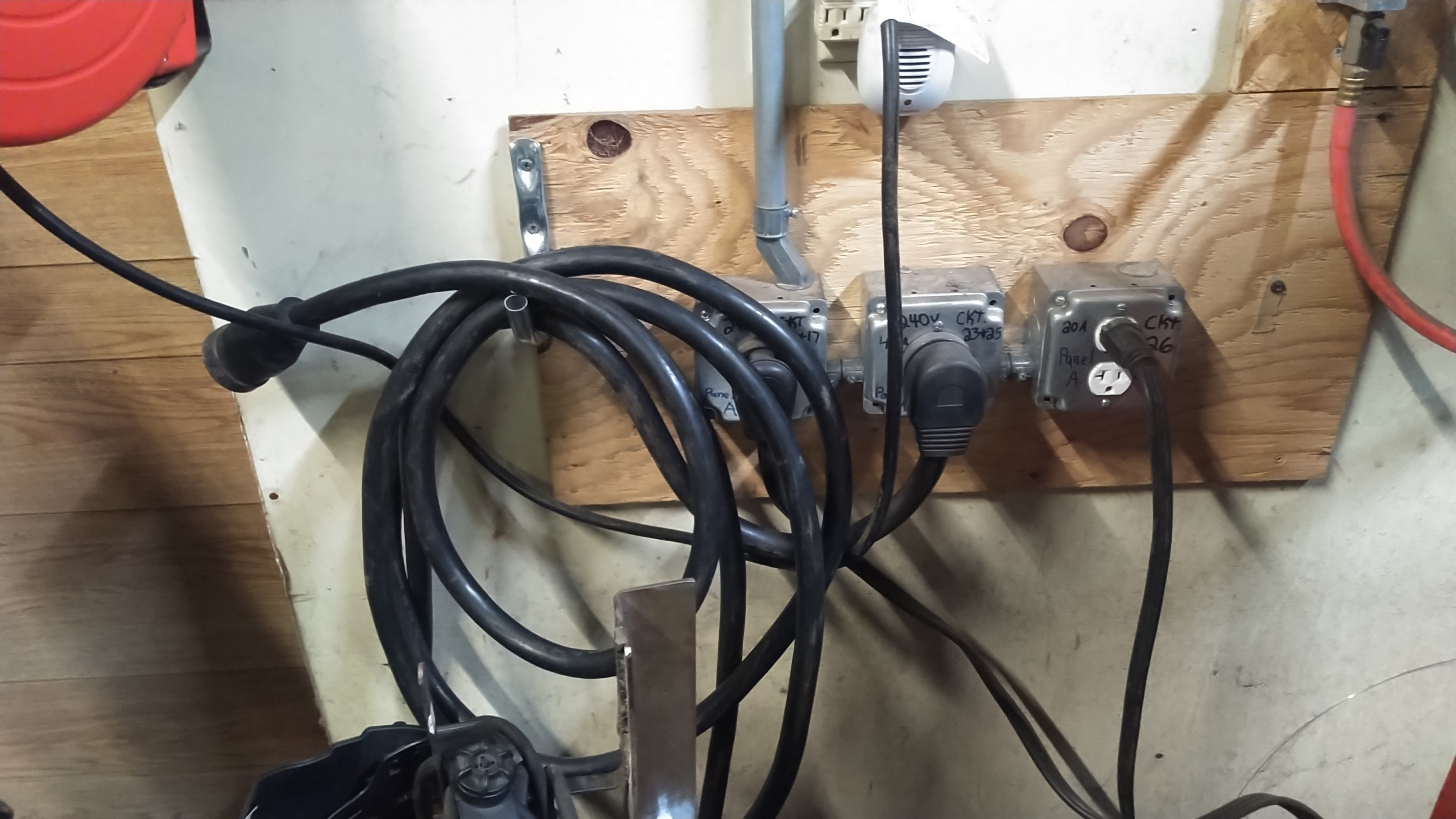

Spring Rummage sales? if your lucky bought this 8 gauge one unused for 25 bucks a few yrs back factory wired with correct plugs so no mods felt a little guilty for only paying that much. It's 25-30 ft use it often.
