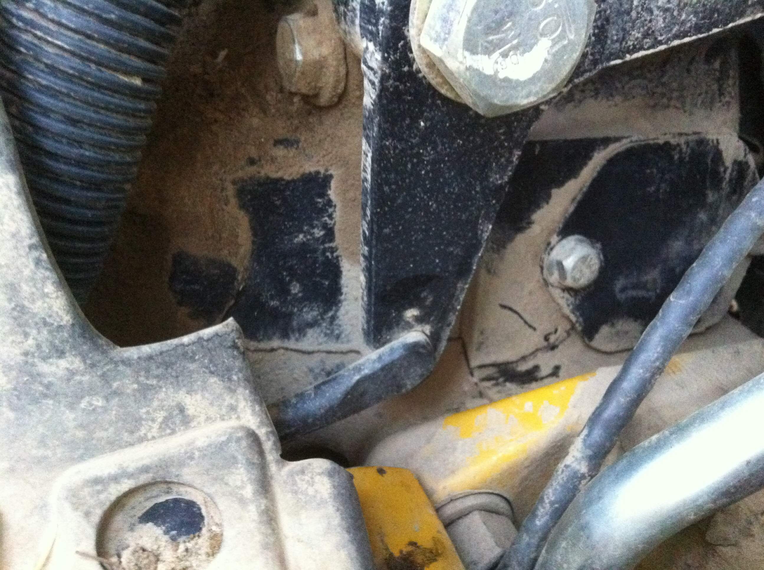

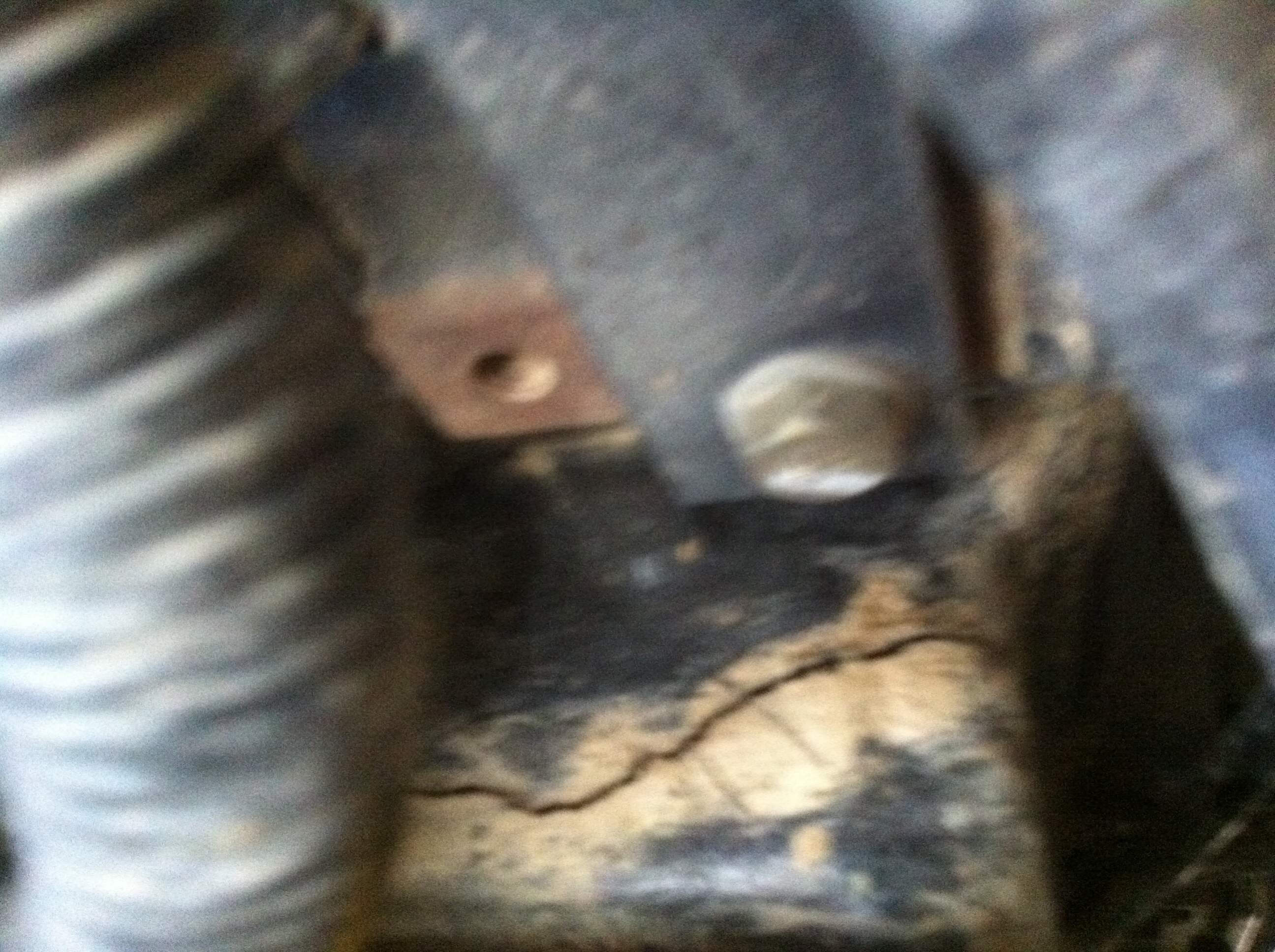

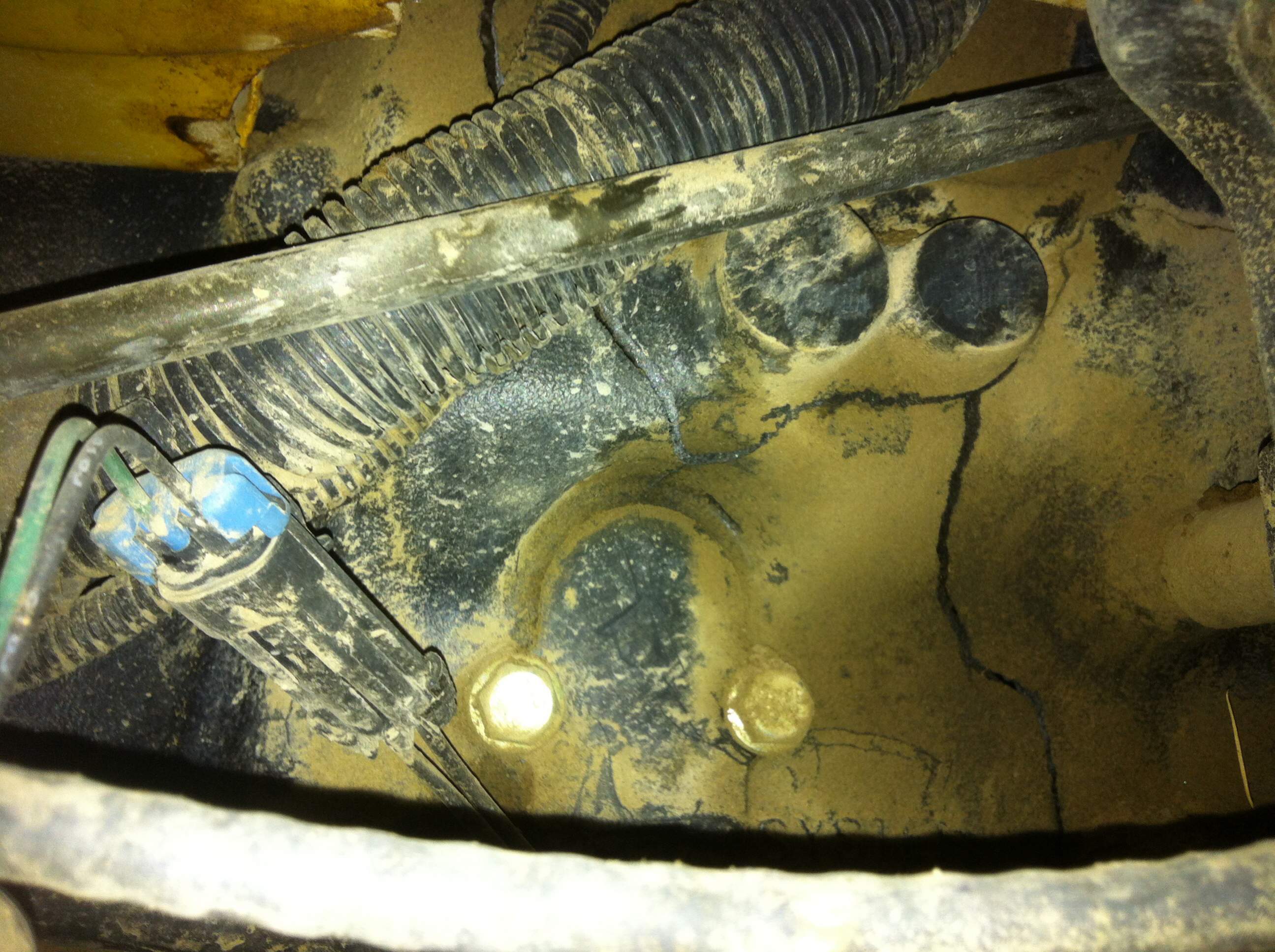

I have been trying to cross reference the part numbers to see if they were on any other machines but I was having no luck. I will try again now. I had a closer look tonight and the cracks propagated from the mounting bolts to an access port, then to up and over the top and down to another access port on the left side. Then horizontal back to the front. It seems to me that on the right side around the mounting bolts there probably was a stress crack there from me carrying too big of logs in the past with the loader or from the classic plowing into a frozen nugget in the winter. Then yesterday working the loader it finally gave way. It's hard to say but there seemed to be dirt in the crack near the mounting bolts and inspection port and clean up and over the top to the other side indicating old and new cracks.
Does anyone know of any tractor wreckers? I will start by searching this forum.
'll have a closer look at it when I split the tractor to see if it can be welded. It does not look shattered and It does hold a magnet so it must be cast steel so a little easier to weld.
Cheers
Kelly

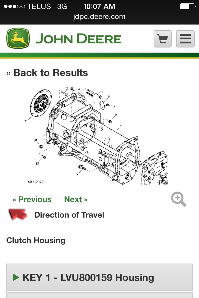

On John Deere's parts diagrams they have a "Where used" search. You look up the part number and then type it onto the search blank. It'll tell you on which equipment the part number is used. It's pretty handy.

The pics you posted would indicate an almost impossible task of welding it back together but the description you give sure sounds as if its even worse than the pics show. I would start looking for a replacement part and forget about repairing. This is one of those that will keep breaking no matter how good the welder who tackles it is. Just too much ground to cover for the type and strength the welds will need to be to hold it together not to mention as others have pointed out the prep work for the welding will be extremely difficult to get right.
Wengers of Myerstown is just over the mountain from me and should be able to help you out with the parts needed.
Good luck with the repair!

If you end up welding these parts, one trick that I have used in the past is to use a needle scaller to peen the welds after each pass or deposit. And I mean a heavy peen. This acts as mechanical stress relieving process. It will minimize distortion. Later.

I have had good luck with nickel rod, but as it has been stated above , u must be meticoulous in your procedure.
/ welding cast housing? #35
I have had 3 of these units they are notorious for this issue I have split all 3 tractors and have had the housings welded costing about 1000-1900 depenfding on how bad the welds were. All worked after and held up as good as the original factory garbage. You abosolutely have to find a welder with the knowledge and capabilities to weld cast iron, this process is a heating then welding heating then welding laborious painstaking process so that there are no bad sections of the weld. It can be done it is cheaper than a replacement housing and John Deere are crooks for putting out such a substandard product I know of at lease 50 of these tabs myself that have had the issue. They should at least pat for housing but they refuse as they slip under the guise that the loader bolts loosen on this machine and as part of preventative maintenance one should keep them tight just like greasing the machine before use. Unfortunately no-one tele you that when yo buy one nor anywhere else other than trial n error or finding out the hard way after the machine splits, you will probably have to check the input splint o the hydrostatic drive pump as when these crack it makes an uneven parallel in the tractor and th only part holding things together is the pump where it connect into the motor. this usually bends or breaks either way if you fix without addressing that issue you will have more problems later.
