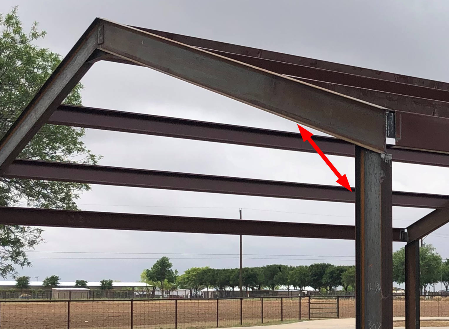

I was watching NOVA great cathedrals and thought of your building. All your stress will be where wall meets truss, a combination of downward and rotational. See arrow in pic
Royking, your picture shows what I was concerned with in my comments

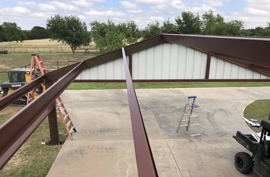

You have probably got some 12 beam left I cut a piece to fit where joist meets post see pic
That is a good idea. Unfortunately I don't. I bought four 30' beams and cut them 17' & 13'. 13' went in the ground and and 17' up top. After I trimmed them to size I had no piece over 6" long.
I did Add some more material to it though.

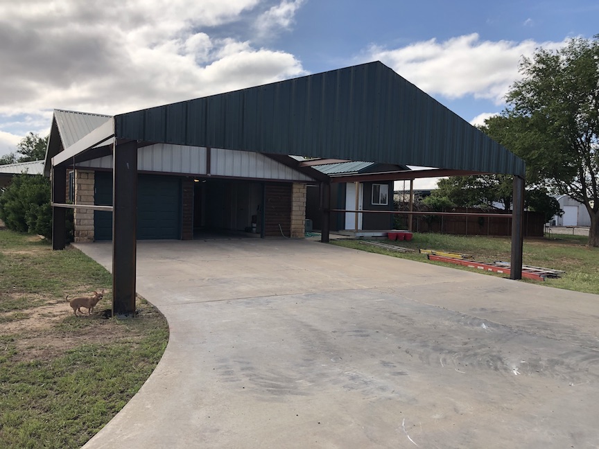

We got the tin on the ends today. Tomorrow if the weather cooperates we will do the roof.

Looks really nice bdog! Is that a Chihuahua getting prepared to christen your carport?

Closing gable in change the whole structure, very solid now
   / Welding I-beams together #37
Looks good, the added material at gable changes beam into a truss

Thanks guys. Now I can sleep better knowing not everyone thinks it is going to collapse.
Yes that is our Chihuahua or our little sewer rat as we like to call her.
