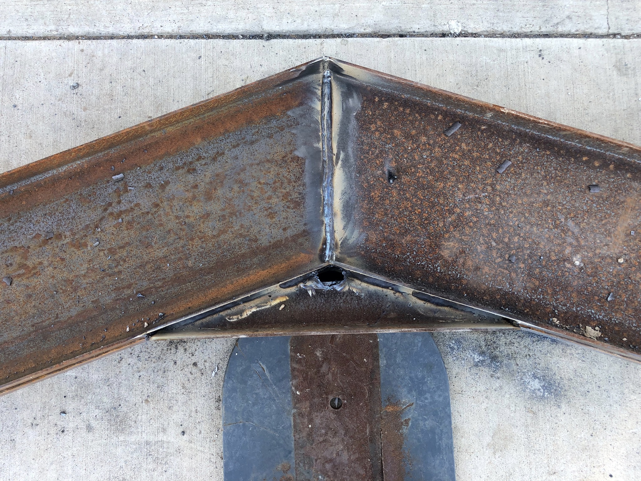

I am building the rafters for my carport. 12” 14# W beam with a 4/12 pitch. Span is 29’
I have built multiple steel buildings but all had a single pitch roof and I have never had to weld beams together like this.
Does this look adequate? I am not sure if I need to fish plate it or need more reinforcements.
Disregard the grey oval plate on the bottom. The beams are just resting on it.
/ Welding I-beams together #2
I am having a hard time telling if the plate is on the side or on the bottom to make a triangle.
Now the picture makes sense to me. I wasn't even seeing it in the right perspective. It looks good to me, but I probably, doing everything overkill, made the triangular plate a little bigger. Even slightly bigger would make a HUGE difference and weld strength not as important.

If the weld shows a root bead on the back side as in pipe line welding you'll be good. If not grind/clean the back side groove with the angle grinder and run a bead in the back. Don't be surprised if the mid section of the beams draw in to give a slight inward bow. Hopefully not.

All your stresses are in the flanges not the web. Your picture only shows the web.
The question is if you have to ask people on an anonymous tractor forum if your structural welds are good enough for a building then you probably have bigger worries like ‘is this building going to fall on my head - or my grandchildrens heads - or the neighbors...’

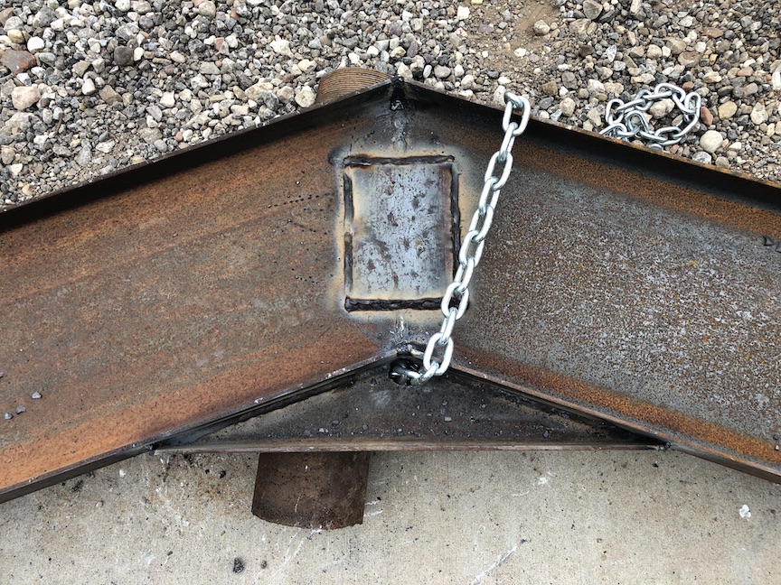

Mine are similar and they have fish plates anywhere the I-beams are joined. Good luck with the new building.

My 57 X 48 "L" shaped shed has a welded frame,, I fish plated every joint I could,,

You have picture if welds on web. Flange will have highest stress.
Because of the angled joint , you will have buckling stress in web.
Both areas should be reinforced with fish plates

I added some plates on the side. Coupled with the extra portion of an I-beam on the bottom I think it should be fine. I stood each truss up vertically on the ground and got triple pass welds across the top flange and on the insides of the bottom flange.

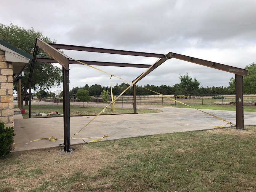

We got the trusses in place today. Only got two purlins up before we had to call it a day. Hopefully will finish most of the welding tomorrow.

How are beams attached to columns?
The beams are sitting on top of the columns (which are made of the same material) and they have 40” of weld securing them.

Now that I see the erected structure, I would say the welds in question are quite important. If the outer ends were erected so they had no place to go outward, then there would only be compression between the two beams at the top.
