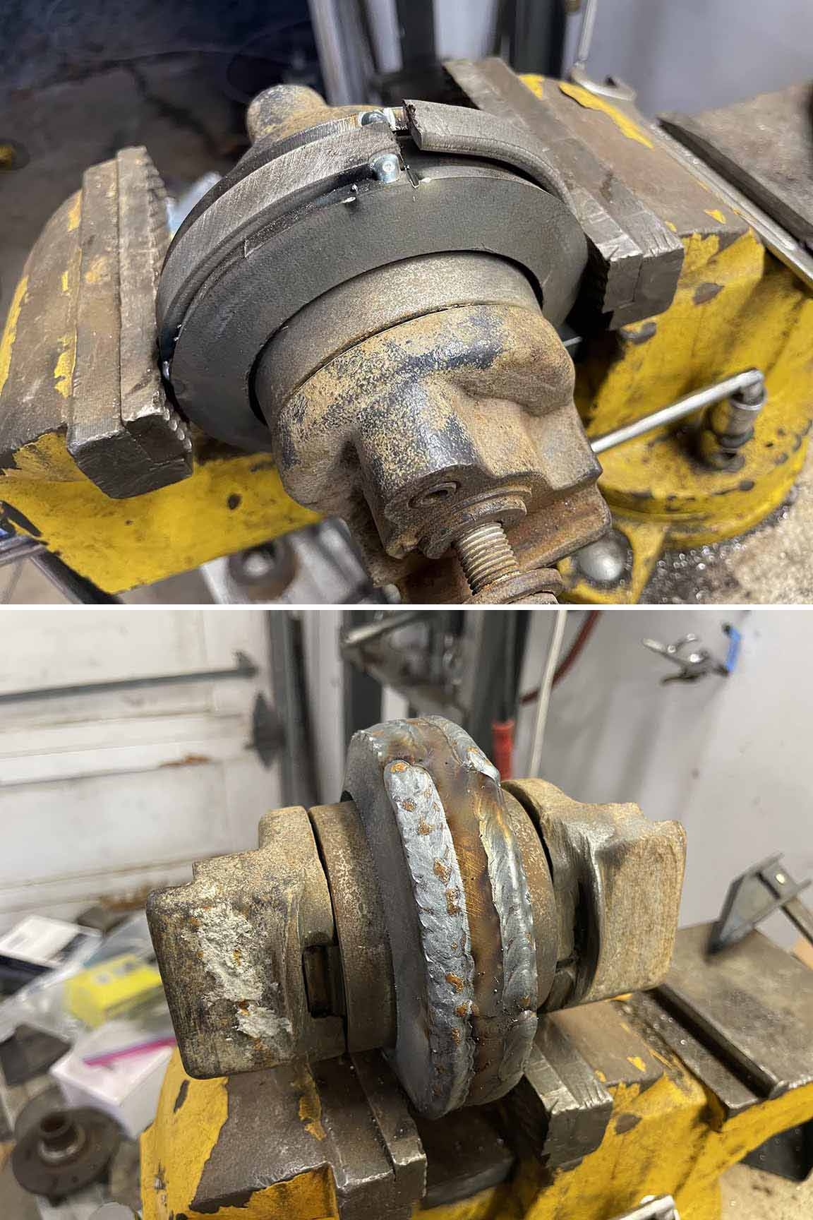

I just built up the worn surface with the MIG by going around the idler.
But now you got me curious🤔...... did I "spray weld"?🧐

Might have been easier and probably no more expensive to have bought some flat stock, and bent it around, and welded it, rather than using all mig wire
Often, using what you have on hand....
is hands down better than getting in the truck in search of possibly better materials.
It took 52 minutes to weld that
------- from "hmmmm..... to done.
No way could I get in the truck and drive to the metals store that quick.
I wrapped these track bottom rollers though.
Same track problem ( fairly new "wrong" tracks ) had to widen these rollers to fit the wide track.
You can see wear where the track was eating into the bearing/seal housing.
It took a bit of effort to get those 1/4" discs cut and bevel them. ($70 for 12 discs, arrived in5 days from sendcutsend.com)
It took me two days to get the 6 rollers wrapped.
......but that's two "retired guy days" not weld-pro days.

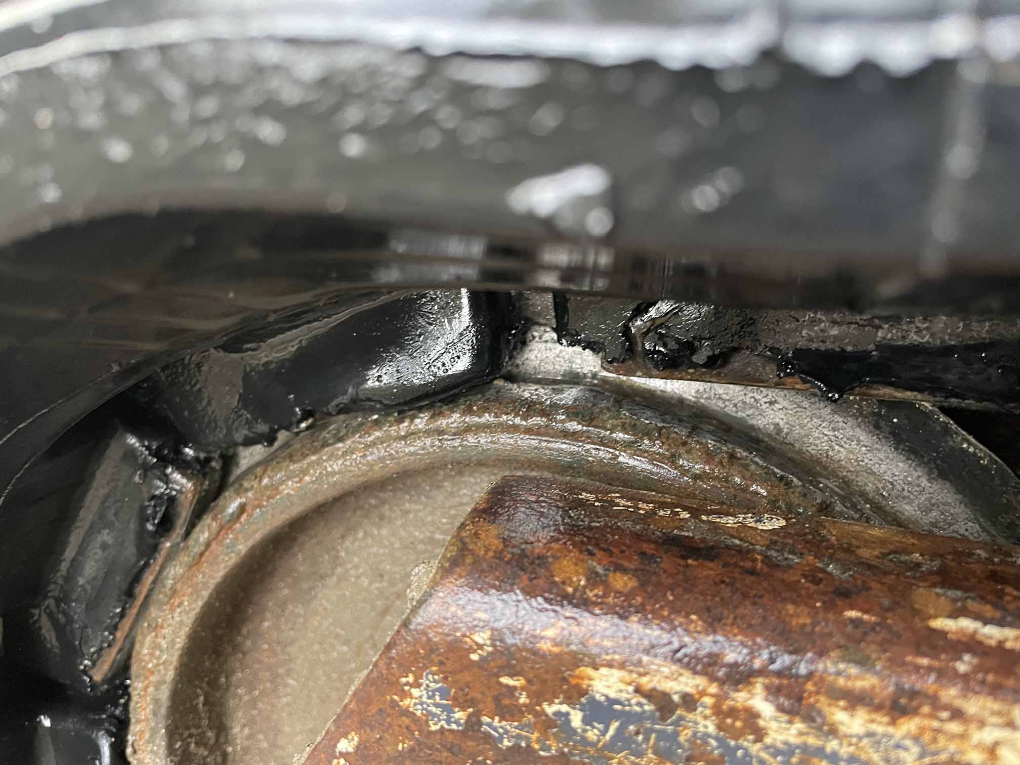

Here's the roller after some hours use.
Maybe 10-15 hours in sand.
You can see the old diameter.
That's two wide beads of MIG ER70 wire.
It took 52 minutes to do one bead on the other side, and two beads on this side.
That's not too bad! 👍🏽👍🏽
But this is a micro-excavator (2 ton) and the idler wheel is only about 9 inches diameter.
Sorry this is the best view I can get without taking the track off.
Next time I'll put a bar in the track and maybe it will lift off and be more visible.
