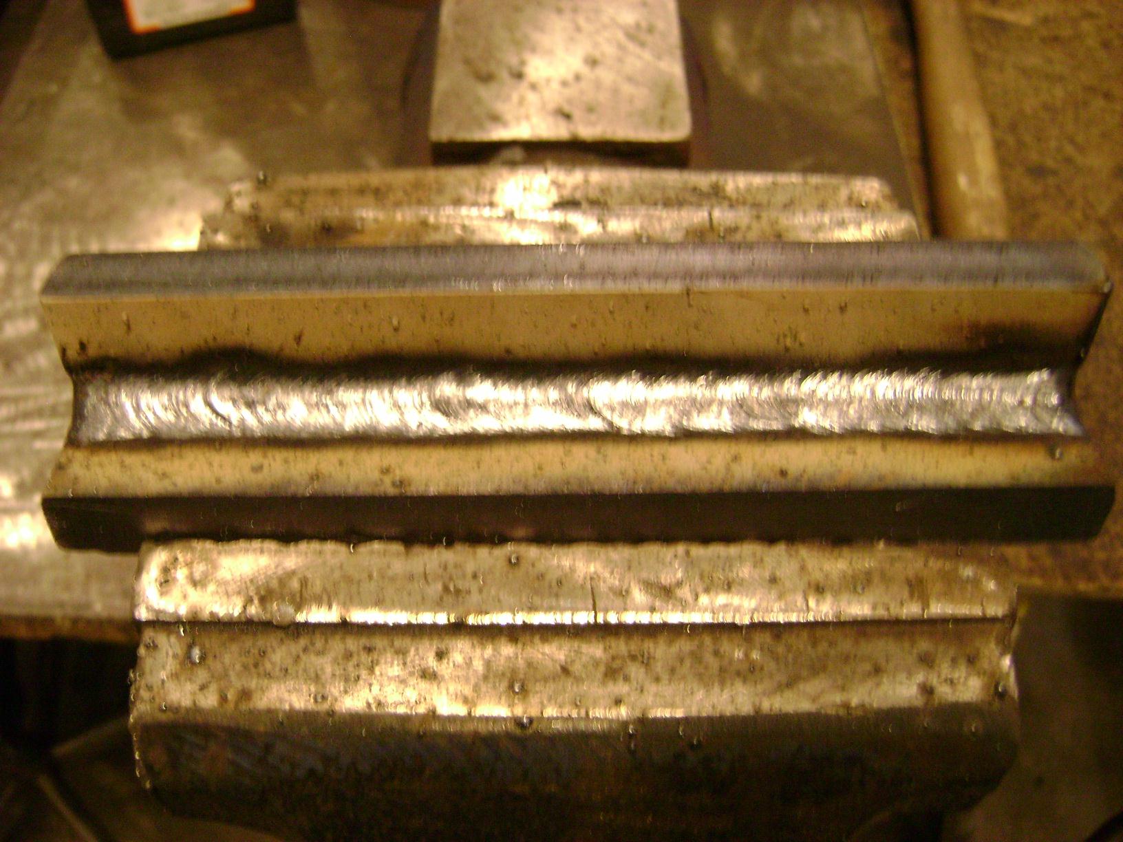

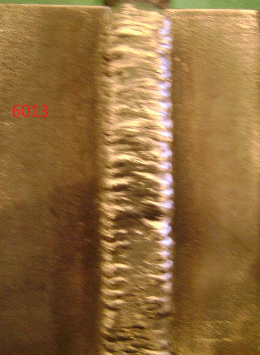

The only rod we have mentioned that will benefit at all from a rod oven is 7018. The cellustic rods like 6010 and 6011 actually need moisture to run right. I don't have a rod oven for my 7018. Would they do a bit better hot? sure they would, but I don't make X ray welds, and I keep my 7018 in a gasketed sealed rod holder and call it good. I make an effort to not take out more 7018 rods than I will use right away and keep the container closed as much as possible, especially on high humidity days. Keep some silica gel packs in the rod holder. Don't worry about the rod oven daugen, you can get by just fine as a home welder without it.
