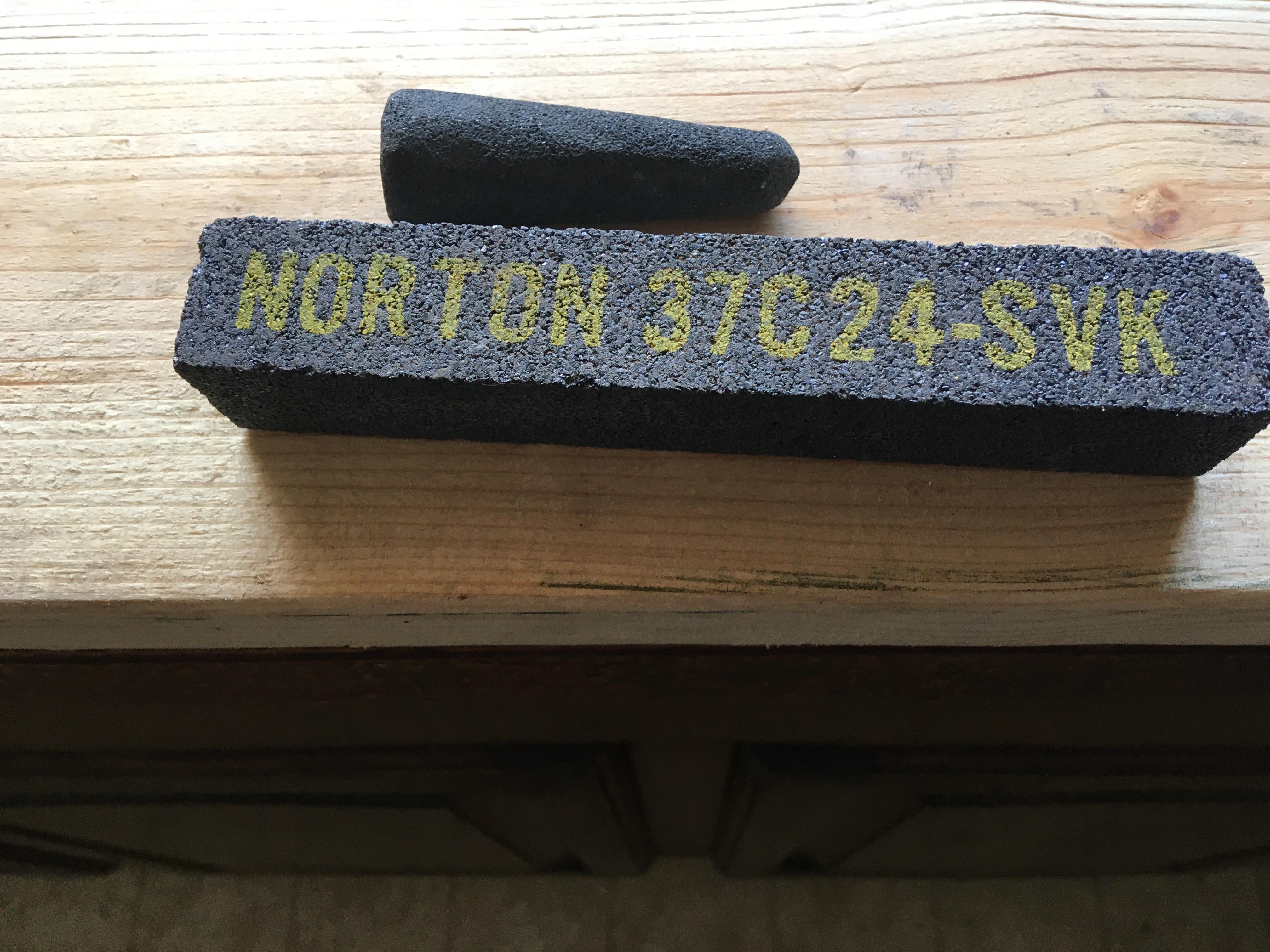

I still use an abrasive cut-off wheel. Common error is to force the cut. (Its a grinder, not a saw.) This can load up a wheel on some metals (soft steels, alum, yellow metals). Use your dog turd (rounded/abused wheel dressing 'stick') to touch a spinning wheel and keep the grit open. If a grinding wheel ever slows down on you, then you ain't no grinder, either!

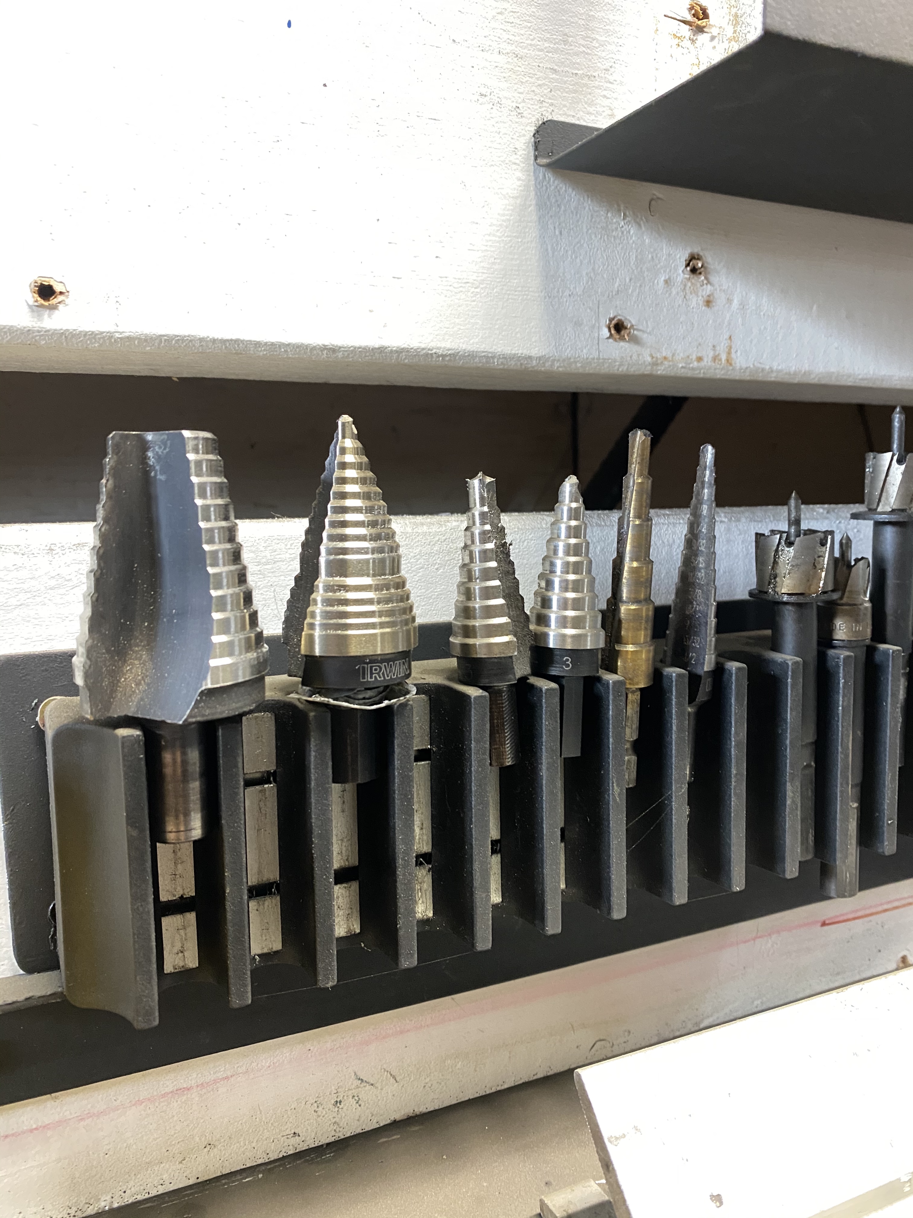

I always use a small step drill for holes in angle iron including questionable quality bed rails. I usually add a spot of coolant but for thin stuff perhaps it isn’t even necessary. Oldgrind would shed better insight.
Two inch and wider angle iron I will punch in the ironworker. (Along with anything else that fits)
