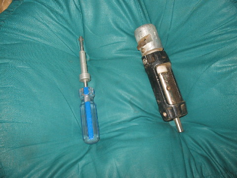

OK AND IF U R SO SPLICIN WISE???TELL ME WAHT THESE 2 TOOL'S R????
P.S...............REVERT TO PAGE SIX ON THIS STRING!!!!...DON'T EVER COME ONTO A STRING AND THINK THAT U KIN KNOW IT ALL TILL U READ IT ALL!!!! /forums/images/graemlins/grin.gif /forums/images/graemlins/grin.gif /forums/images/graemlins/grin.gif /forums/images/graemlins/grin.gif /forums/images/graemlins/grin.gif...WE HER AT TBN GENERALLY DO HAVE IT COVERED ...YOU'LLL JIST HAVE TO TRUST ME ON THAT ONE !!...so kindly go back to page 6 and maybe u oughta go back to page one and read the whole thing stead of jis jumpin in..
all my bestmy new found friend and hope to see u and flea likr soon /forums/images/graemlins/confused.gif /forums/images/graemlins/confused.gif /forums/images/graemlins/grin.gif /forums/images/graemlins/grin.gif /forums/images/graemlins/grin.gif /forums/images/graemlins/grin.gif /forums/images/graemlins/cool.gif /forums/images/graemlins/wink.gif /forums/images/graemlins/wink.gif.....so come on mr makea conektor krimper!!..wut r day??? /forums/images/graemlins/blush.gif /forums/images/graemlins/blush.gif /forums/images/graemlins/blush.gif

and by the way ???tell me what these r???

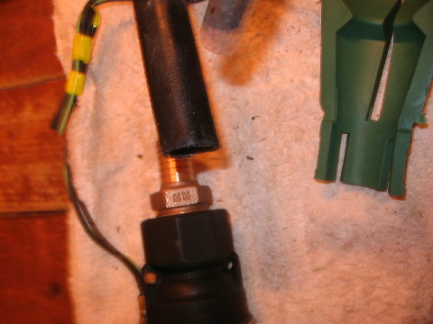

OK GUYS !!!!!!!THIS IS THE BIG DAY SO STILL HAVE ALOT OF TYPIN TODO!!!!..AS WE SPEAK !!! OUR HERO GMAN IS AT HOME DEPOT PICKIN UP HIS GEN...SO HERE GOES THE FINISHIN TOUCHES ON THE INSTALLLATION!!!
This pic is of the attachment of the pipe to the pump...sorry if this pic is a little shaky!!!....can anyone see the mistake i made here.......?????when making the wire splice i forgot to puton the 2 clamps for the 1" pump brass and the 2 clamps for the bottom torgue arrestor!!! good thing the come apart eeeeehhhhhh /forums/images/graemlins/grin.gif /forums/images/graemlins/grin.gif /forums/images/graemlins/grin.gif /forums/images/graemlins/grin.gif

Ok !!!! now were heating !!!!!!!GENTLY !!!!THIS STUFF BURNS REALLY EASY!!! up the 1" black plastic well pipe...in order to attach it to the male ribbed brass fitting on top of the well pump after gittin it nice and warm jist slide the pipe over the nipple and calamp it down quick..the soft plastic will literally for to the serrations of the bralss nipple and harden to fit them...don't clamp down too hard with the pipe being soft....as it can literally cut the pipe..i u mess up it's ok..just cut 6" off the pipe and do it again...as i stated b4...do not scorch the pipe /forums/images/graemlins/grin.gif /forums/images/graemlins/grin.gif /forums/images/graemlins/grin.gif...and be sure to put one clamp on one way and one the other so they are tightening in opposite directions /forums/images/graemlins/wink.gif /forums/images/graemlins/wink.gif...tape all clamps up real weel to prevent chaping of the wire..also at yer mid line splice be sure to leave a little slack or belly to keep the wire from rubbing on the connection...tape the wire directly above and directly below any splices in the pipe...this also goes for the thrust boots....and i would liberally tape the wire under both clamps of the thrust boots too as the wire literally has to run UNDER THE CLAMPS HERE...SO TAPE THE WIRE..THEN TAPE THE WIRE TO THE PIPE WHERE THE CLAMPS TIGHTEN DOWN OVER IT...PUT ON THRUST BOOTS..TIGHTEN CLAMPS...AND THEN TAPE CLAMPS.... /forums/images/graemlins/wink.gif /forums/images/graemlins/wink.gif
