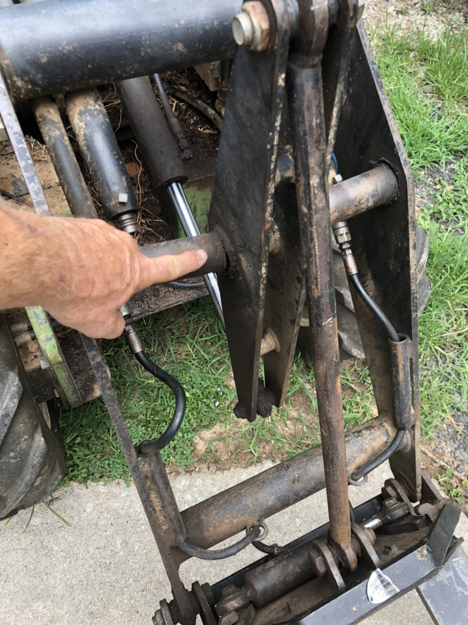

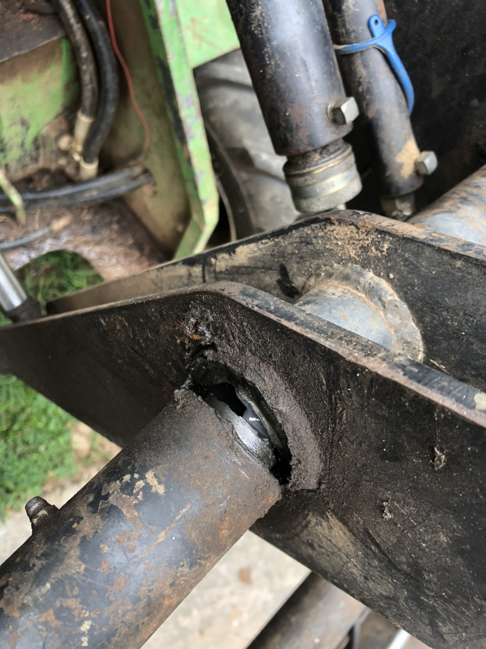

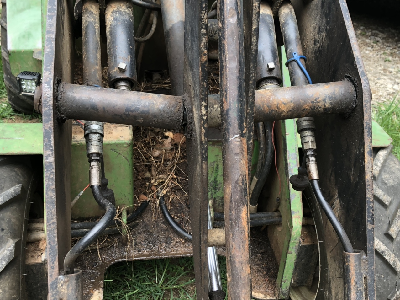

Went to lift a tote of wood heard a pop and my forks would not tilt. Upon closer examination i discovered the pivot point on my lifting arms thatcontrol the machine broke….
I guess it did pretty good considering its a 2001 model. 21 years is a pretty good run i think. I wonder if i can get it repaired or i have to order a whole new assembly. I will call PT. On monday and find out.

Looks like the tube and the internal rod broke as well. Ouch.
You might be better off just getting the entire assembly VS repairing it.
   / Well i broke it this time #3
Sorry to see/hear about it this. I asked Terry at PT about the repair once and he said that the "repair" was replacing the whole assembly.
Speaking as an amateur welder, the repair is not simple, as you would have to cut the right side completely off, cut the pivot arm off, weld it back together in alignment, put a new pivot rod/pipe in and weld everything back up. Do-able, sure, and way beyond my abilities, and I suspect you would need an above average heavy equipment repair guy to do it.

You don't have too much to loose trying to weld it back in place. If it dosent work, you buy a new one.

I welded mine back together before it broke. That was many years ago. You could add extra bracing.

The outer tube is nothing but a spacer, get a good grade of steel bar for the inside weld it up.... It sure looks dry inside, lack of grease maybe the cause...... Jim

I disagree that it’s only a spacer.
My guess would be the pin runs the full width of the FEL arms outer edge to outer edge. The tube runs the full width of the FEL arms inner edge to inner edge, with breaks where the pin passes through the roll over arms. My guess is that the tube is DOM (drawn over mandrel) tubing and it’s inner diameter is only a couple thousandths larger than the outer diameter of the pin. It’s a foot long simple bearing. That’s why there are grease zerks on both sides of the tube: To put grease between the pin and the tube surfaces.

Well what i am doing is i removed the old pin and removed the center pivoting arm assy. The pin in my assembly is 1.234 thick. I purchased 2 foot of 1.5 in roll stock used to make rolling pins on heavy equipment from my local metal fab. Shop. Brought it and the pivot assy to a machine shop, they are going to turn the pin down to fit the pivot assy and then they will install roll pin into pivot assy to align the broken side, align back to original position and weld back together. The roll pin stock was $35.00 the machining and welding $100. Which entails machining the pin, welding pivot arm and welding pin back in place on machine, i think it is very reasonable. I could buy pivot assy. from PT for 165.00 Plus shipping, so it would be around 200 ish im guessing, so i think i am coming out ahead going this route. Plus i am doing good for the environment, im recycling lol.
