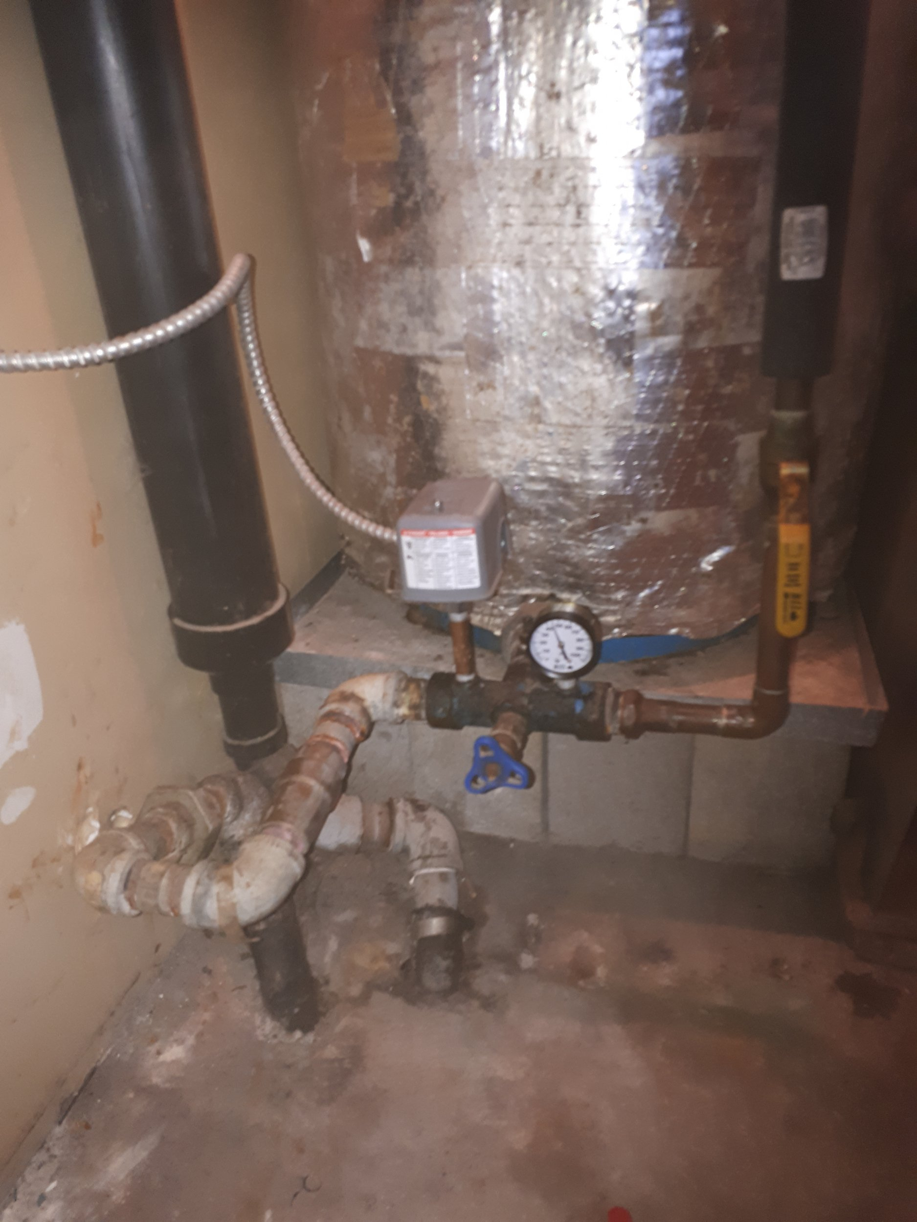

So I have been worried my water pressure is too high in my house. If I can trust the pressure gauges ( one at entrance to 30 gal pressure tank and one near carbon and string filter setup) when well shuts off with the 20 /40 pressure switch at 40 psi, the well pump clearly can be heard to shut off, but the pressure gauges continue to rise and even out around 80 psi ( if I can trust the gauges) I got a new gould 240 volt submersible well pump 2 years ago that replaced a 20 yr old one, my well is 30 ft deep spring) I did try adjusting the two nuts on the pressure switch and now have it turning well pump on at around 15 psi , if I can trust gauges , and well pump shuts off at 40 psi, but pressure continues to rise to at least 75 psi. What do the well experts here think is going on ???
Pressure is pressure however if you have restricted flow pressure will still read without issue. I have replaced two 4” well pumps one from lightning strike and another from bad foot valve. Rule of thumb when you replace pump you change pressure switch. Relay contacts wear over time pressure can change. I run at 20/50 switch however I have large bladder tank to handle drop. Also bladder tanks go bad either rust or bladder failure. You can tell real quick on air input valve. If you press the center of the valve and water leaks the tank needs replaced. Ask your plumber these questions while he is there. I had to learn the hard way myself. I deal with fluid pressure every day in the liquid paint business. Pressure is pressure unless line is 100% plugged. Flow is completely different on restricted line pressure is constant. Hope you get your answers.

My process would be to first verify that the points in the switch are actually opening and not welded shut.
Then I would verify the pressure with a known gauge, either by replacing one of the existing ones, or at a hose bib.
If a problem really exists, the first thing I would look at is the 1/4” nipple that mounts the switch, and the inlet to the switch itself. Then spiral outward from there.
As far as having two gauges, I’m reminded of the old proverb that a man with two watches never knows what time it is.

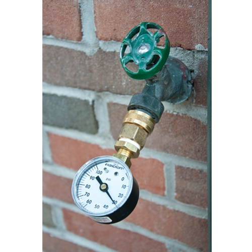

Plumbers are here right now, they replaced gauge at tank, .....it still went high pressure, ....so tested with plumbers tool gauge at hise bib and it is a true 80 psi, not good, ....feels pressure switch could be not working right, so replacing that now......fittings were fairly clean fo both . .....will let uou know outcome.

Mystery SOLVED !!! .....although you can't see it in my first picture yesterday ( hidden under old pressure switch) there was a small ball valve that the original house owner put in so he could easily isolate the pressure switch and the tee ed off gauge. That ball valve was severely constricted. So as can be seen by the pic attached , My plumber removed that little ball valve, and replaced with straight nipple to new pressure switch and repositioned new gauge over to the 1 in feed tee. . So now I have a new 30/ 50 psi switch, a new gauge and no feedback pressure. Well turns on at 30 psi and off at 50 psi and does not gradually increase further anymore. He did test the switch with amp meter and also emptied pressure tank and tested its psi at its shraeder valve ( no water pissed out at shraeder) It is 10 psi low so when I get chance I will get compressor and get it up to 28 psi like plumber suggested. Thanks everyone ! I think my urging my plumber about suggestions I got here helped us keep bill at only $600. And now I can do it on my own if ever again. 20220607_135247.jpg

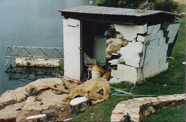

Even without the ball valve to the pressure switch the nipple itself could clog. This happens all the time. You need a 75 PSI relief valve in place of boiler drain or on a 3/4 tee with the boiler drain. The relief should have been popping off long before your tank pressured up to really high pressure. I have seen the bottom blow off tanks like that, making it a rocket and going through the roof, taking some of the plumbing with it. Pressure relief valves are important.
   / Well pressure Switch question #32
Here is a picture of a cinder block well house where that happened. However, in this case the tank went sideways instead of through the roof. You can see the tank floating in the lake at the very top of the picture. The explosion woke me up from a room about a 1/2 mile away.
