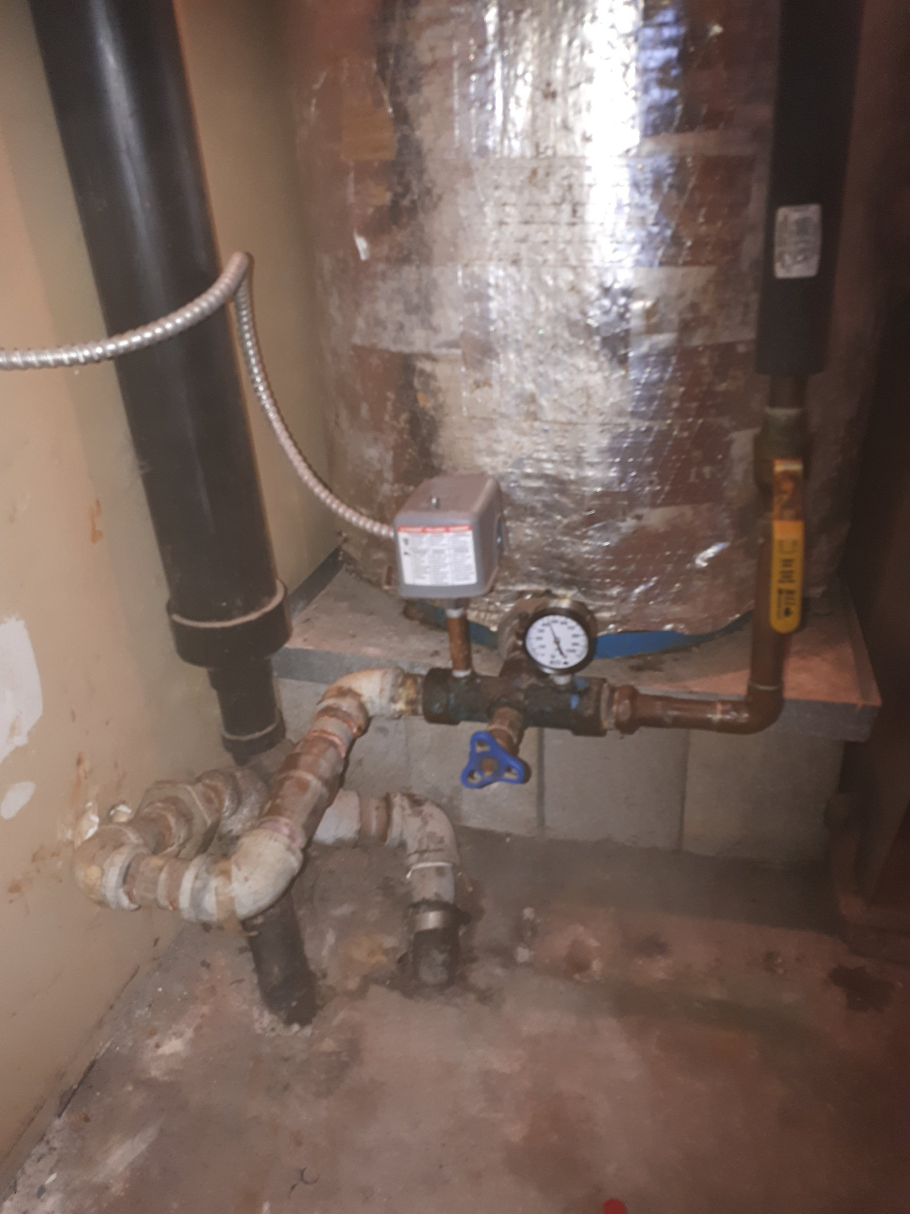

The relief valve on water heaters is usually set for 150 PSI. Most well pumps cannot build 150 PSI and would not be able to utilize that relief valve. But some can build 120-140 PSI, which could blow up a 100 PSI rated water pressure tank. I use a 75 PSI relief valve with any 40/60 pressure switch. It is good to keep the tank from exploding. But the main reason is to dump some water to keep the pump cool in case the pressure switch does not shut the pump off at 60 like it should as in this case. Yes you can run a pump against a closed valve without hurting anything. But if no water is let out it for some time it will boil around the motor, destroying the pump/motor and possibly melting any plastic well casing.
/ Well pressure Switch question #42
Just remember; when you reset your cut-in pressure/air pad, this MUST be done with system OFF and tank WATER open to atmosphere - your plumber would've mentioned this if he's any good, but it's an easy thing for inexperienced people to forget. Generally the air pad should be 10 psi BELOW the cut in setting (a 40-60 psi setting should have air only at 30 psi) ... Steve

How many GPM is your well capable of producing? Let's say your well is capable of 4 GPM. It is entirely possible to have a pump that is capable of 20 GPM and under a water demand may in fact run your well casing dry. To eliminate the overpump possibility, there is frequently a restrictor in the line from the well to the system, is that what the blue handled valve is to perform or is the (for lack of better terms) "flow restrictor" at the well itself?
One of my wells is capable of 10 GPM maximum flow per well log by driller. I free flow from the pump only 10 GPM by restricting the flow with a gate valve and secure the gate valve handle so it cannot be moved or adjusted. I then flow to the pressure tank with the pressure control switch attached to the manifold. My line from the well may, and likely does, exceed the 60 PSI switch pressure but ultimately I am concerned with the pressure in the tank itself.

Thanks for input Repete.... but as seen above the problem was identified and solved. of note.. a very well respected Well company replaced rhe well pump 2 years ago and my system worked great for over a year and a half, but my high iron/ mineral content bit me in butt of late and constricted a valve that was actually not necessary ( see above earlier resolve described) so all is good now. I imagine lessons learned for many .

I know you don't want to hear this. But that same iron/mineral that clogged the valve will just as easily clog the pressure switch itself. Just like you saw last time the pressure will increase to as much as the pump can produce. If is doesn't blow a line or your regular "water well pressure tank", it will cause the pump and/or plastic casing to melt. A 10 dollar pressure relief valve anywhere in your piping system is all it takes to prevent catastrophes like that. But I won't say it again.

This one of those times when I wonder why I care and even try to help. I felt bad that my use of the word "boiler drain" made you think I was talking about a boiler. So, I wanted to reiterate how important it is to have a pressure relief valve on a regular water pressure tank. You are the one taking the "holier than thou" attitude. You spent all that money on your "sophisticated Laars high efficiency heating and on demand water heater", and want to believe it is superior. It maybe fantastic but it would still be rare for any plumber to know anything about a well pump system. As was said the pressure relief on a boiler or water heater is set at 150 PSI and will not protect your pump, pressure tank, and water supply system. I don't even need to see 2' of your plumbing system as the scenario you describe would not have happened if you had a proper pressure relief set at 75 PSI. It is obvious your plumber does not "know and understand". But rest assured I will no longer try to help you! Please don't install a 10 dollar pressure relief valve now as I will be waiting for your next thread asking what happened to cause your tank to rupture or the pump to melt down. But what do I know? Have a nice day!

Yep! I can tell all of that by looking at that one little picture. I said I wasn't going to help you anymore so this is for the benefit of anyone else reading this thread. When you live on a well, everything you do is dependent on a dependable supply of well water. You can purchase the fanciest and most expensive boiler/heater and tankliess water heater there is, but if your well system is inadequate none of those things will work as they should, or at least not as well as they should. An instant water heater and everything else in a house works better with constant pressure from your well pump system. Getting the right constant pressure system can also make your pump much more dependable and last many times longer than normal.
There is no need to spend all that money updating the other systems if your well pump still just has a little 20-30 gallon pressure tank and a pressure switch. If your pump guy had to warranty the last pump he put in, he may not know as much about what he is doing as he or you think. If he puts a check valve at the tank but not a pressure relief valve, that is a sign he needs much more tutoring. I wouldn't hold it against my plumber that he didn't notice my inadequate pump system, or that there was a check valve were there shouldn't be and no pressure relief valve where there should be. Just like getting the right constant pressure system, pump guys should know these things, but it surprises me how many do not.
