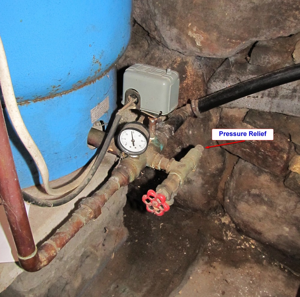

Yup, got a pressure gauge on my system. I have adjusted the pressure switch and the gauge lets me know where cut in and cut out points are. It did take me a bit to grasp how to adjust the switch and I had to read a couple different instructions to get it figured out. Mine has two adjustments. The short one is the differential.
This is pic of what I've got. 44 gallon tank, 1/2hp Goulds pump down at around 280' I installed back around 1986.

Thank you. I might just replace the switch too; because it don't know what it's set at. I do know if running about 20 seconds per cycle; which I didn't think was right. I've got the air right at 28 psi (which should be right for 30/50 switch) but #1: I'm not sure if it's 20-40; 30-50; or 40-60; and I've played with the adjusting nut, so no idea what it is at now.
Do you guys put a pressure gauge in, or is there any benifit? Switch is probably $15; and not a bad job to redo, but I'm wondering if there's any reason to put a pressure gauge inline, and adjust my pressure switch to a good factory setting?
Yes there should be a good quality pressure guage right by the pressure switch, I've never seen an installation without one. It would tell you in one cycle what your switch is set for.
Yep, short one is the differential and it should be adjusted to give 20psi difference between on/off. Tall screw slides the setting up/dow, from 20/40 up to 40/60. Pressures over 60 not recommended for residential use and there is really no need for them. It will give a needle shower, run sprinklers just fine.

Definitely get a gauge in the line and a new pressure switch while you are at it. If you have the normal brass tank tee there should be a spot for the gauge. If not get 1/4" brass tee and brass pipes and install below the switch. Do not use galvanized pipe as that will rust shut in a few years.
This may have been the reason your old pump died - short cycling like that will reduce the motor life considerably.
Yeah, I'm sure it contributed too it. The reason I asked about the pressure gaige, is its not the norm around here at all. Matter if fact, of a about a dozen wells of friends/family; none of them have a gauge. It should be as simple as cutting in a 1"×1"×1/2" pvc tee, and a 1/2" ×1/4" reducer bushing and a gauge. Do I need the gycol filled or whatever? Or will a $3 pressure gauge work?

A $3 one is what I have on both of mine, when they freeze, I replace them with another $3 one, and yes that is how mine are installed.

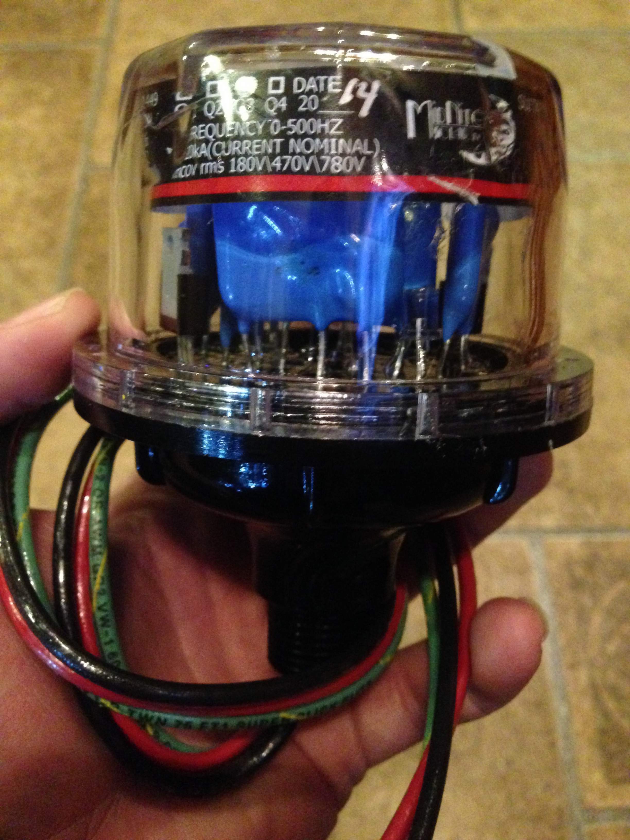

I discovered these little guys while building my off-grid system. They are surge suppressors / clamps -- they essentially give a quicker path to ground when it exceeds a specific voltage, clamping the lighting strike. Very cool! I've installed several of them as required by code, and a few extras on spendy equipment. Installs right into the knockouts on any panel and wiring takes 5 minutes.
This particular one is made for 120/240v applications and will stop a direct lightning strike. Made by Midnite Solar.

I have the same one on each bank of solar panels. I also have Siemens whole house surge arrester. Last year crew clearing the right of way dropped a tree in the power line and resulting surge damaged many electronic devices in about a mile from the substation. Except my house. But the surge protector was virtually melted. Since the utility paid for new one I got the best I could find. http://www.tractorbynet.com/forums/...025-value-good-whole-house-surge-dsc_0020-jpg
