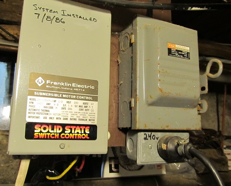

While were on the subject of pumps, wondering if anyone else has their pump electrical feed from an outlet? I did this back when I put the pump in as a means to totally disconnect/isolate the control box and pump from the the rest of the house wiring when I know a thunderstorm is coming. Figured if it's not connected it's less likely to get taken out if a lightening hit causes a surge in the house wiring. The outlet is keyed to only take a special type of plug.
:thumbsup: Excellent idea; I did this as well. We have some intense thunderstorms here in western Arkansas.
I unplug the pump as well as everything electronic when a storm comes up.
Just flipping off the breaker does not completely isolate the device.
