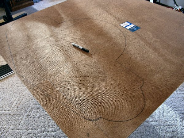

Here's where we're at so far.

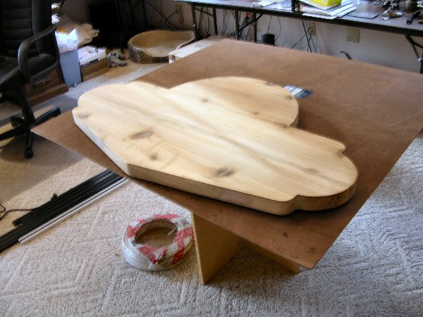

We placed the sign blank upside down on a piece of hardboard and traced around the edge of the blank with a magic marker. Then it was off to the pole barn to cut out the hardboard so that it was just inside the line making it slightly under-size.

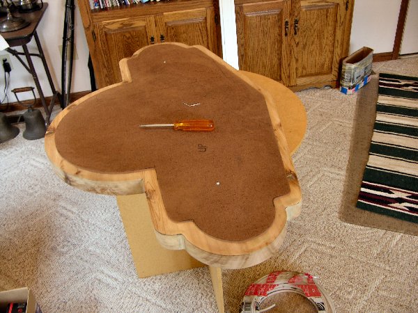

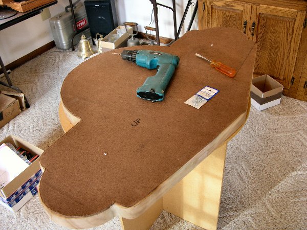

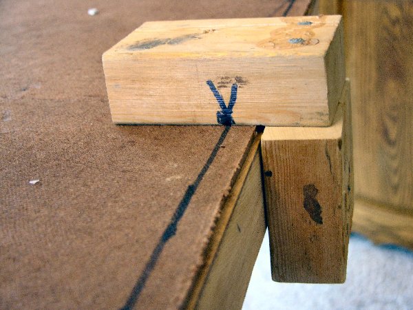

At this point the sign blank was flipped right side up and the hardboard template positioned over the blank. I fastened the template down to the blank to prevent movement.
Then I used a couple of scraps of 2 X 4 lumber and the magic marker, being careful to keep the contraption up against the sign blank to lay out the border that I needed on the sign blank.
Back to the pole barn to re-cut the template and smooth the edges a bit since the router will be running on the edge of the hardboard.
The template is now fastened to the sign blank using the same 2 holes and the blank is ready to be routed for the 1st pass.

What I have done many times is after the template is made. I use a few finish nails just through the template and slightly entering the wood that your routing. Especially is I dont want to spoil the finish on either side. If only one side is seen then I just put a couple of wood screws through the template. I have also used double back sticky tape to hold the template in place especially if Im not routing much material off the wood that Im working on !

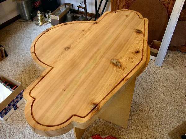

Heres what the sign blank looks like after the first 1/2" deep border cut was made. I got a nice clean cut and the tungsten-carbide bits ate through the knots with ease. Kids remember we're professionals, don't try this at home. :D
