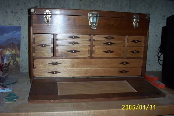

Very nice ! I just want to jump on the template bandwagon:) I use templates with my router and my laminate trimmer quite frequently. A few years ago I put rosewood diamond inlays in the drawfronts on a toolmakers chest. I made a overlay template for the draw fronts and used a follower guide on the bottom of my hand held laminate trimmer to cut out the pockets. All I had to do after that was trim the 1/16" radius from the corners and glue in the rosewood inlays.
You might try your hand at chip carving also, thats alot of fun also.
PS You can use your lathe to make follower bushings !

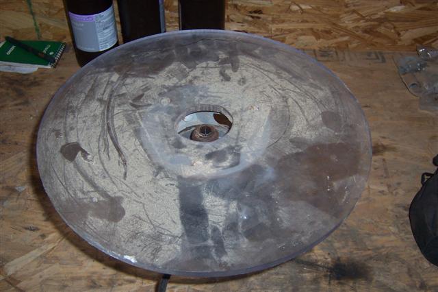

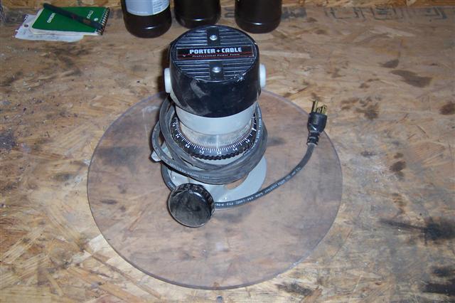

Hey Mike,
I've done a little wood carving and found that keeping the router flat can be pretty dificult. Especially when you remove quite a bit of material. I put my wood onto my shop bench and screw pieces of wood all the way around it. This keeps the wood from moving, but also gives me support for the router base plate.
I also had a piece of plexiglass cut to a 14 inch circle and replaced my base plate with it. You can see it in the pictures I've attached.

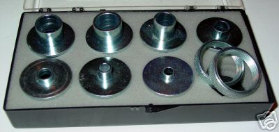

It made a huge difference in keeping the depth of the router cut consistant. Before, it would dip down in places, which made the background uneven. I wanted a perfectly flat background on my carvings.
Eddie

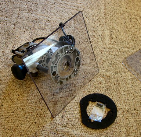

Eddie we think alike, here's what I did.

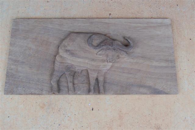

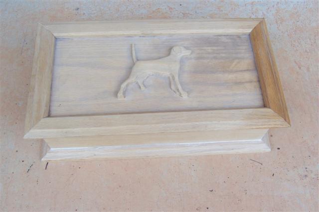

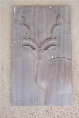

   / We're using a router for a general store sign #38

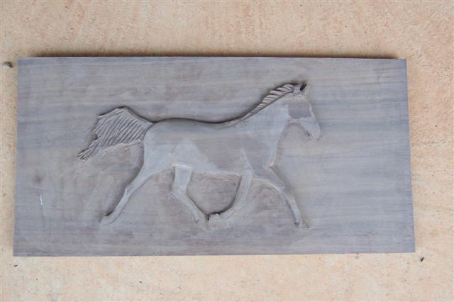

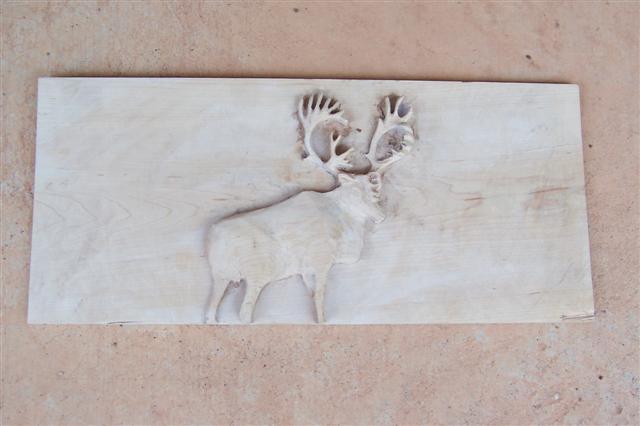

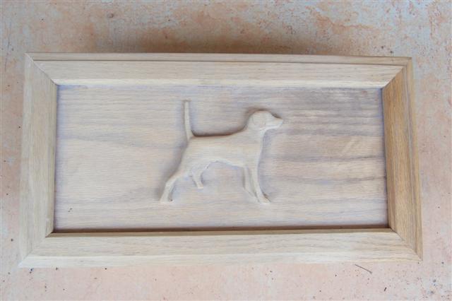

I've never tried to do letters or a sign like you're doing, so I'm very curious to see how you do and it turns out.
My interest in carving is to do animals on flat panels, then put them into the lids of boxes. I've made humidors, jewelry boxes and just plain odds and ends boxes like this.
The first four pics show some of my carvings that are not quite done yet on different woods. The last two pictures show an almost done box.
I used to do this quite a bit, but since buying my land and getting into tractors, I haven't done any carving for awhile.
Eddie

It seems to me that the template guide must have a bit that can retract up into the template guide.
If there is no guide then you can use a bearing on the bit for the template.

Charlie TR this assembly gets bolted to the bottom of the Porter Cable router. You can see one of the router bits extending up through the template guide. The lip of the template guide would ride on the edge of a hardboard template and keep the bit from gouging the edge of the work. The cutter is fully extended just to give you an idea of how it looks, normally you would not be taking such a deep cut.
