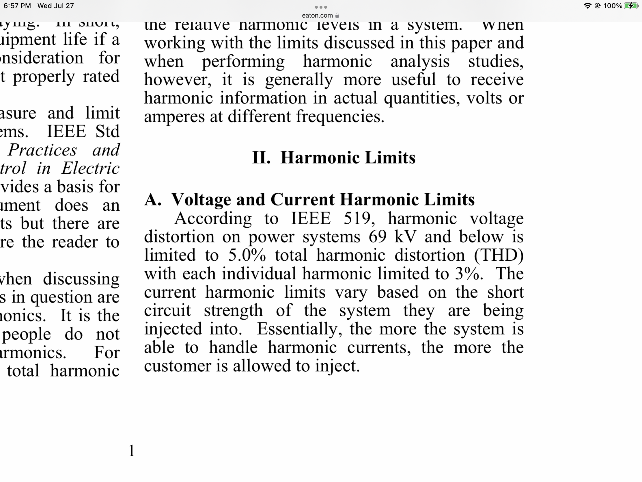

not true...most non inverter conventional generators keep it below 8% THD. My portable briggs keeps it below 6%. Most non inverter whole house units keep it less than 5%.
Inverter units can get it down to 2%. Public utility lines are only regulated to keep it below 5%.
do you actually have a thd meter?
