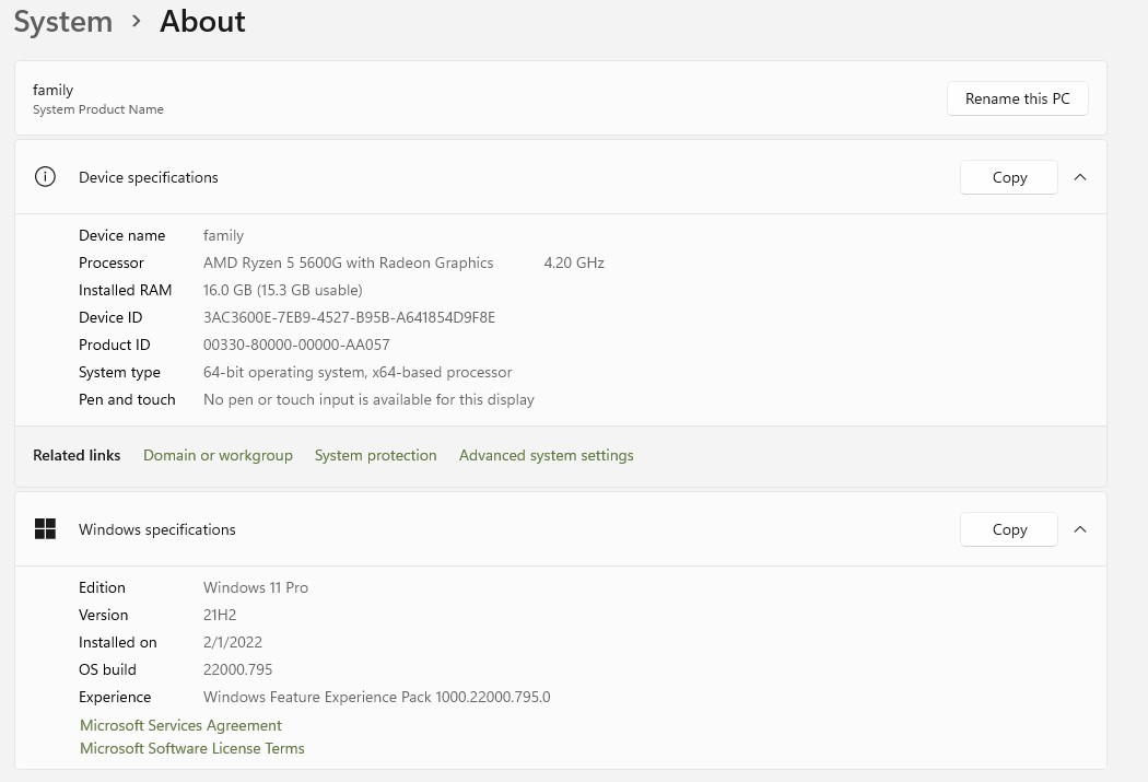

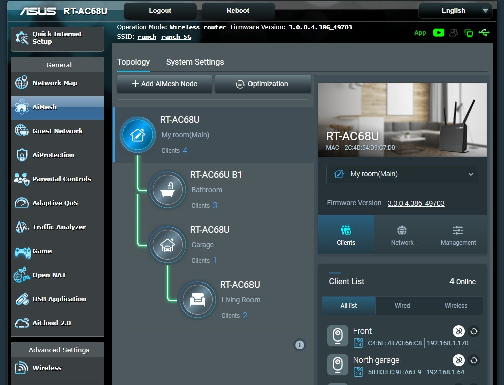

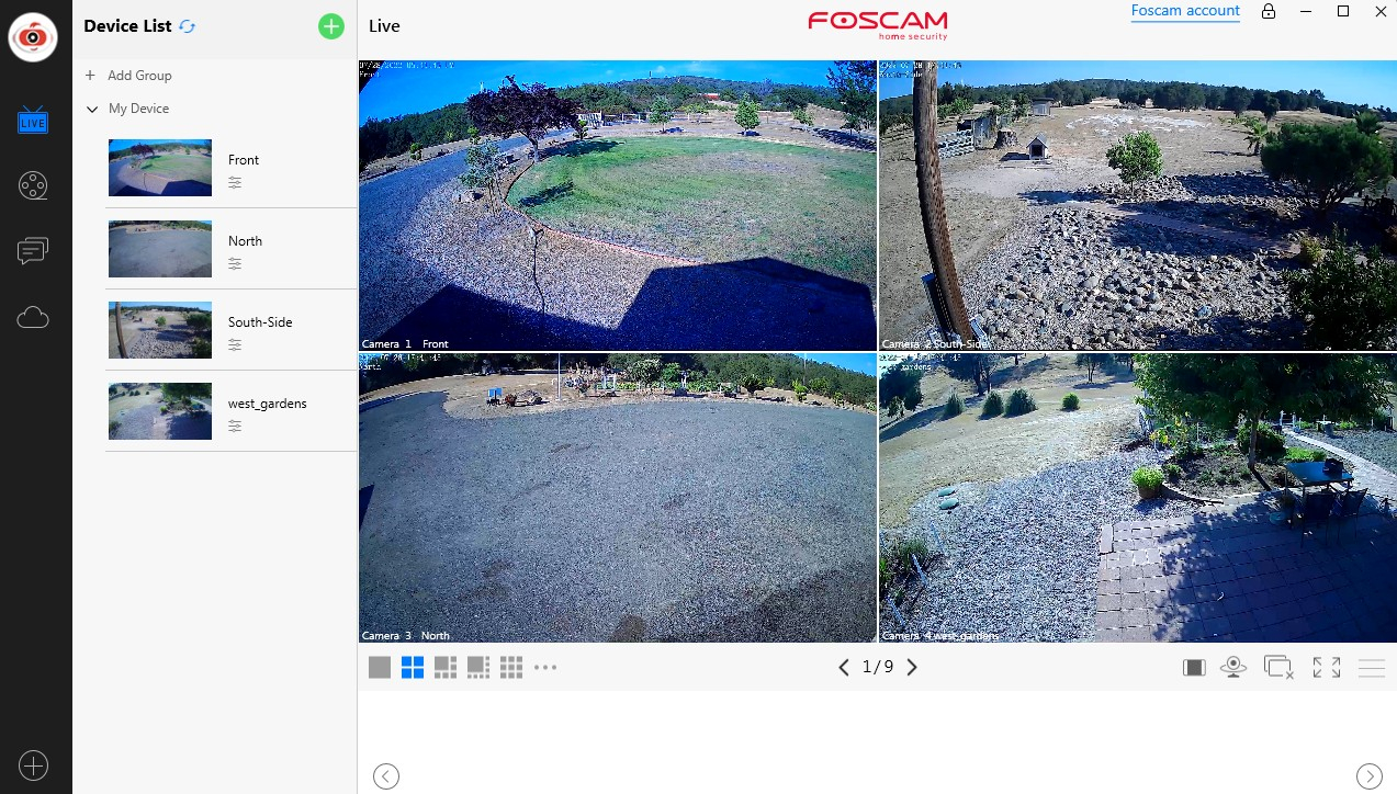

Here are some specific sensitive electronic devices I have and never had any problems with <25% THD generator for the last 15 years.
Of course, I have 3 refrigerators, 1 freezer, a well pump, gate opener, so many rooms and outsize lights etc., all are 110V except the well pump they don't have any problem either.
I am sure and agreed it would be good if the generator had lower THD rate but to me so many people just worry about THD rate too much without any experience.
JKK
High advanced computer built on Feb 2022
4 routers for AI mesh system
6 security cameras.
