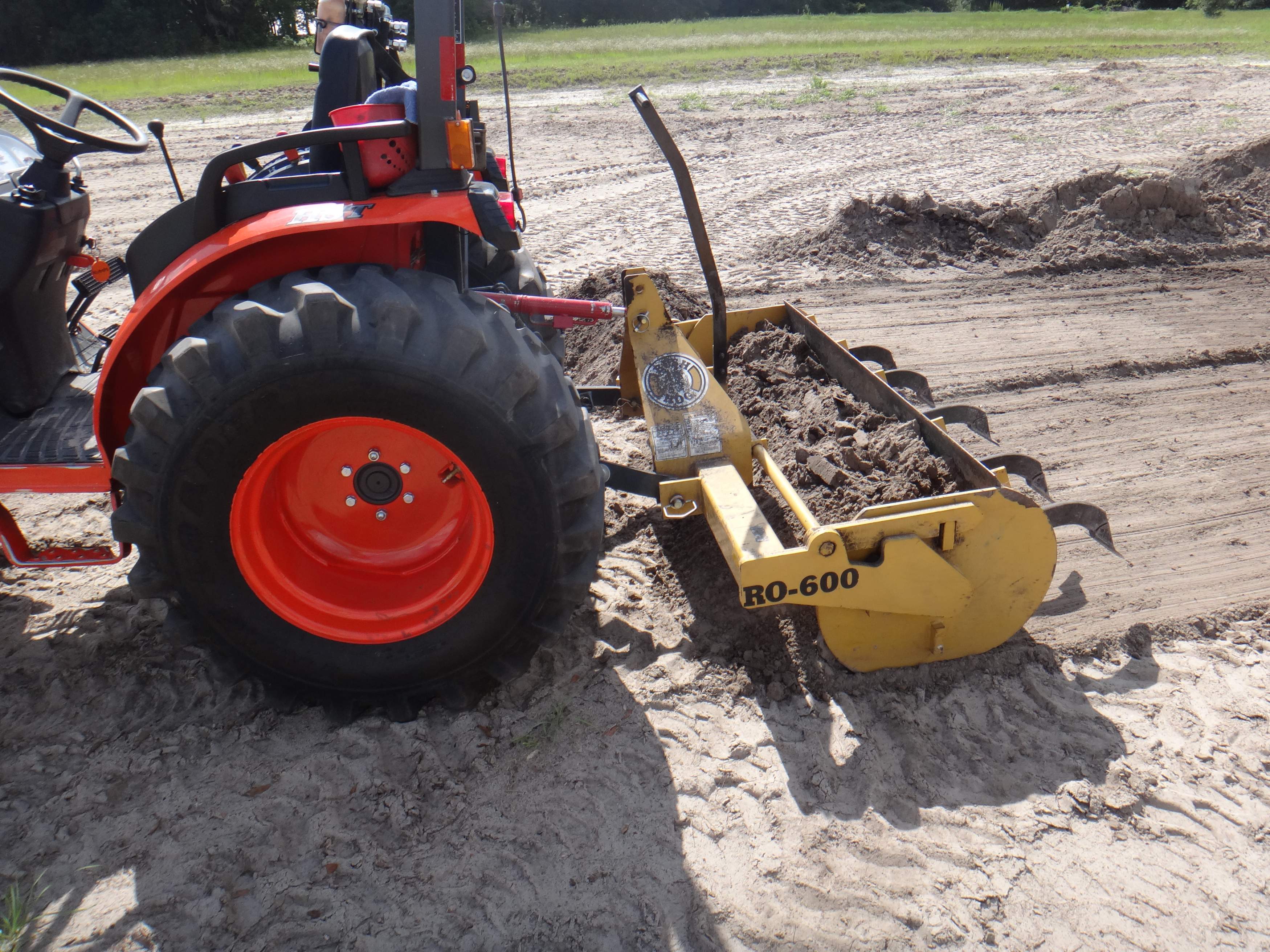

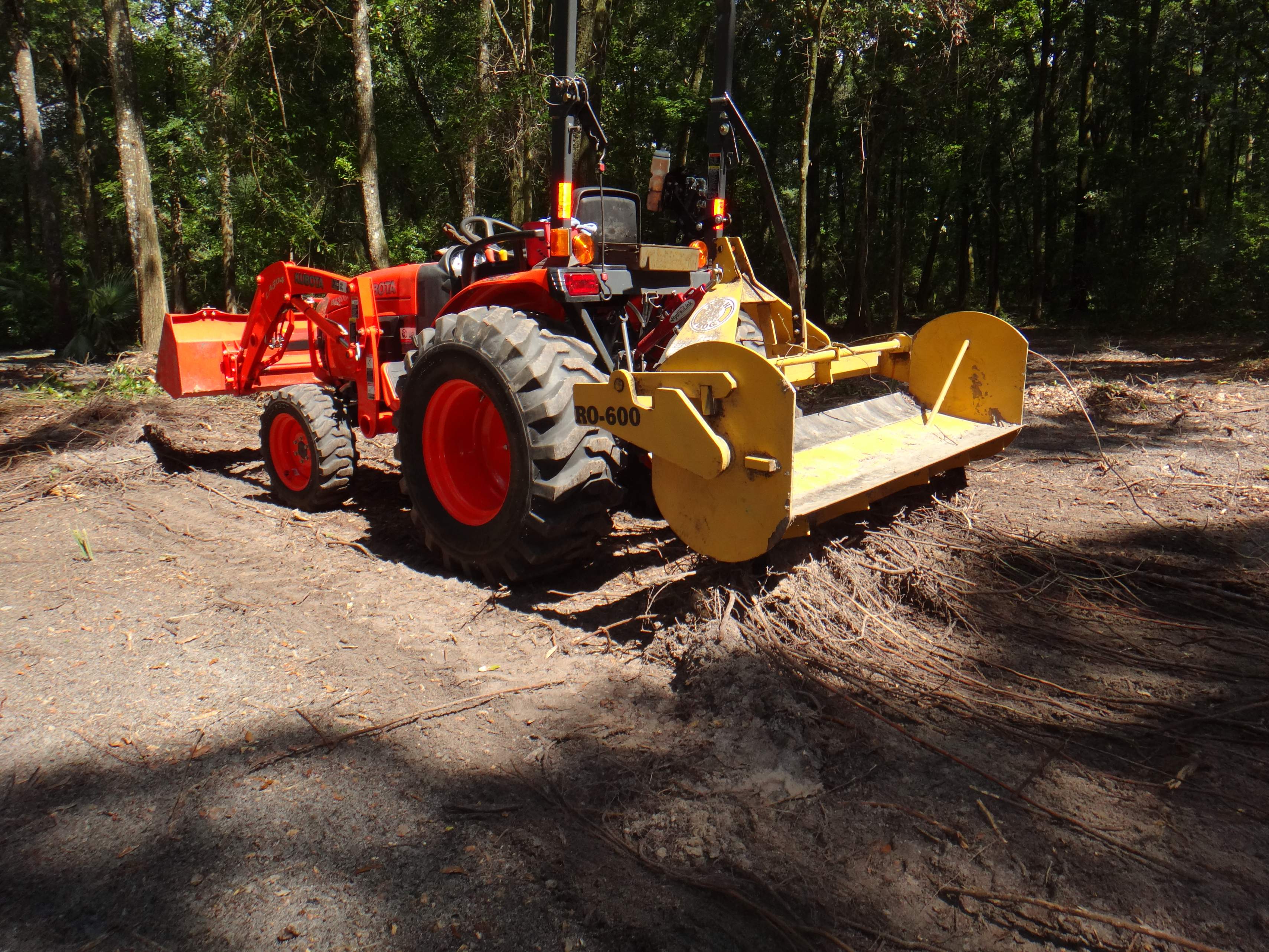

L2501 has only one Loader option, LA525, approximately 1,100 pounds lift capacity.
You will want at least 400 pounds counterbalance mounted on the Three Point Hitch for FEL work, 500 pounds better, especially if rear tires are not "loaded". ((In flat Illinois, I would not load the rear tires on a 25-horsepower tractor, personally.))
Box Blades only begin to cut well when the weight is 100 pounds per foot of width. I had a Kubota B3300SU, a predecessor model to L2501. L2501 with optional 4-WD can pull a 500 pound Box Blade fine.
For those two reasons research Box Blades 400 pounds to 500 pounds in weight, 60" or 66" wide.
Weight is your friend in ground contact work.
Many here, including myself, feel there is more value in Land Pride's heavier implements than in Land Pride's light implements.
Land Plane/Grading Scrapers (LPGS) are the alternative to Box Blades for smoothing dirt, especially in road maintenance.
VIDEOS: land plane grading scraper - YouTube
5 Most Common: Compact Tractor Attachments - YouTube

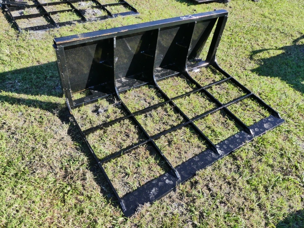

If you only need to prep 1/4 acre before seeding grass, a Ratchet Rake will be sufficient. (Order RR through T-B-N STORE, button at top of this page.)
Then you can select another Land Pride implement heavy enough to be counterbalance FEL loads. Perhaps a PTO powered Roto-Tiller?

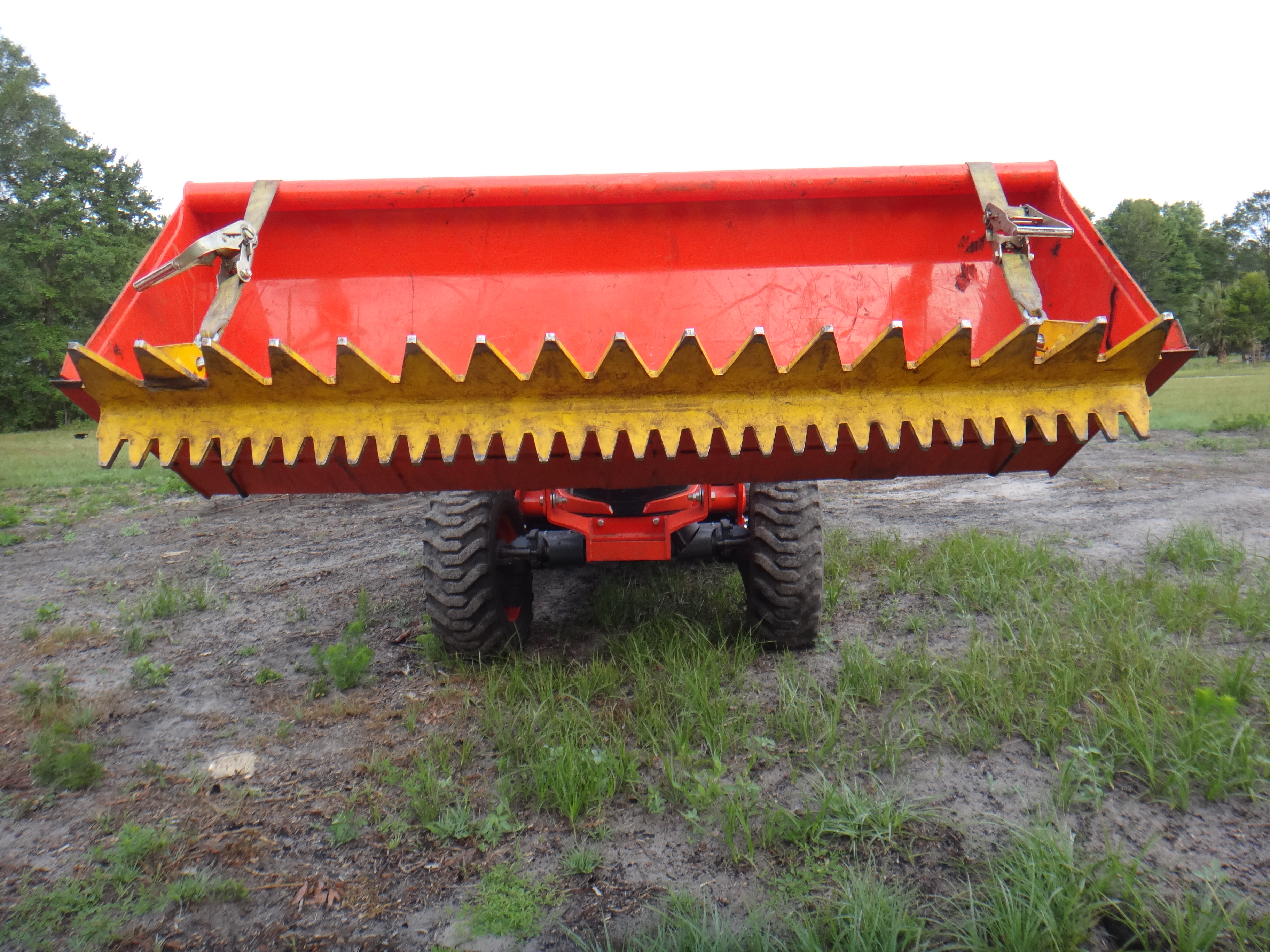

Re: Ratchet Rake // Today
6/09/2016
This post concerns Ratchet Rakes Vs. light Box Blades, such as the 60" Land Pride BB1260/346 pounds/69 pounds per foot.
I searched for the weight of kubota L3301 bucket but could not find a number. I presume L3301 bucket weighs approximately 240 pounds, extrapolating from other kubota specs. 68" Ratchet Rake weighs 88 pounds. Adding 240 + 88 = 328 pounds, pretty close to 346 pounds of BB1260 Box Blade.
In addition, the (operator controlled) weight of the FEL frame bears on the Ratchet Rake. Likewise, weight of the Three Point Hitch bears on the Box Blade. FEL frames weigh much more than ( 3X? 4X?) Three Point Hitch components. So, including some FEL weight, I guesstimate that ground contact pressure on Ratchet Rake and BB1260 would be at least equal, perhaps greater pressure on the Ratchet Rake.
Further in Ratchet Rake's favor you have articulation of bucket/RR combination in two planes from the operator's station and 1-1/2" serrated teeth on the Ratchet Rake.
Box Blade can be raised and lowered hydraulically from the operator's station. Box Blade angle of attack is adjustable via the Three Point Hitch Top Link, but not from the operator's station. Standard Box Blade does not have rippers, standard is a smooth cutting edge.
Ratchet Rake is capable of tearing up sod with its serrated teeth, the initial operation in much grading. The Ratchet Rake will not pull as large a load as a Box Blade but it may pull 35% of capacity of BB1260 per pass, with faster cycles. Ratchet Rake is more intuitive in operation than a Box Blade, which requires considerable experience to operate efficiently.
This is why I feel the Ratchet Rake is superior to light Box Blades for LIGHT grading.
I own both a Ratchet Rake and a Rollover Box Blade.
When I have heavy grading to do, I mount my 60"/625 pound (125 pounds per foot) Bush Hog (brand) Rollover Box Blade on the tractor's Three Point Hitch AND the Ratchet Rake on my FEL bucket.
