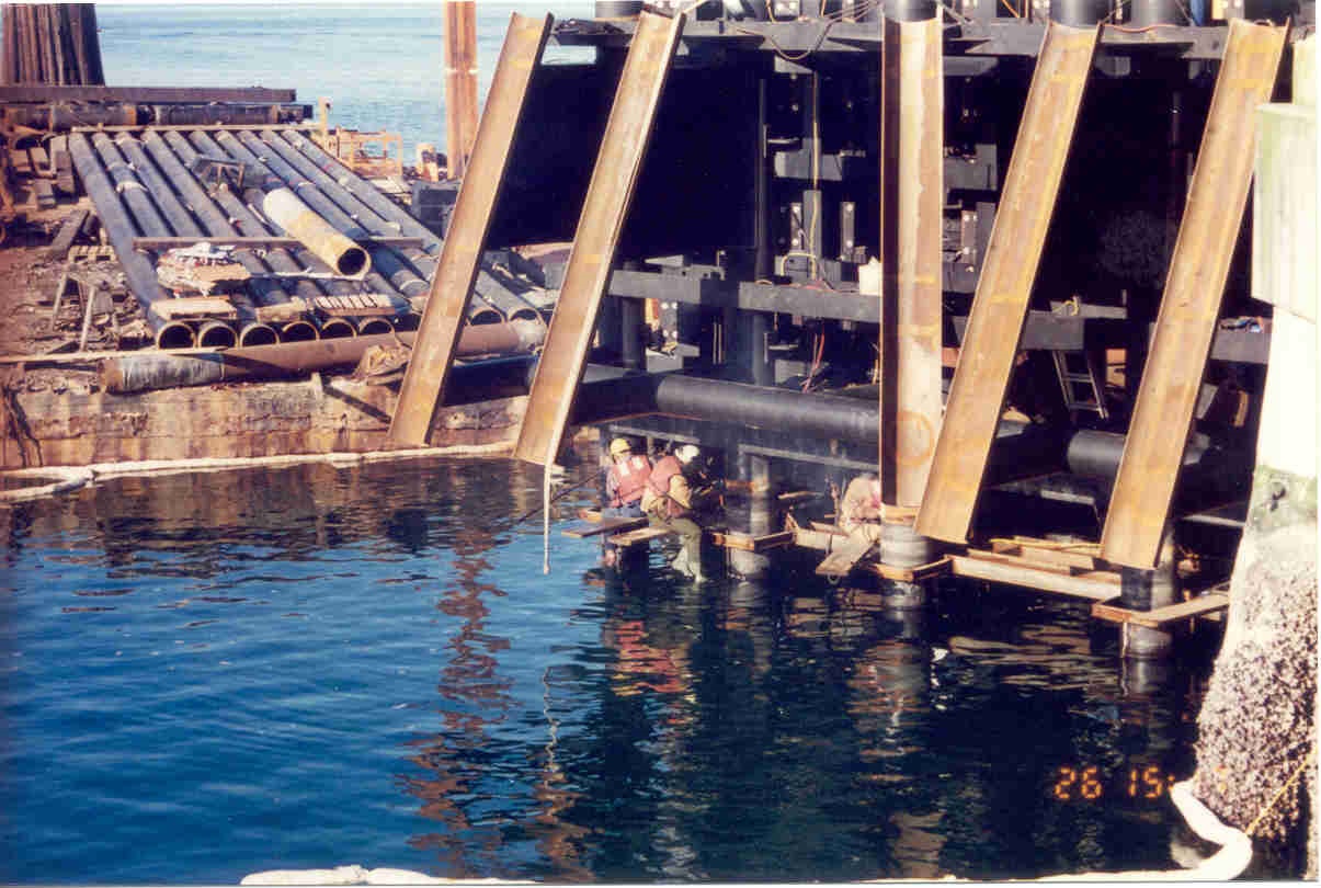

These new steel wing walls for the Washington State ferries. Require a lot of welding. We drive the plumb pile on location. Stand the pre-fabed wing wall on top of the plumb pile, and weld them together. Then drive batter pile in the saddles. They get welded all the way around. Like I said, a lot of welding!:eek:

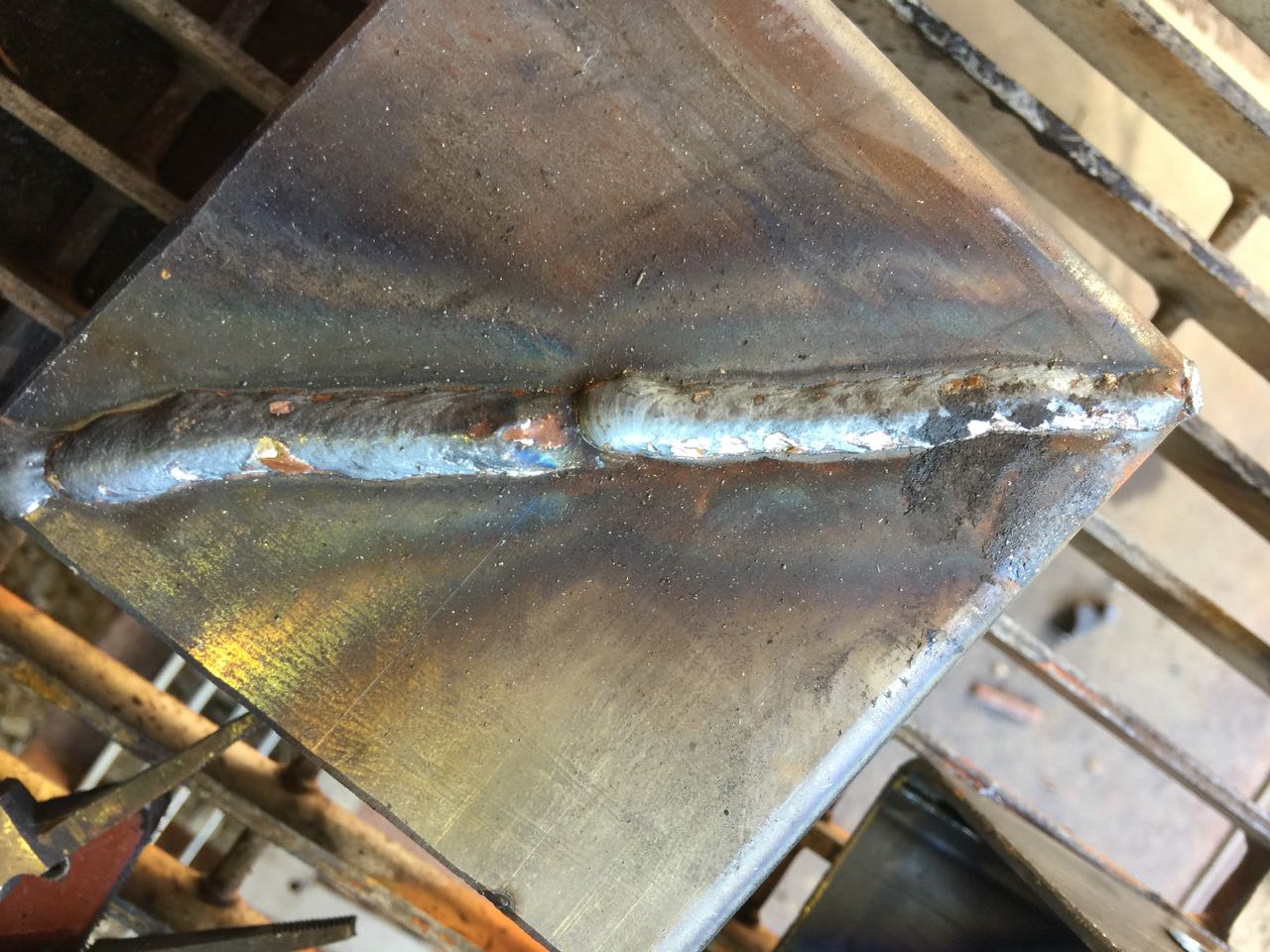

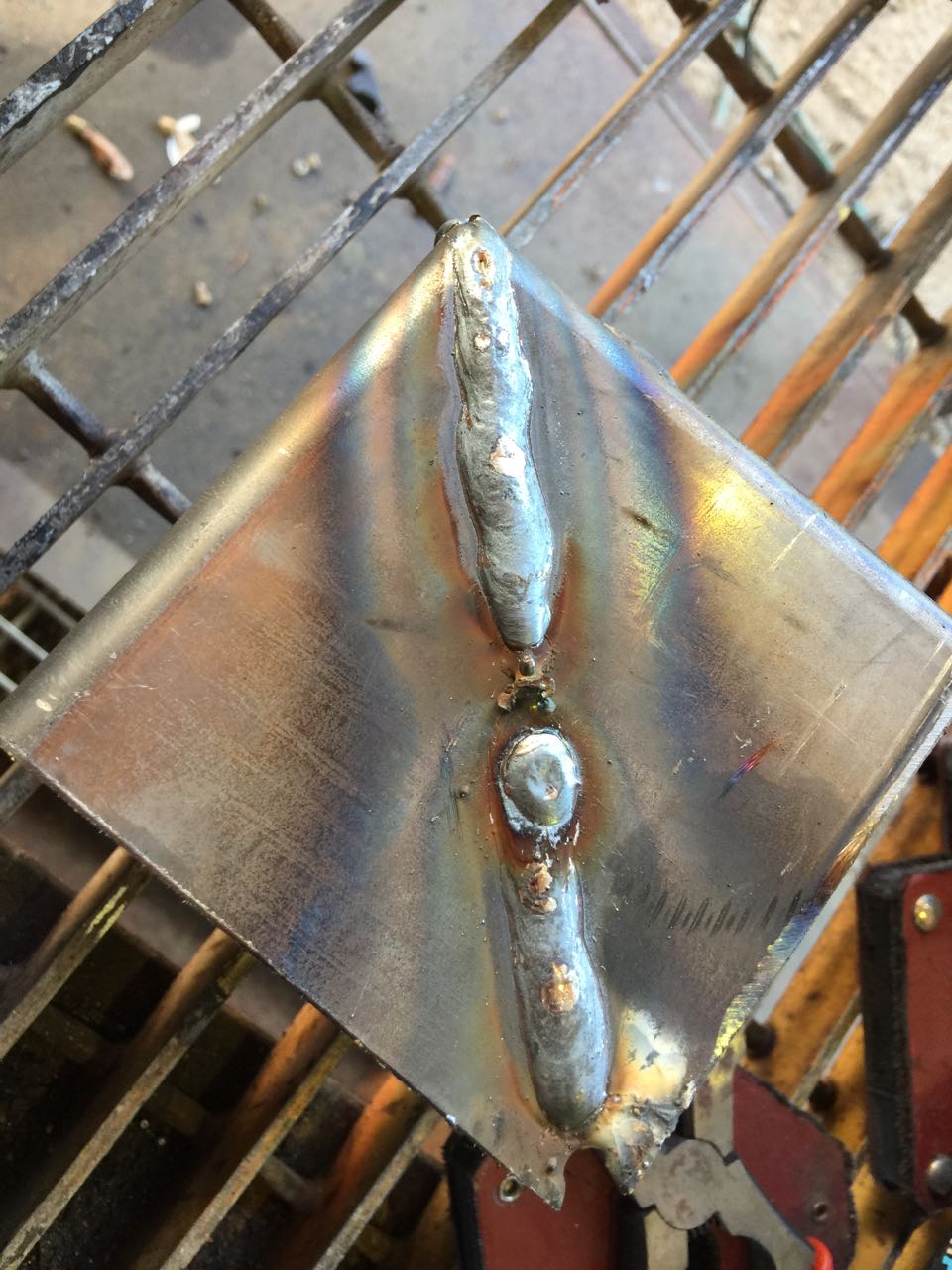

THanks for all the replies. Yes, too hot is an issue and I have the breeze issue, although I make sure I do not lay a weld when the wind is really blowing. I have upped my gas a bit and have turned down the juice a bit.
Here are picks of the welding (These are test welds, I am building something with 4x4 1/8" square tubing.
So I have a new issue. In my head I know what the might be a cause but... Anyway.. So instead of sizzling bacon I am getting a sputter sputter sound and the welding handle jerks around. It is the wire not arcing, that I know, but I am not sure why it is not arcing. I am thinking that even though I feel I have cleaned the metal, maybe I have not as well as I should. I am using solvent. So I am wondering if there would be a mechanical reason that I get the "I am not going to weld" that I have not considered. I will me more diligent about cleaning to see if that helps.
/ What am I doing wrong #24
Those welds don't look too bad, for being on a flat plate.:thumbsup:
Check your ground clamp, make sure it is on clean metal.

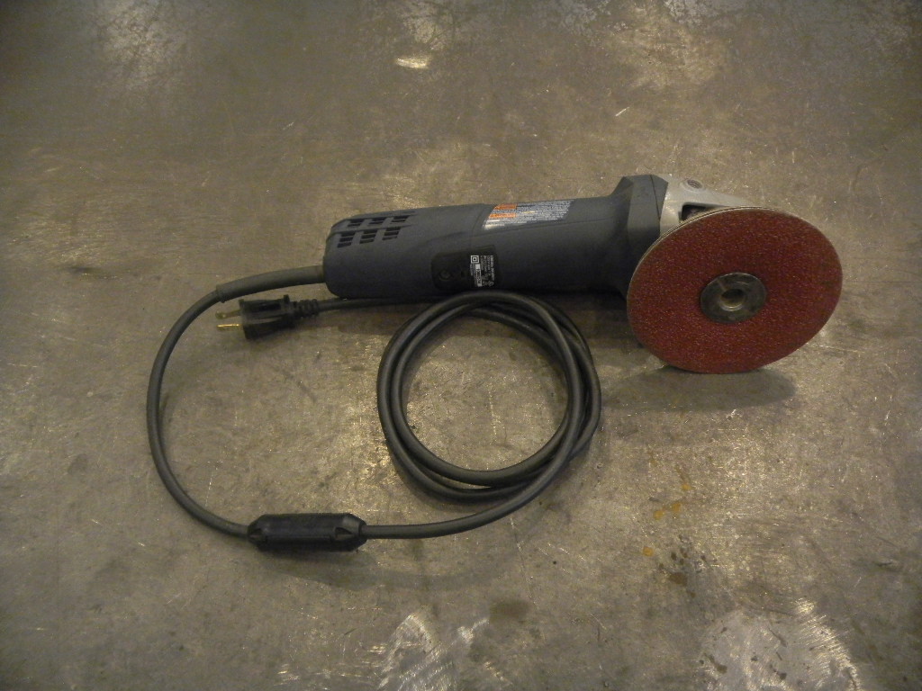

If I'm having trouble with mill scale in the weld zone. I use a 36-grit sanding pad on a 4-inch grinder.
