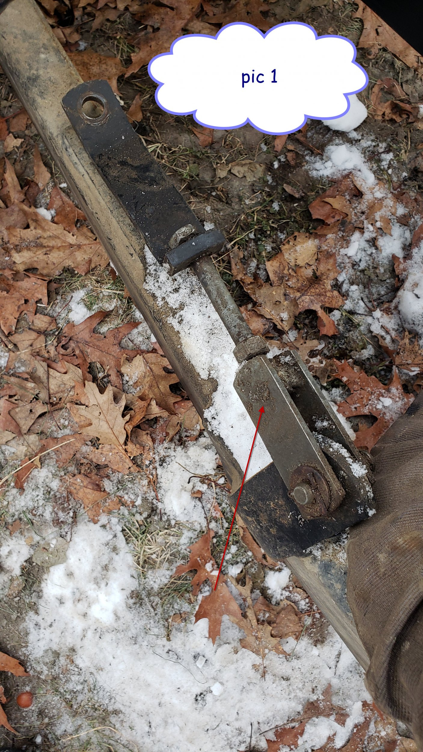

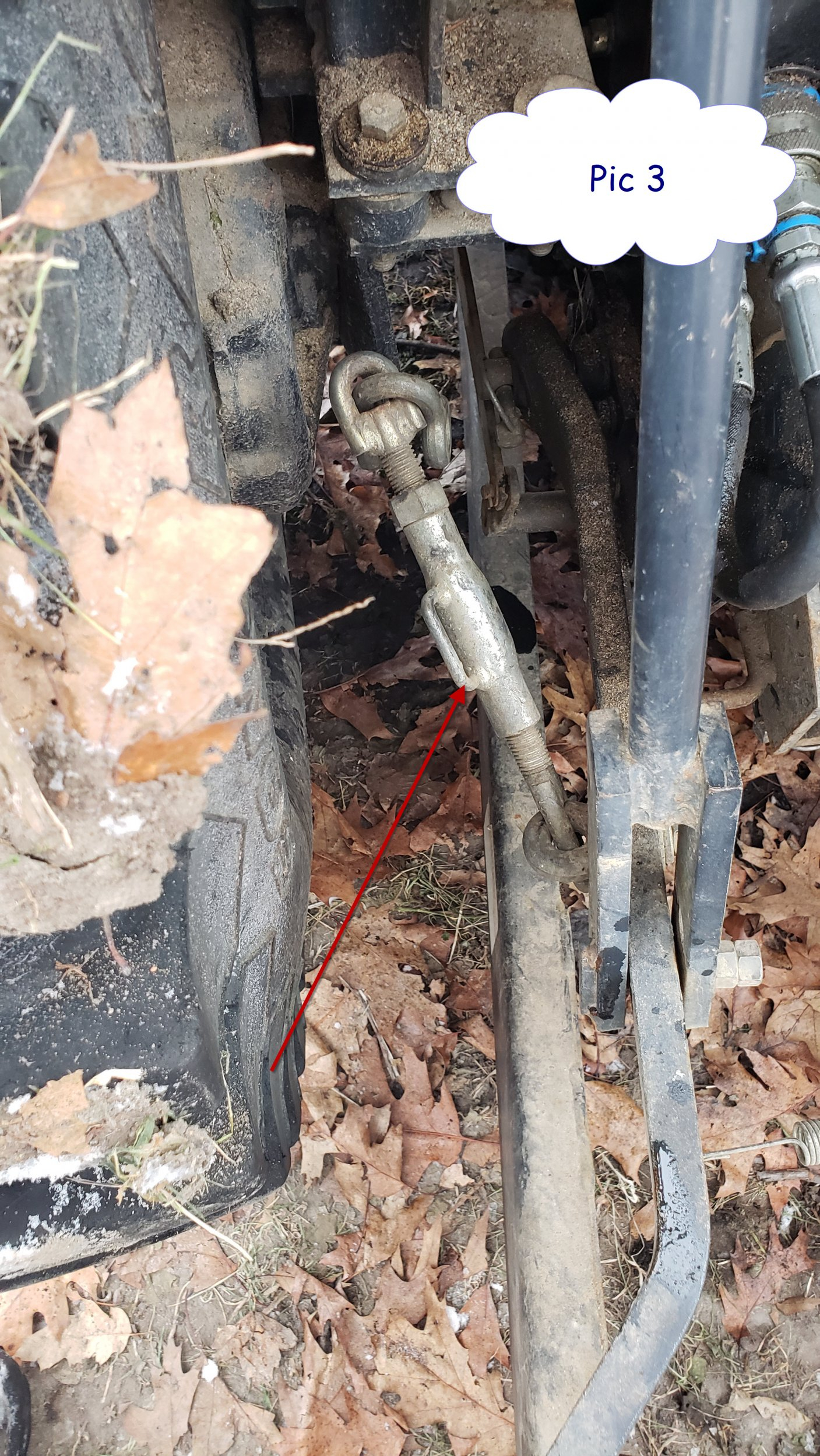

I have and MF1528 an I removed my Backhoe today for the first time. Any one know what are those link for? Picture 2 and 3. that is attache to my 3pth with tie wrap when the backhoe was attache to the tractor.
picture 1 is a link that is on my backhoe subframe. I'm assuming that need to stay on the sub frame?

Those are your sway control turnbuckles. When you atacch an implement . Mower , Blade ,etc those keep the implement from swinging into the tires,
   / What are thos on my 3 PTH ? MF 1528. #3
^^^^ what 3Gunr said... they should be in your tractor manual under the 3PT section
I never tought of Looking if there was a 3pth section in the tractor manual. I just looked and it is indeem in there. I'll take the time to read it. It look like they need to be attach at all time.
