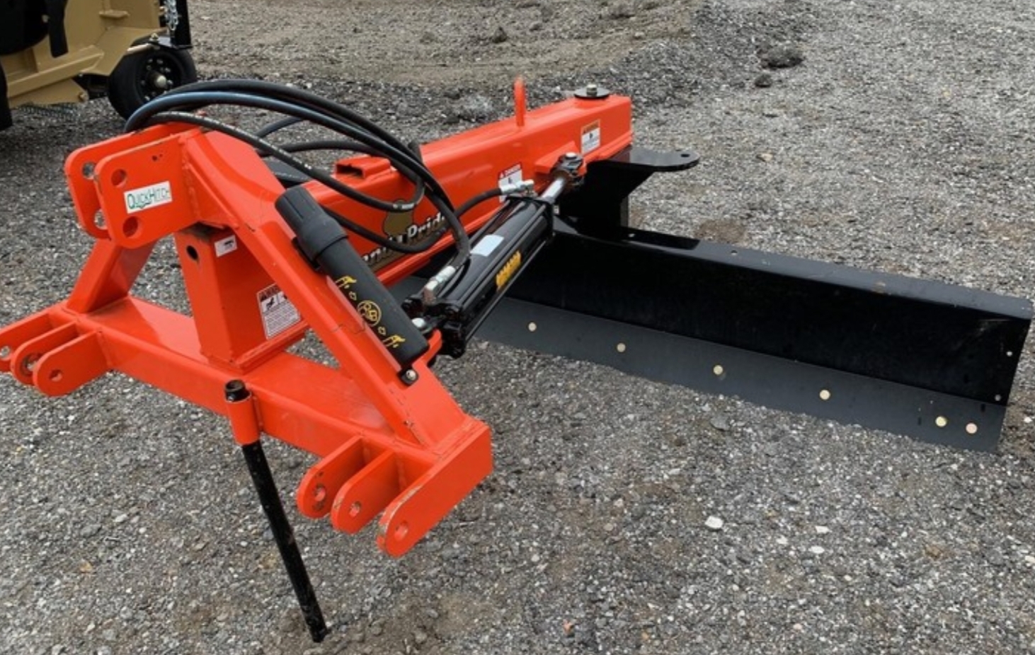

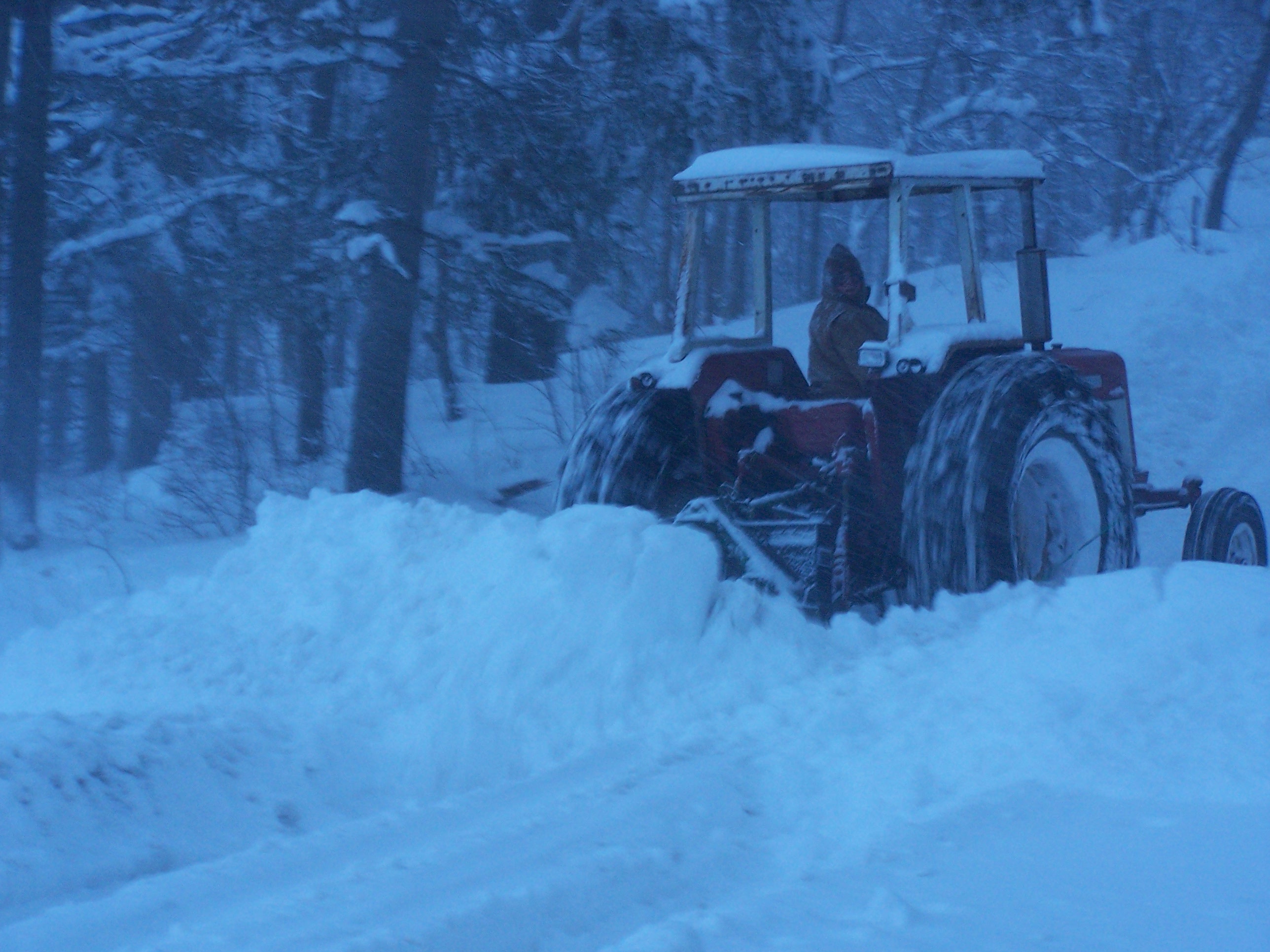

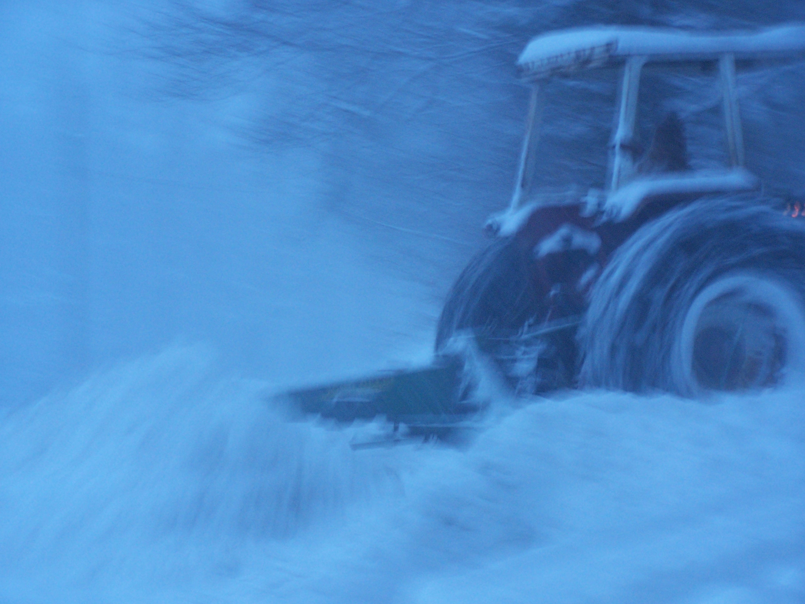

I have a mile long gravel/sand/volcanic ash driveway. After 39 years - all three materials are well mixed. After the spring rains it hardens up just like concrete. I have three implements that I use on the driveway. Each has its "best use". A VERY heavy Rhino rear blade - 96" @ 1010#. A Land Pride LPGS( 84" ) with scarifiers. A Bush Hog ROBB( 72" ) with scarifiers.
I've found that any road project goes better if a specific implement is used. I have no need to push an implement to do something it's not really designed to accomplish.
Snow removal and driveway ditches - rear blade.
Remove riffles, potholes, etc - LPGS with scarifiers.
Move material, dig to modify grade or slope - ROBB with scarifiers.
Any of these implements will perform any of the listed tasks, but no one is best for all. Here are the implements I use - sorted most to least.

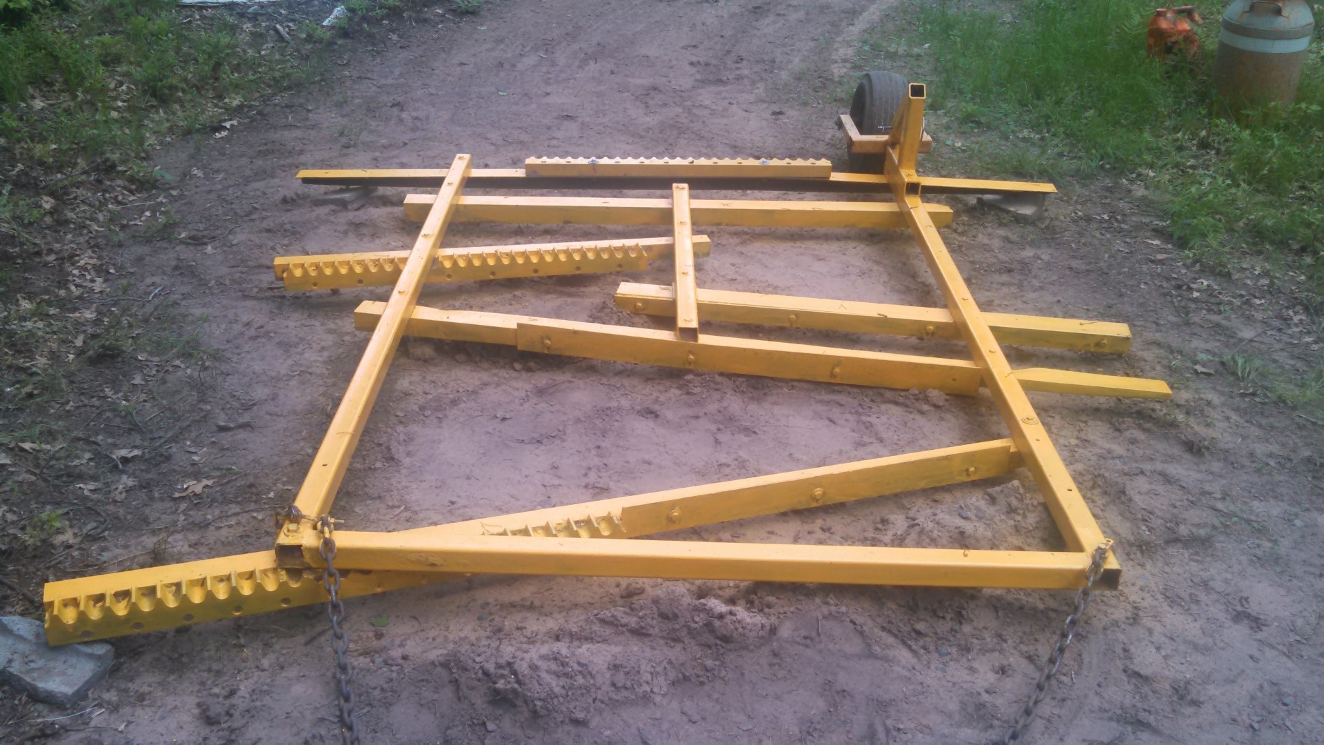

Road Drag to maintain 1/2 mile road (like a grader/scraper)

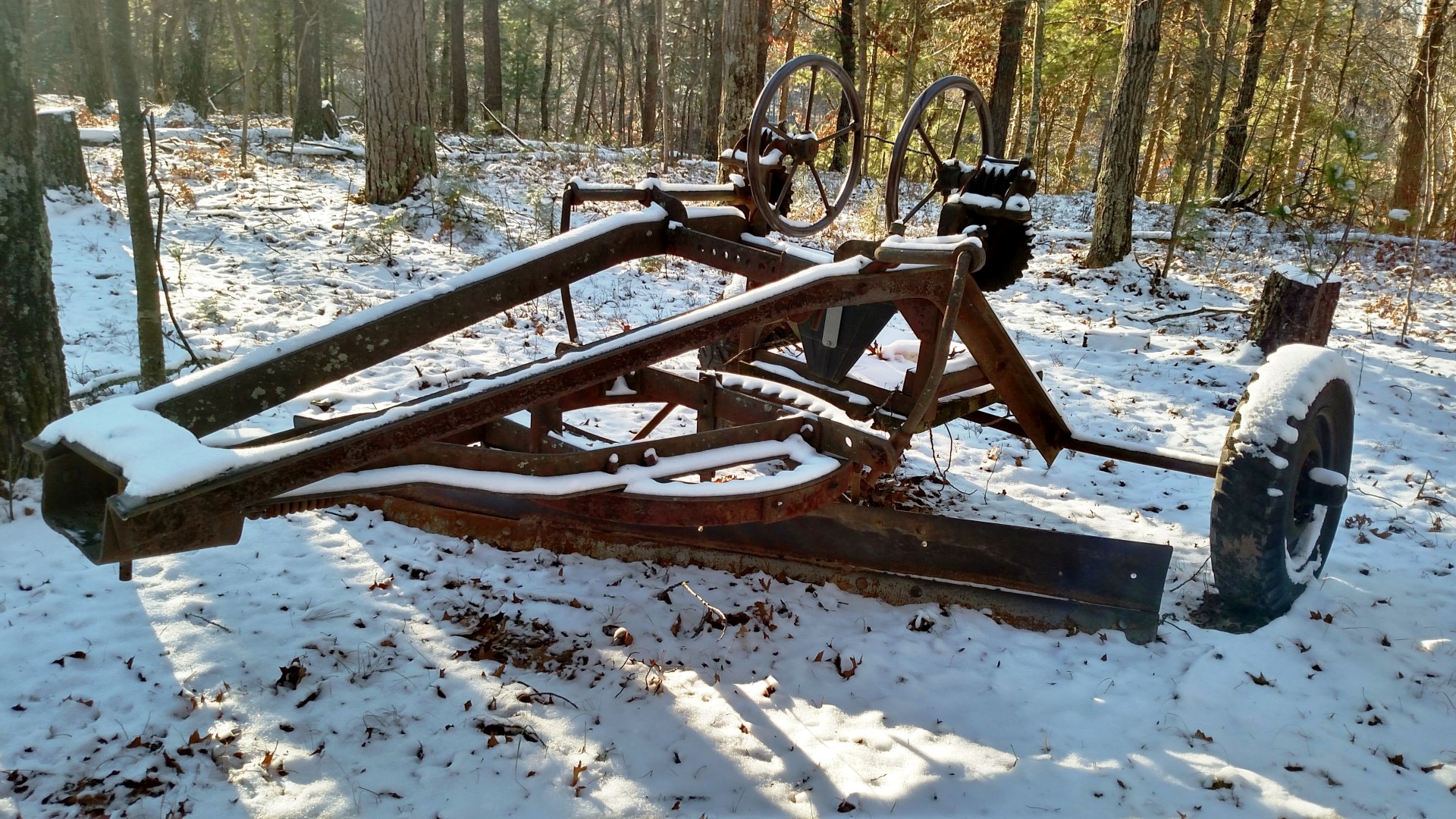

Horse Drawn Grader to create crown, smooth and sculpt ground, ditch, etc.

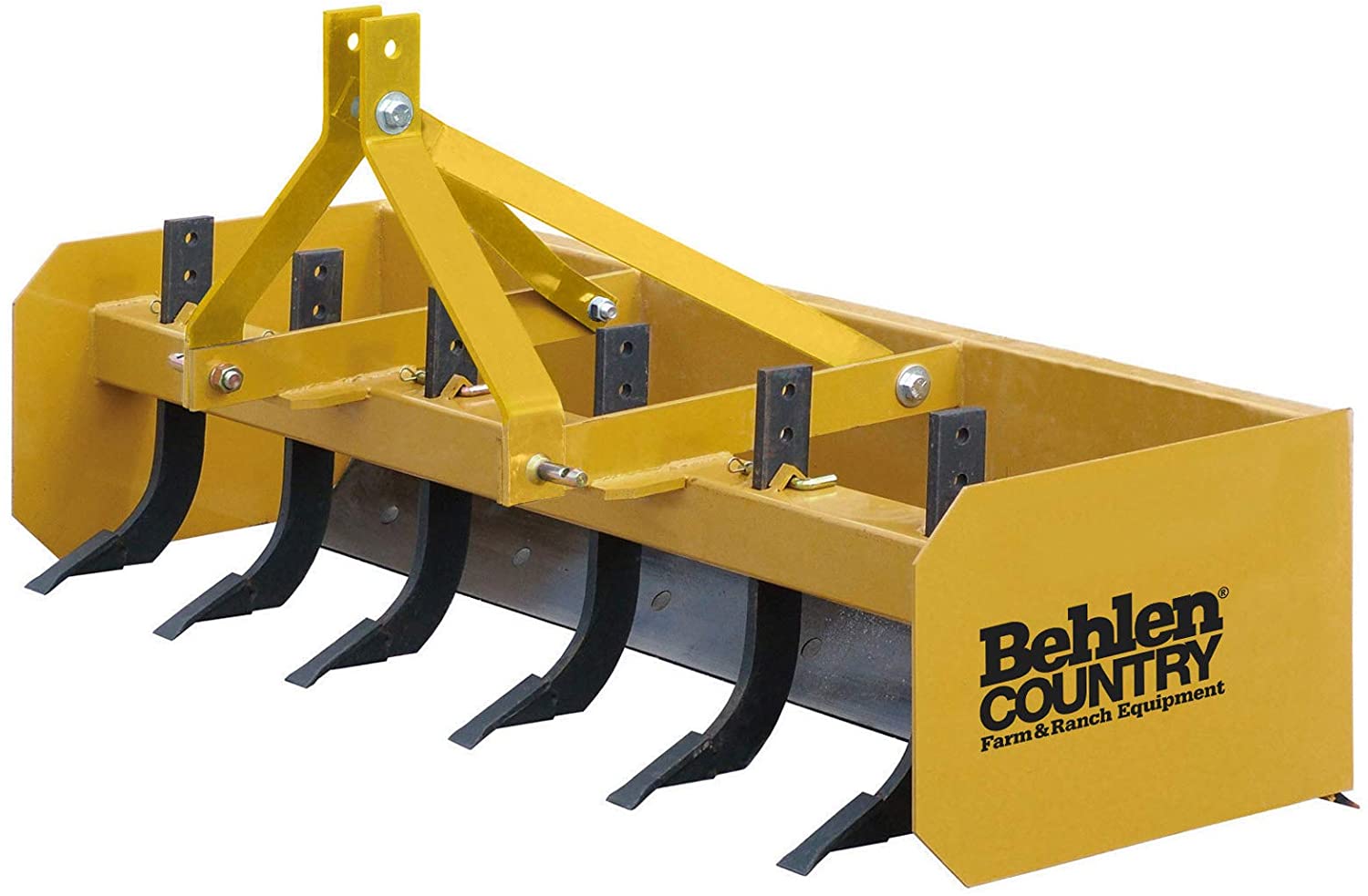

Box Blade to scarify potholes and move dirt

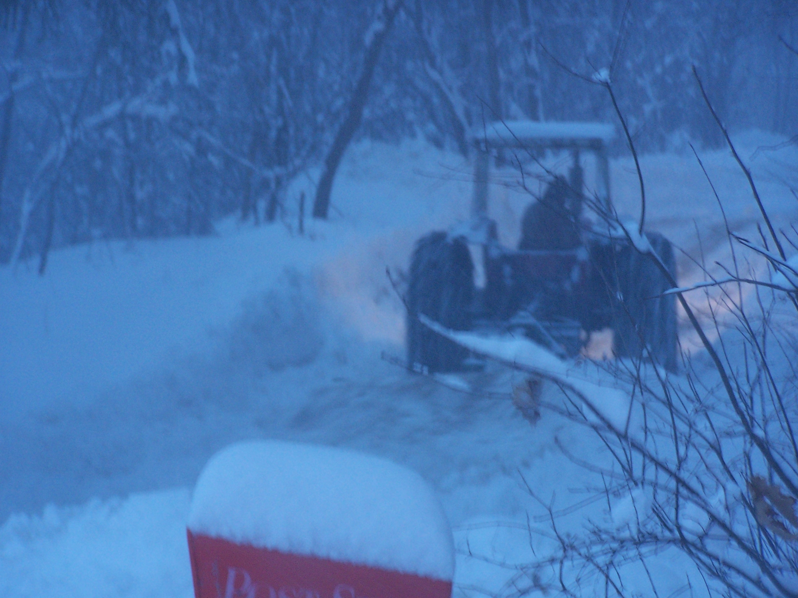

Rear Blade for plowing snow, and some gravel work (gets used less since I bought a rear pull snowblower)
If I could only have one, it would be the Horse Drawn Grader. Nothing can match it for utility, finesse and ease of use. That said, it's nice having them all and using each for what it's best at.

My 7’ woods offset grader blade is all my 60hp 4x4 tractors can handle on some spots of my 1/2mile mountain driveway. Off set past the tire on one side keeps me out of the ditch and trees. Do find the grader blade more useful than box blade for maintenance. Both have sat unused for years since getting a EA land plane and driveway maintenance time drastically been reduced.

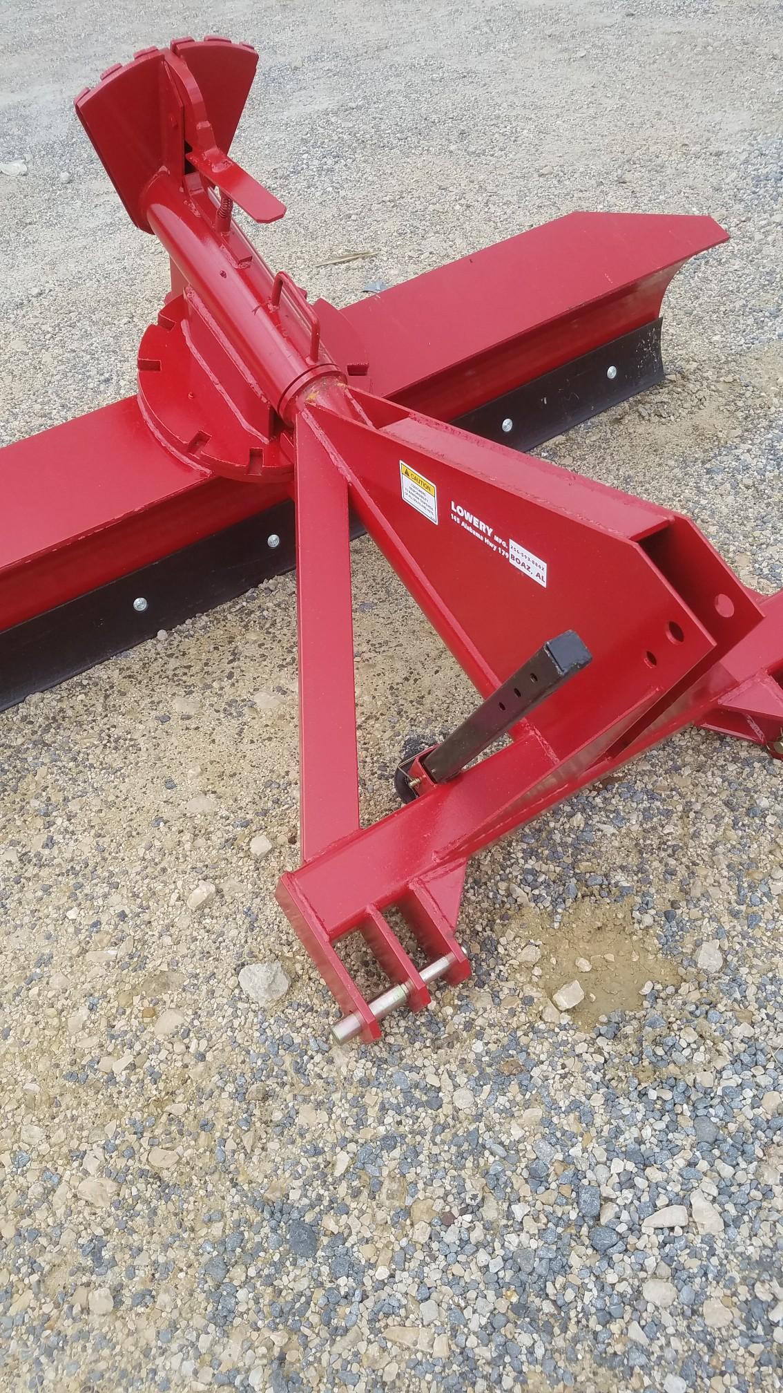

IMO, the perfect rear blade for your tractor would be a Land Pride RBT3596 or an RBT4096.
You can get it with all manual adjustments or individual functions with a hydraulic as you like.
I highly recommend skid shoes, others may or may not.

Many of the better angle blades - Woods, Servis, & Land Pride RB35 series for example - have optional end pieces called "ears" that make an angle blade able to carry dirt like a box blade. But I've never seen a box blade that could be made to do much angle or offset At best they might tilt just a little.
