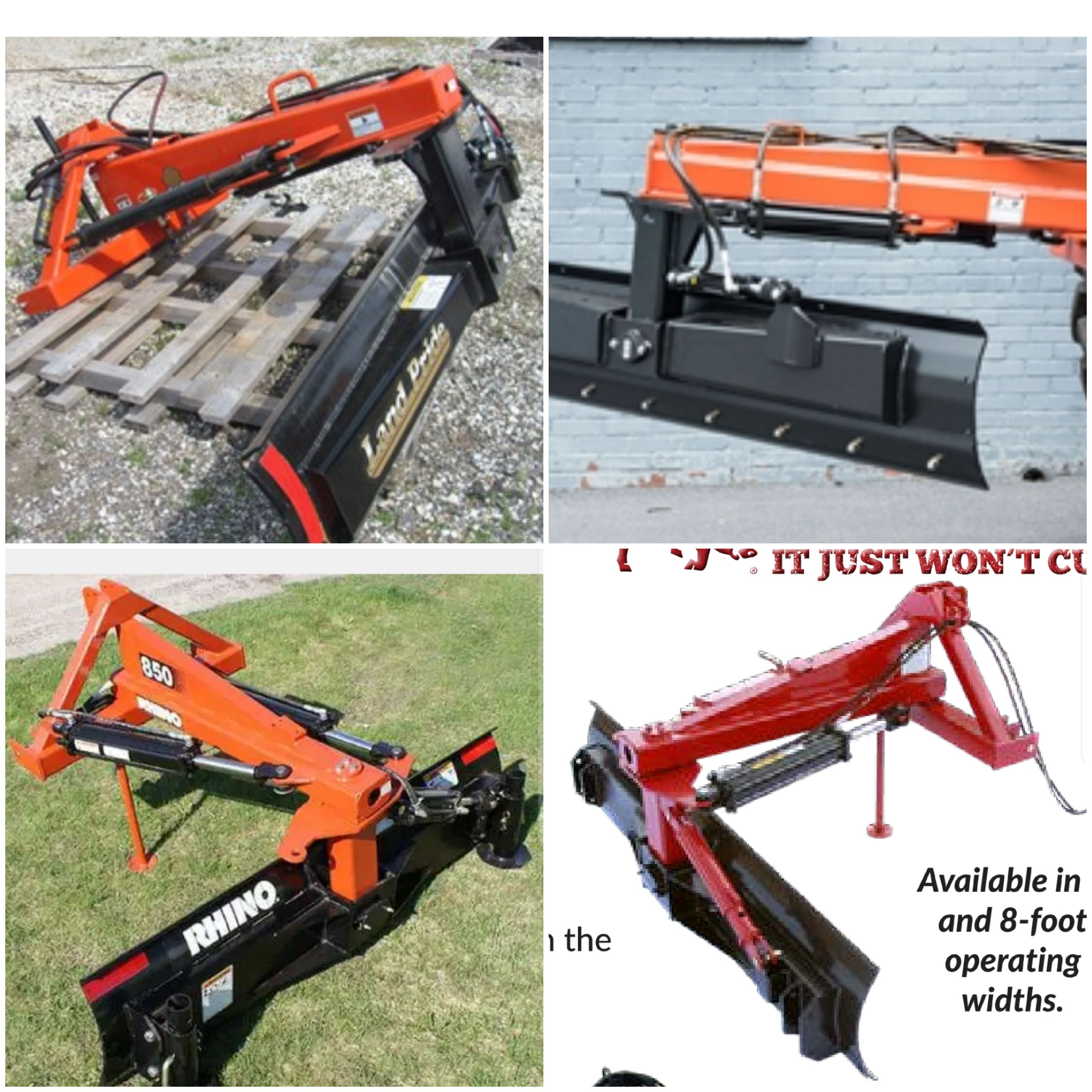

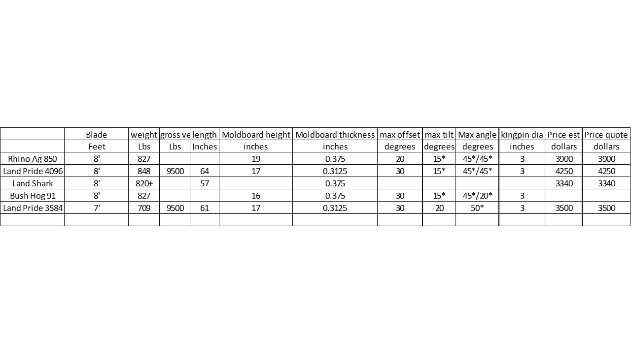

So my price quotes are almost in. All models with 3 hydraulic cylinders.
Land Pride RBT4096 8' $4250 7' $3500
Rhino Ag 850 8' $3900
Land Shark 8' $3340
Bush Hog 91 series 8' still waiting.
On the fence about 7' vs 8'. I know the 8' would be appreciated in many instances, but not sure if it would be a little too much for my tractor.
The EA Land Shark is the least expensive but also looks to have the least blade support. The Land Pride has 0% financing.

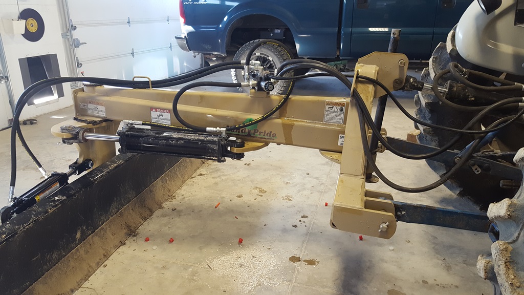

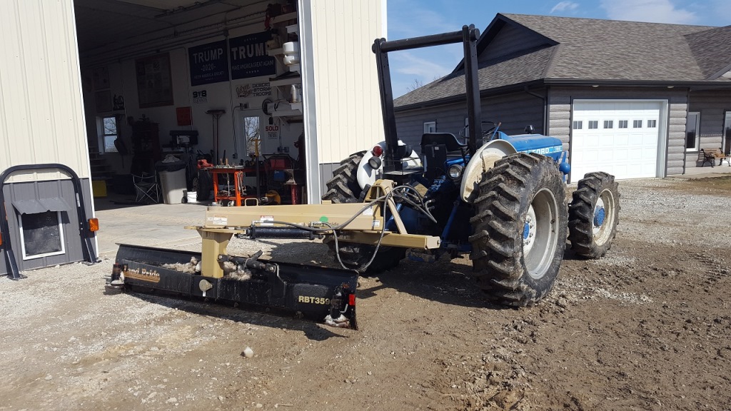

I bought this RBT3596 used last Winter. It had a hydraulic angle cylinder on it. I added a diverter and a tilt cylinder. It's the perfect blade for my 47HP Ford. I wouldn't want it any narrower cause you'd struggle to cover your tracks when angled. Wouldn't want it any wider because it would overpower the tractor weight when angled and moving heavy material.
If I intended to use it on my 95hp Kubota I'd want the 45 series in a 9 footer.

So I appreciate the feedback on size so far, but I'm still not sure 7' or 8'. Here is some other features of the ones I've been considering.

#54
I appreciate your pictures and thoughts. What would you be missing if that were a 7' blade instead of an 8'? I'm back and forth on this aspect.
