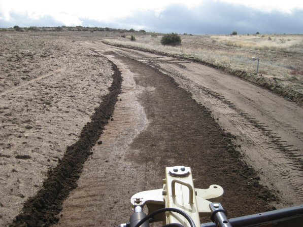

I think that I can get a pretty good job without any tail-gauge wheels.
Others might think otherwise. :confused3:
Just my :2cents:

BTW - take heed of what kThompson has said about angling the rear blade and have a good look at the far right picture of MtnViewRanch. The blade is at a good angle and cuts the material well. This is the way I use my rear blade for both dirt and snow. I AM able to do dirt work on the driveway - early spring & late fall. The driveway is still damp. I very seldom do driveway dirt work during the summer. If I do - first it's either the LPGS or ROBB with their scarifiers.

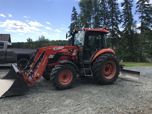

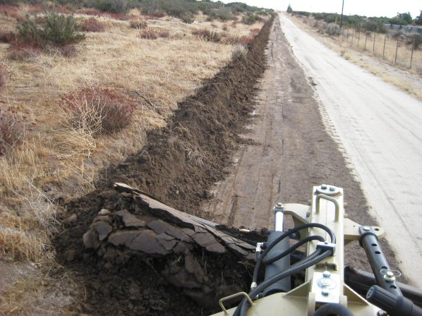

The point of me even posting those pictures was that it was mentioned that a small even cut can't be done. Well it can and is all the time. ;)
In the bumpy situation you are talking about, a LPGS works great to get everything evened out, then shape with the rear blade. I can actually do a pretty good job with just the rear blade, but found that it is simply easier to use the LPGS and then the rear blade.:thumbsup:

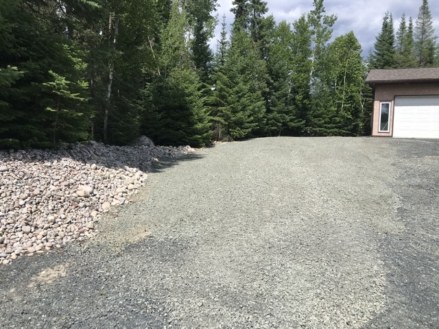

i wish i had a before picture but this newly gravelled area was not level by any means, and was overgrown and full of big rocks. but with a bit of loader work along with the rear blade and 25 yards of material (some A gravel before the blue crushed) it's not bad for a rookie, i didn't think. I did have to get our and use a rake a few times and pic a few stones :)
I wish i had a hydraulic top link, would have saved a few trips up and down the stairs!B28F836C-9E10-4A97-A8E4-78EAB979D93B.jpeg63D9355F-084D-489F-BF05-D4B23A141E92.jpeg
