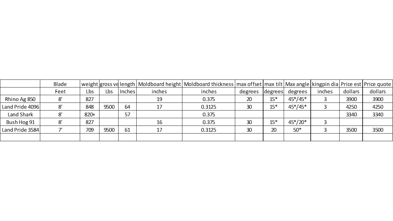

So I appreciate the feedback on size so far, but I'm still not sure 7' or 8'. Here is some other features of the ones I've been considering.

Well it makes me think that my 6500lb tractor would be okay with a 850lb 8' blade. I think that's what I'll buy.

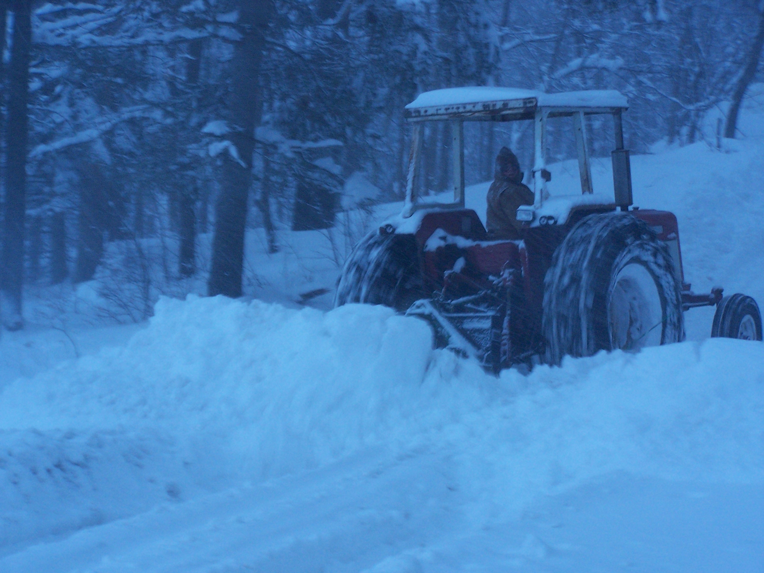

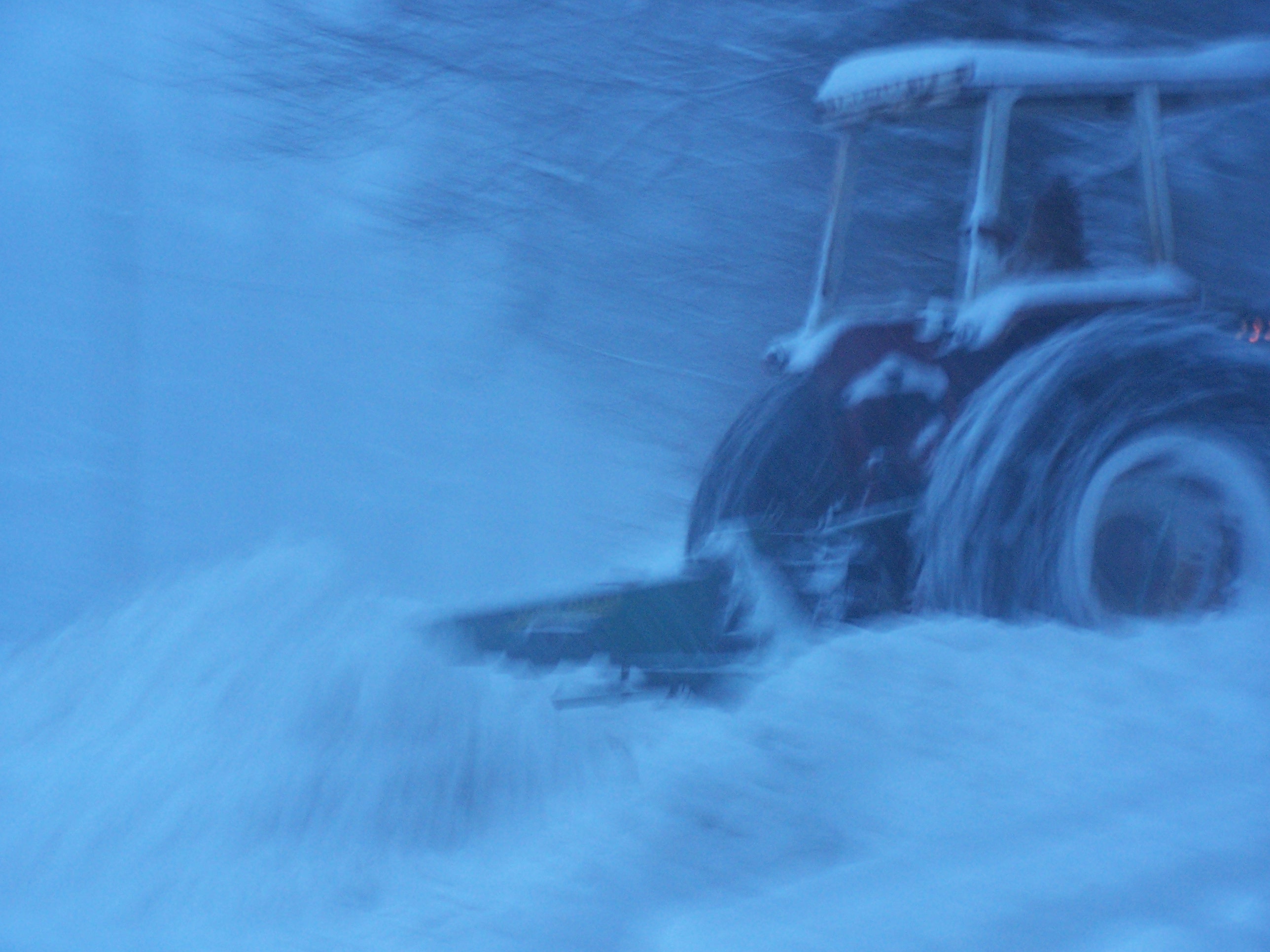

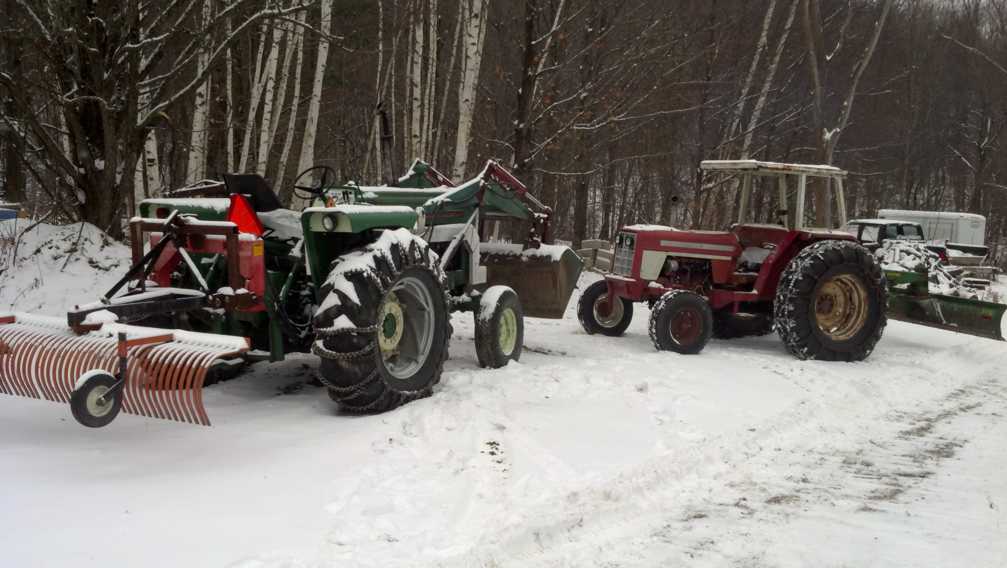

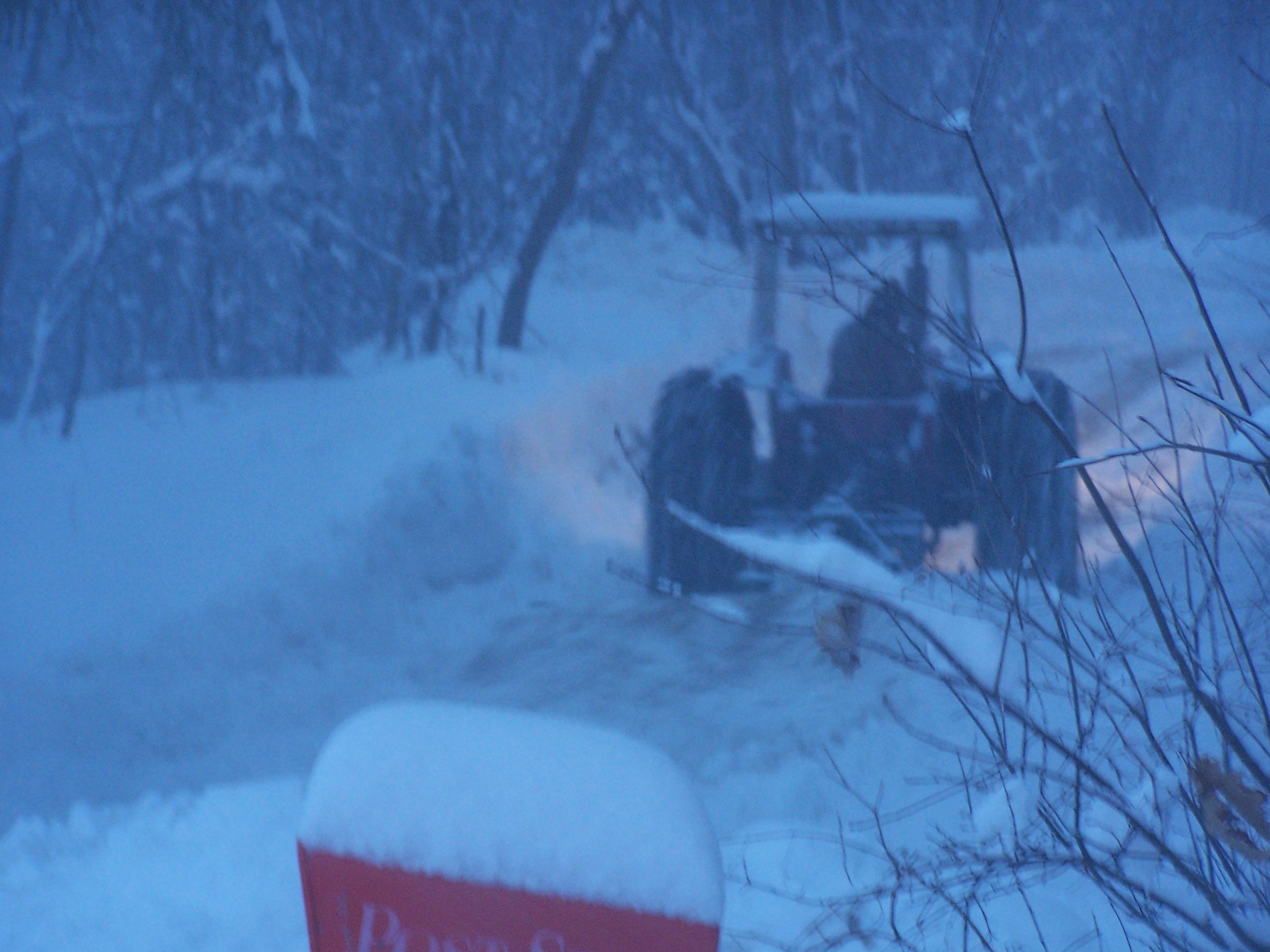

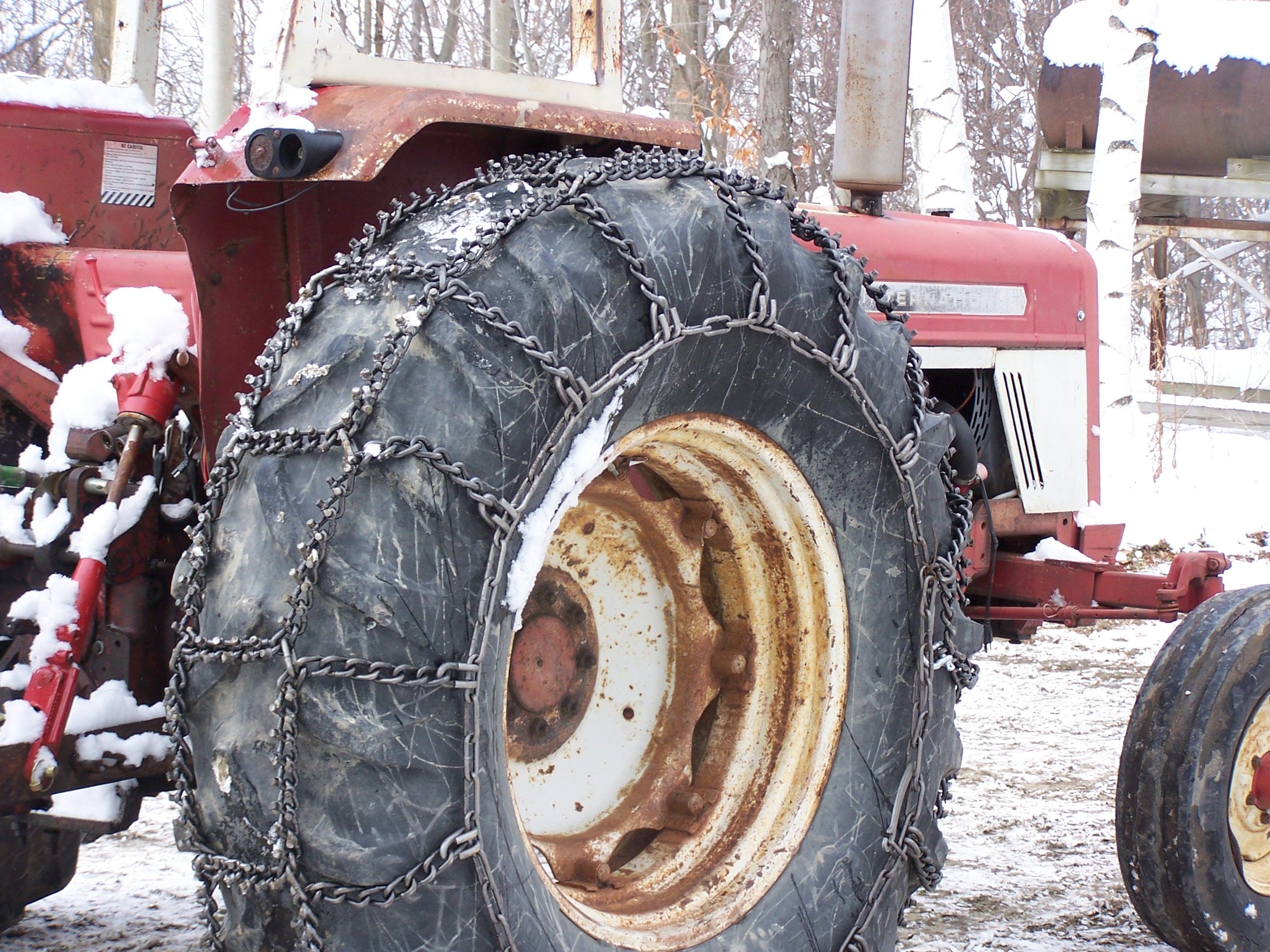

Here is my under 5000# IH 574 with a 9 footer on it;

   / What can a rear blade do for me that my box blade can't? Road and ditches mainly #69
No snow for me though. Only digging ditches and crowning roads. Maybe other stuff, but mainly working a 1/4 MILE mountain road to a cabin.
That's is nice.
Ideally you would work uphill as the material will travel down hill on it's own.
For ditching downhill adds a lot of power to your effort.
That's what I would do. If the length turns out to be just too much, you can always shorten the 8 footer. Since your tractor can handle weight, I would also lean toward the heaviest blade. Do all the blades you listed have the same shape & thickness? That's something to check. Also, do consider the end caps - they are perfect for jobs where you are trying to smooth using existing material rather than just cut & move the dirt off to the side. Caps are useless in snow, but they unbolt for winter.
