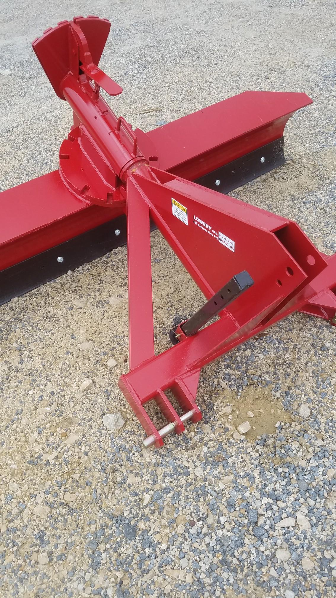

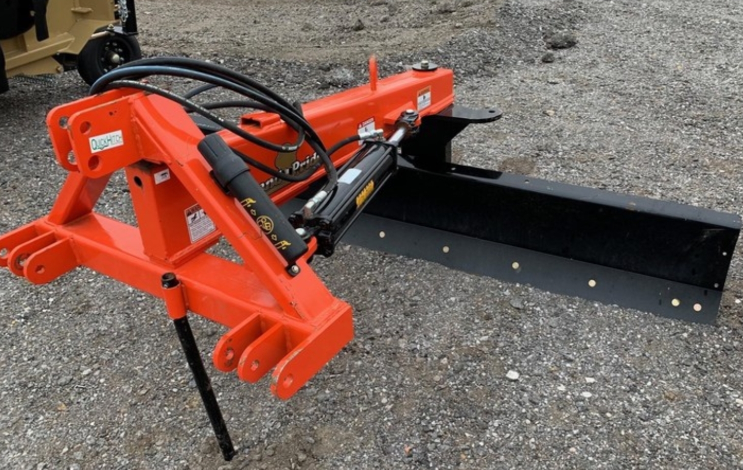

So basically this thread has served to grow me out of buying this standard implement for $1250:
And put me into a heavy duty 8' three cylinder heavy duty rbt4096 blade with a diverter valve.
On monthly payments at zero interest.:rolleyes:
Thanks for all the advice. I'll get the sideplates, shoes, and gauge wheel as I need them in the future. This thing was already $4390 like it sits with tax included and the diverter valve.
   / What can a rear blade do for me that my box blade can't? Road and ditches mainly #74

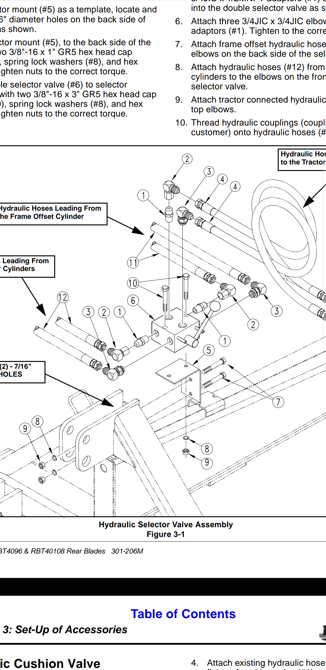

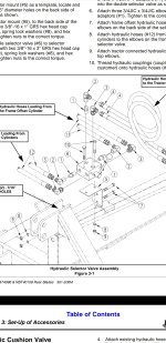

Here is the manual diverter valve setup so my two rear remotes will move three cylinders. They said that I should be able to reach the handle from my seat.
   / What can a rear blade do for me that my box blade can't? Road and ditches mainly #78
You can't reach that from your seat.
   / What can a rear blade do for me that my box blade can't? Road and ditches mainly #79
Electric diverters are fairly simple to wire up and handy to use.
   / What can a rear blade do for me that my box blade can't? Road and ditches mainly #80
Exactly. A good option for many uses where constant control is not a necessary. I had planned on using one to power a grapple and though it can be done it is not very efficient for me. But on a rear blade, it would be a good way to go.
