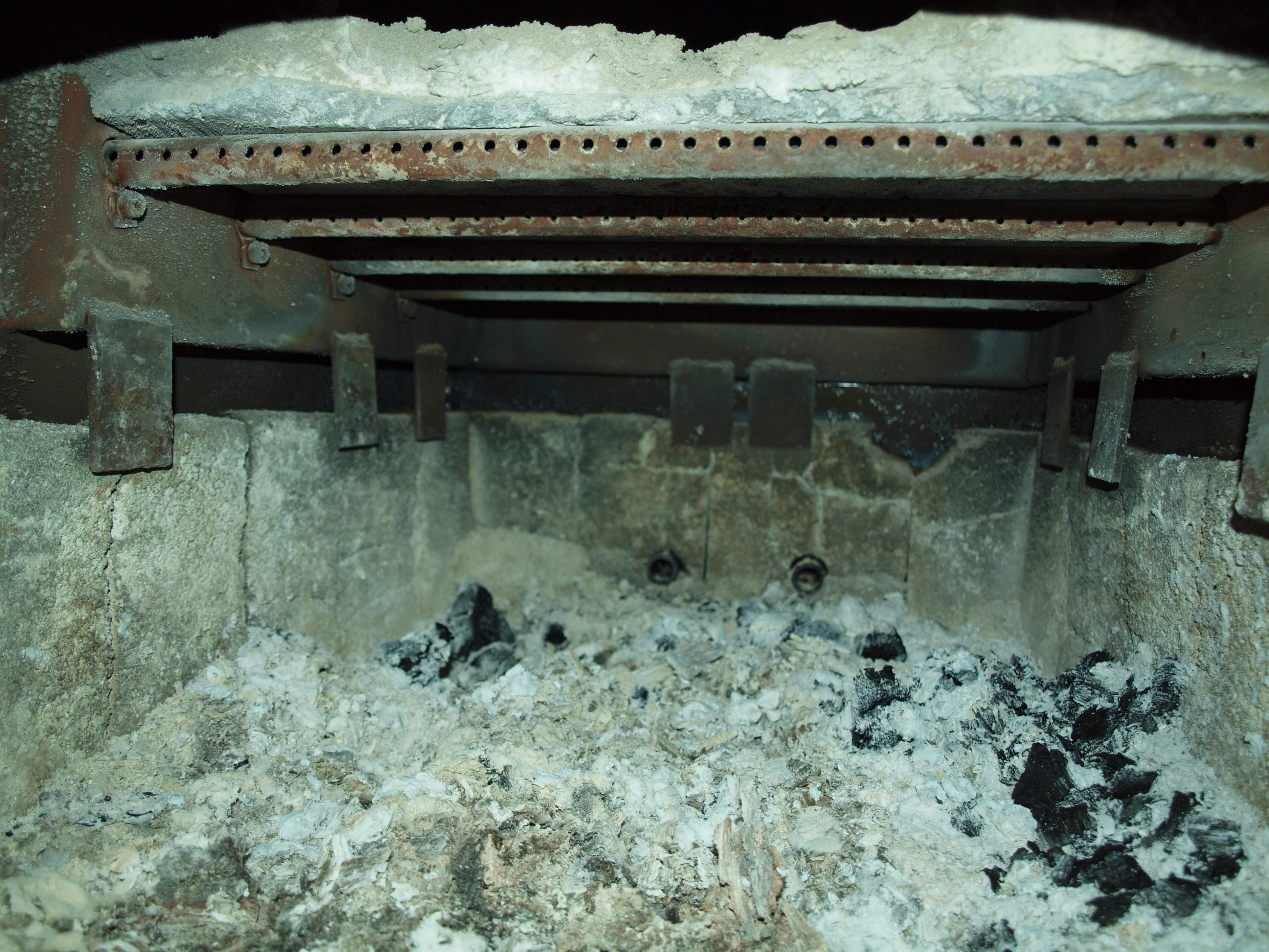

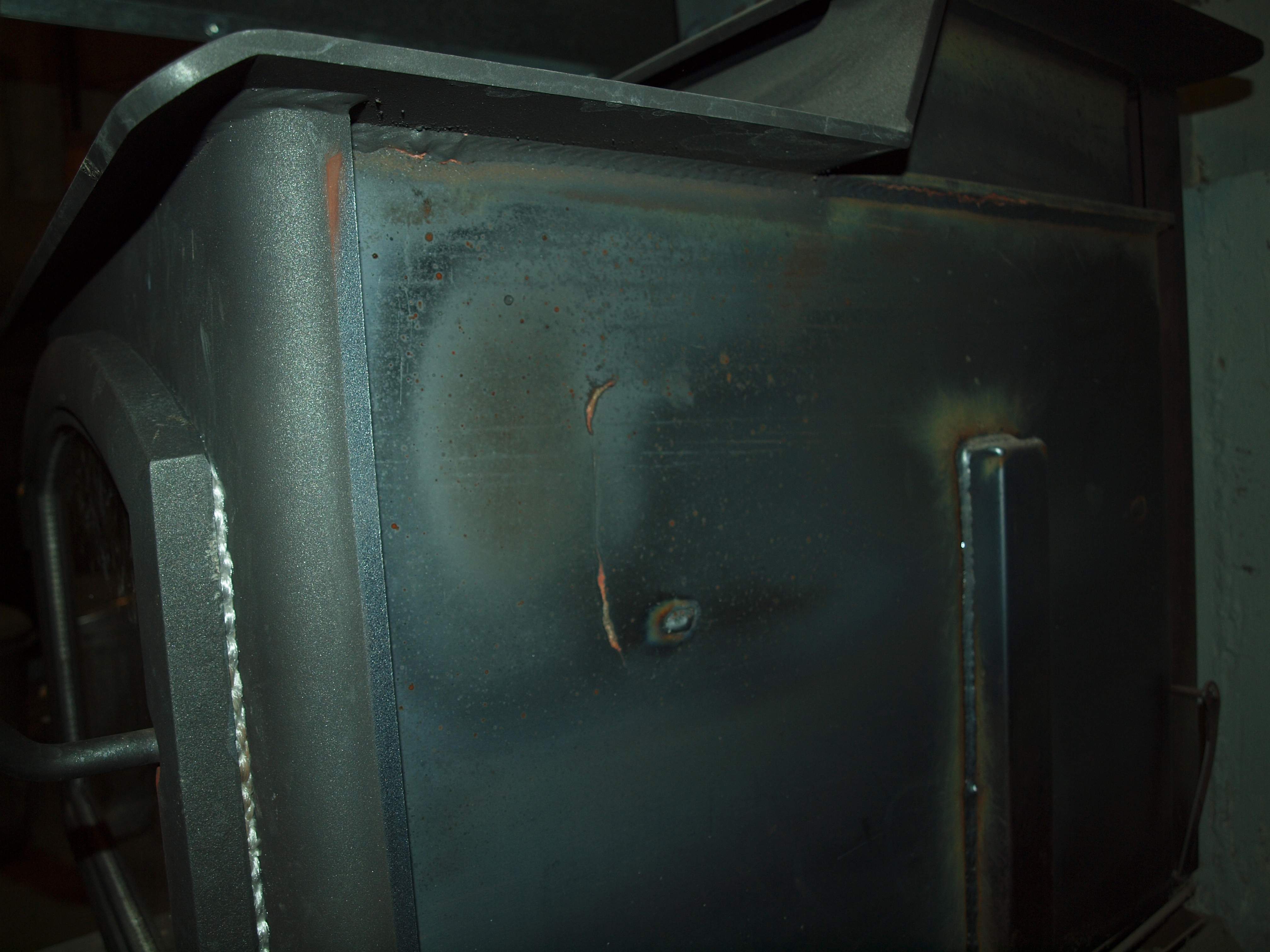

For any experienced welders on the forum this is the side of a Quadrafire 5700 wood stove. The other side also has a crack like this in the same location. This is a weld seam on the inside of the stove where they welded the air tube manifold so it is cracked right through. Obviously heat created the crack but my question refers to what can do this on 1/4" steel at a weld joint such as a deep weld or something to that effect? The manifold is made with tube iron with one end capped off and drilled for the lateral secondary burn heat tubes running across the top. The other end is open to an air inlet flap. The next question is what is the proper way to fix this?

Is the crack beside that little weld were the red is?
/ What caused this #3
I'd shoot them an email. & pics. I'd say it's due to expansion issues with heating/cooling cycles, but that is a guess. They may have issues with this model. Post this over at hearth.com, that link I sent you the other day.
/ What caused this #4
I don't really know what caused it. Most likely too much stress in that location when hot.
I'd drill a hole at each end of the cracks, grind a groove in the cracks. Punch a key hole in the groove with some 6010 for the root pass, and cap it off with some 3/32-inch 7018.
/ What caused this #5
Weld it up like SA said, but do it when is at half the normal running temperature. That way it will see only half as much stress when hot.
And only half as much stress when cold.
/ What caused this #6
Ditto, especially grinding a hole at the end of the crack on both ends. I'd probably use MIG though for heat and speed control. It would not hurt to weld it when the stove is hot.
/ What caused this #8
A mig weld is not shallow penetrating unless you make it so. That is a myth. And it's more of an issue with a technique. If you try to "paint" on a weld over the seam, nothing is going to work. The metal in that unit is not all that thick...maybe a 1/4". A little grinding out a groove and fill it up. In fact, that is the method of choice it appears to weld the stove from the manufacturer. It's likely from a creation of a large HAZ combined with shrink swell issues as it is. Stick would likely increase the HAZ. Stick would work. But it's not necessary.

A shallow penetrating Mig weld is likely what facilitated the crack in the first place.
The original weld didn't get hot enough. Left a nonconformity(different grain sizes) with the parent metal that became evident when a hot fire was lit.:)
