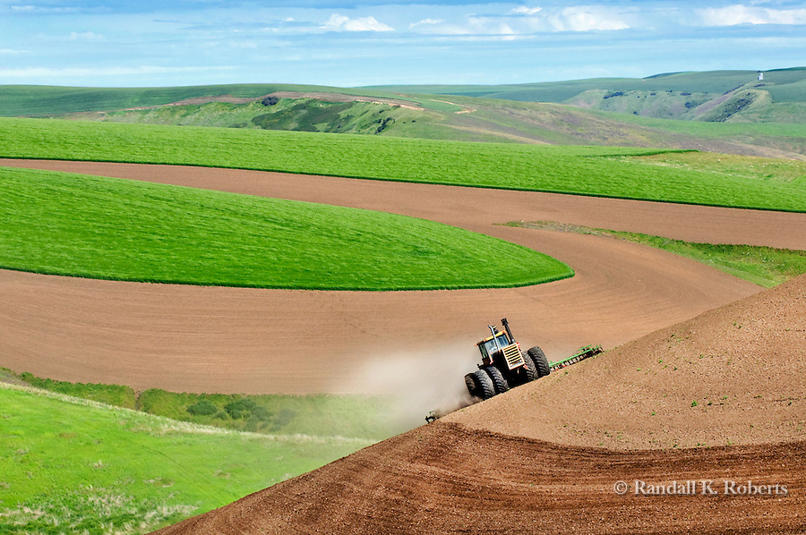

The guys mowing the medians and sides of the highways is Vermont amaze me.
Vermont isn't called The Green Mountain state for no reason. Some of the slopes have got to be 20°, at least.
The tractors are large, cabbed utility machines...mostly red, so I'd guess they're Massey's. Some have dual wheels on the rear, some don't.
They all run across the slopes towing a good-sized rotary cutter (I'd estimate 10 footers ± a foot in width)
The ones I've seen have large counterweights on one side, I'd say they mow in one direction to keep that side uphill.

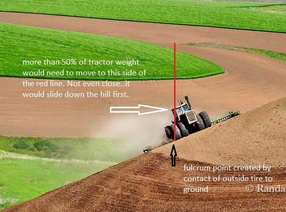

Gravity, it is always the gravity that tips them over ;)
When the center of gravity is directly above a point outside the footprint of the rear tires, left or right, it has already upset. Until then it has not. Anything else is a needlessly long story.

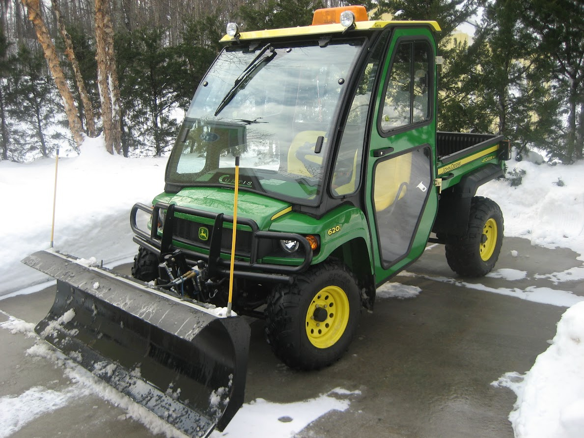

This thread reminds me of the time I decided to take my old Gator up the steep hill on my land to make use of the some of the many dead ash trees which I figured, were either going to become firewood or just rot. On the way up, it was very scary - it felt like I was close to rolling the machine over, front to back. I'm guessing the weight of the plow out front helped.
The bad part, though, was coming back down. I knew it wasn't going to be fun, but the land is very heavily wooded and there's no other way out. So if I didn't want to abandon my Gator up there, it **had** to come back down that hill. Unfortunately, the thin layer of a few tree roots and weeds on top of our pure sand soil immediately broke loose and the Gator was basically skiing downhill with the wheels not turning. Smacked my head into the windshield pretty good when I hit the bottom of the slope and slammed the plow blade into the ground, coming to an immediate stop. I got out and shook like a leaf for a few minutes and vowed never to do THAT again!
The bad part, though, was coming back down. I knew it wasn't going to be fun, but the land is very heavily wooded and there's no other way out. So if I didn't want to abandon my Gator up there, it **had** to come back down that hill. Unfortunately, the thin layer of a few tree roots and weeds on top of our pure sand soil immediately broke loose and the Gator was basically skiing downhill with the tires not turning. Smacked my head into the windshield pretty good when I hit the bottom of the slope and slammed the plow blade into the ground, coming to an immediate stop. I got out and shook like a leaf for a few minutes and vowed never to do THAT again!View attachment 732228

I didn't read all the posts but the answer is weight shifting past the CG or center of gravity.
Once you cross that, no matter what or who we are talking about, it is tipping over.
