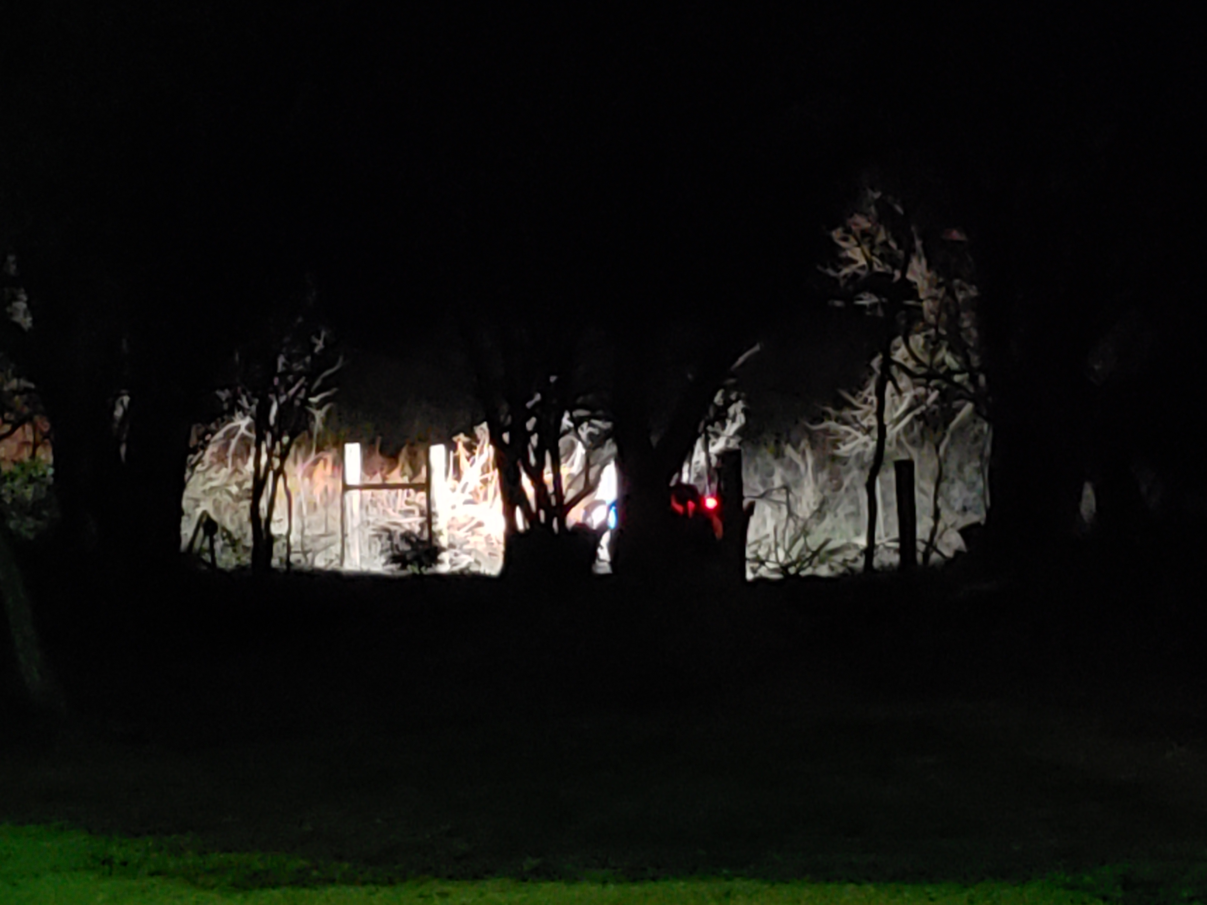

Decided to take out a stump I left from the other day. Took this pic from about 75-yds. away with my cell phone. The green at the bottom is a backdoor light casting on the grass.
Those lights are awesome.
