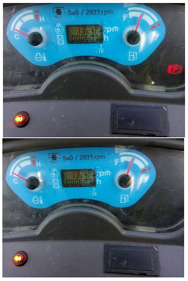

There is a thread on another brand where the OP got zinged by the manufacturer over a brake issue. Pedal wouldn't come all the way up and the dealer didn't think it was a big issue. Wore the wet brakes out and cost a bunch. No one knows why the pedal wouldn't come up or if it was the cause or not. But the discussion turned to brake indicators which may or may not have told him if the brakes were applied. The brake lights on our dashes are only for the parking brake, not normal brake use. I changed that on mine this morning. Added a $1.00 LED and a grommet I already had into a hole already in the dash. Just had to remove the existing blank plug. No idea what the hole was originally intended for. Ran wire to the trailer connector near the rear PTO shaft to get the brake light power;
Now I have a brake indicator that's on whenever the brake pedal is depressed (whether the operator is or not).

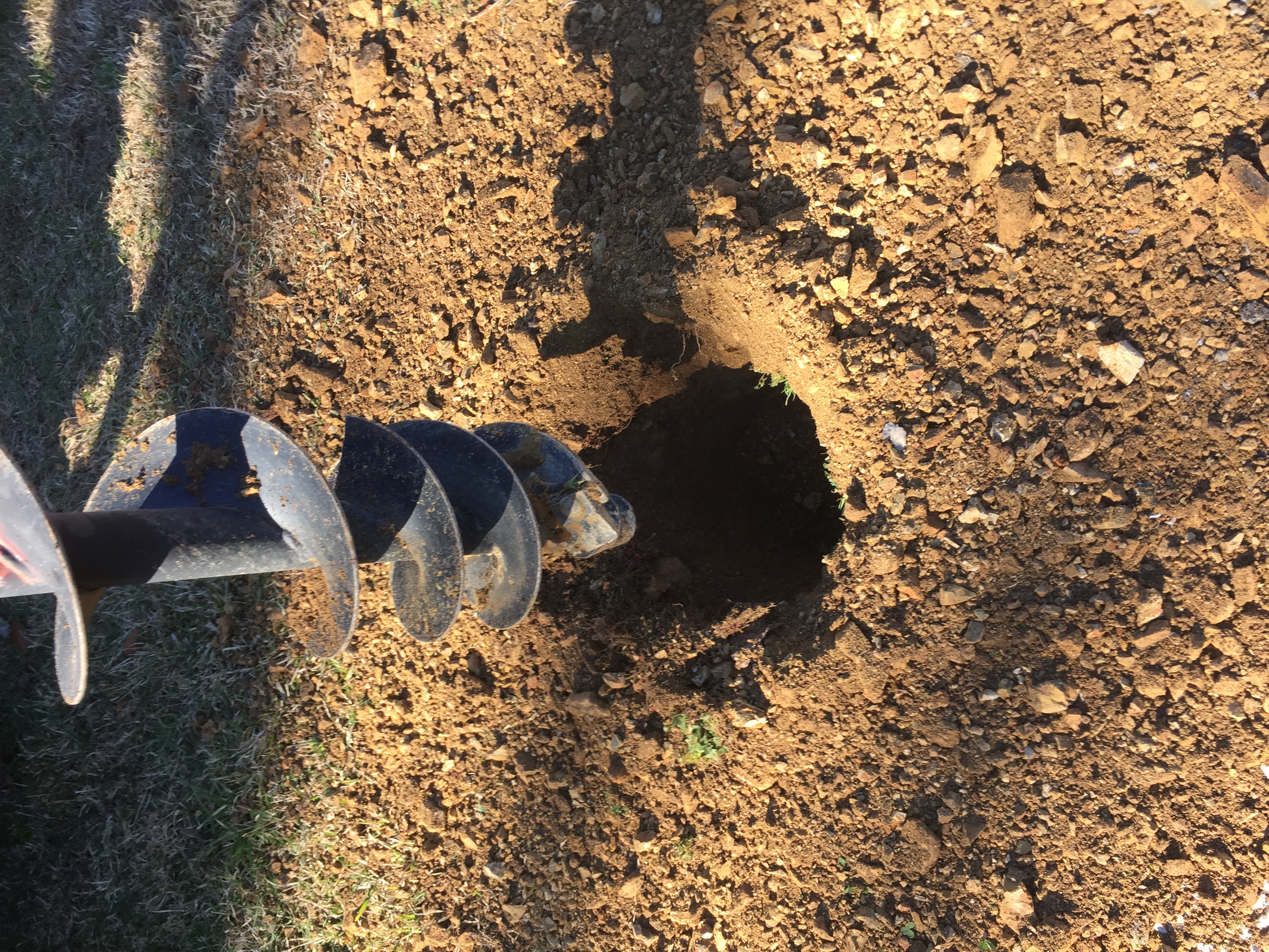

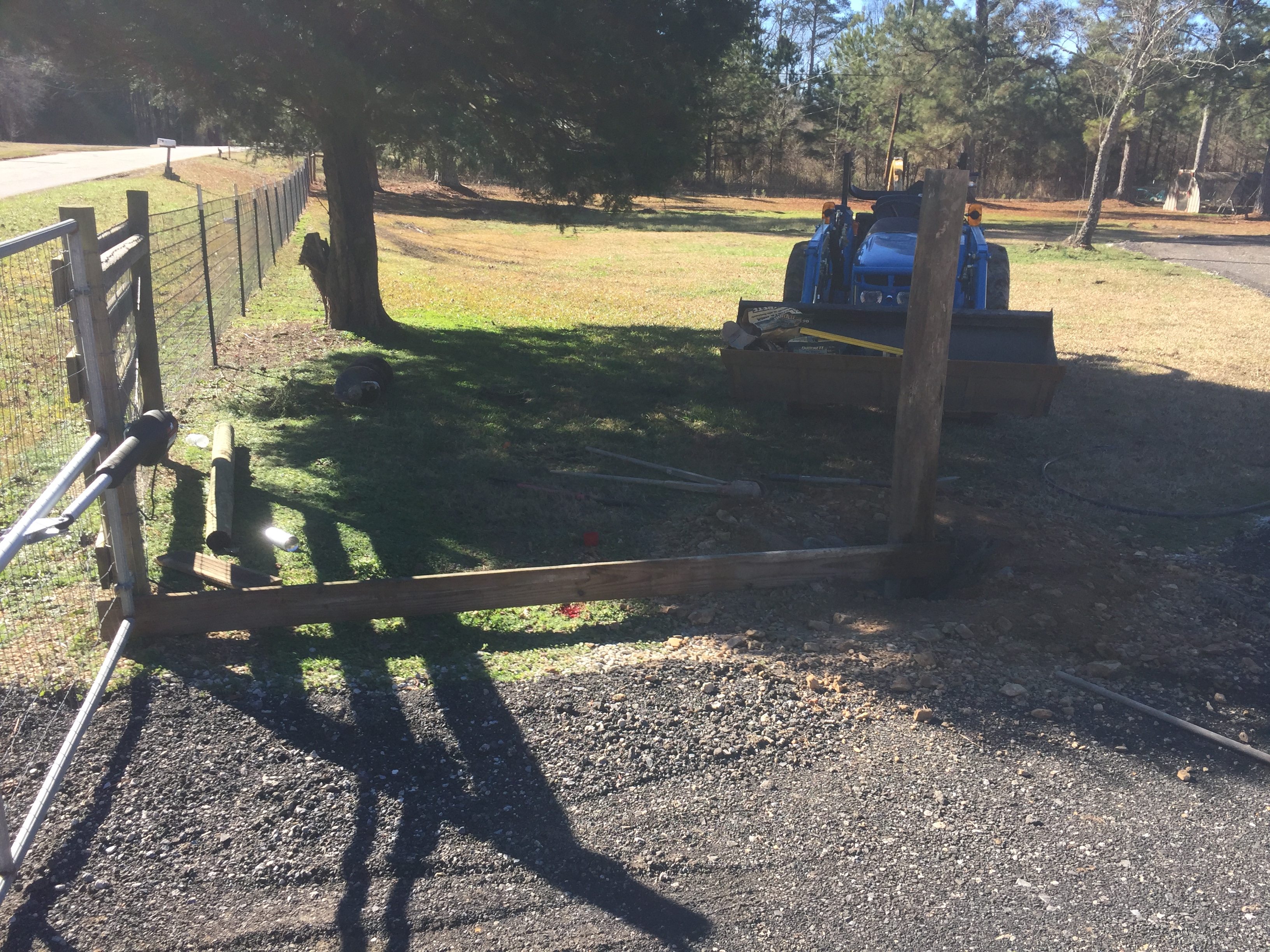

couple years ago we put a fence around the yard. I put a gate in back to be able to get in and out on the road behind us. Last year we had the first few loads of gravel delivered and stretched the driveway the rest of the way, I've posted pics recently of more gravel out there. The issue is that I didn't offset that rear gate, and since we come in that way most of the time, waiting for the gate to open leaves us sticking out in the road. So it's time to offset that gate! Hooked up the PHD and started setting the new posts. Even as great as this is, it doesn't want to dig through slate! I thought I'd get past it, but trying to dig a 4 ft hole, it was slate the entire depth....had to really watch it to get it out before it got stuck....ask me how I learned that ;)
anyway, it took a couple of hours to actually get the hole done and the first post set, today I don't have to worry about getting grand kids from school so I should be able to set the other gate post and the extra 2 smaller ones as well. the first pic was when i got off to check it, still had another 1 1/2 feet to go! it wound up pulling chunks out of there the size of baseballs......wasn't a fun hole to dig at all.
you can see in that second pic even the other gate post was 'off' several inches of being in line with the fence, it just wasn't going to be put in the right spot, and that was digging with the 36 hp Ford tractor I had before the LS

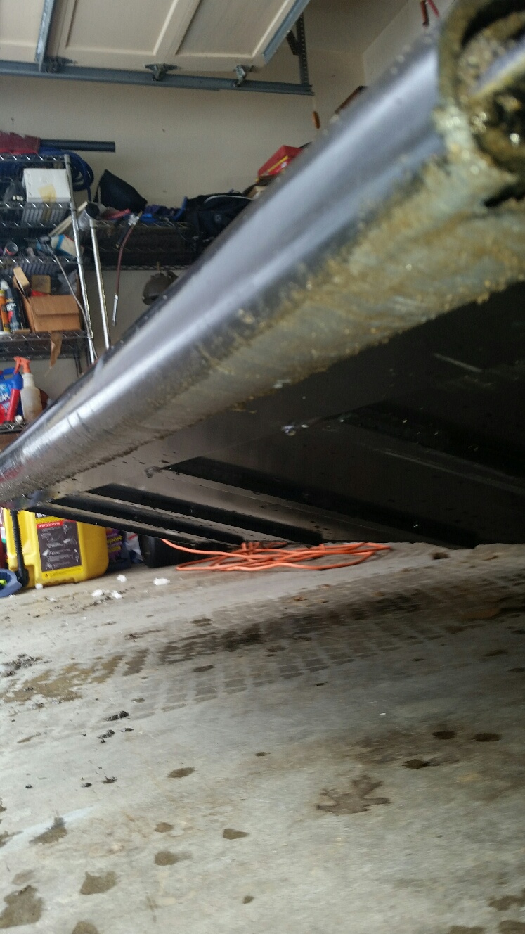

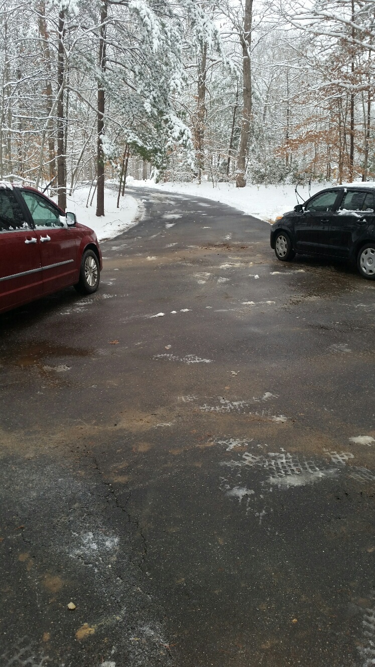

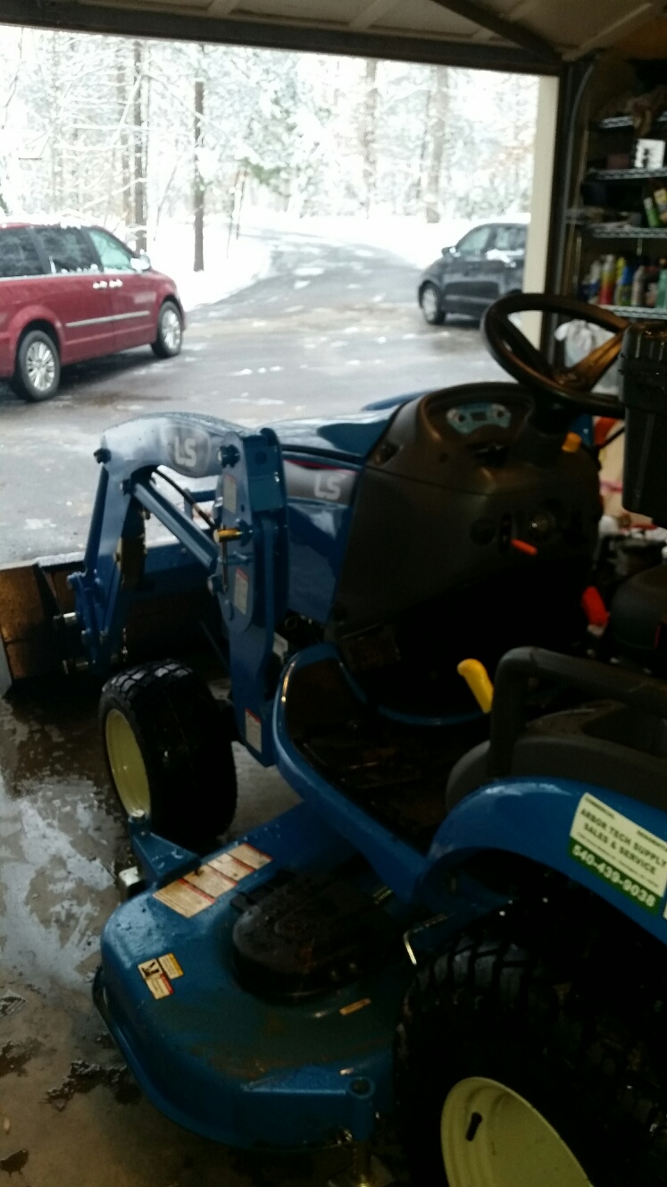

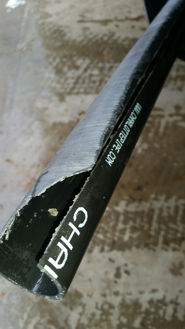

Hi all, I just got my LS MT125 last Wednesday and had 6-8" of snow today! After reading several posts about pushing snow with the bucket I picked up a 5' piece of 1 1/2" ABS pipe at Lowe's for $8, cut it to fit inside the bucket and cut a slit lengthwise on my table saw and then pounded it on the edge of the bucket. This really worked well, kept me from scuffing up my asphalt driveway which is in pretty bad shape anyway. Worked best on float with the angle just slightly down. Here's some pics. The ABS did get scrapped and chipped so I just flipped it over, should be good for the next snowfall.

very nicely done!
